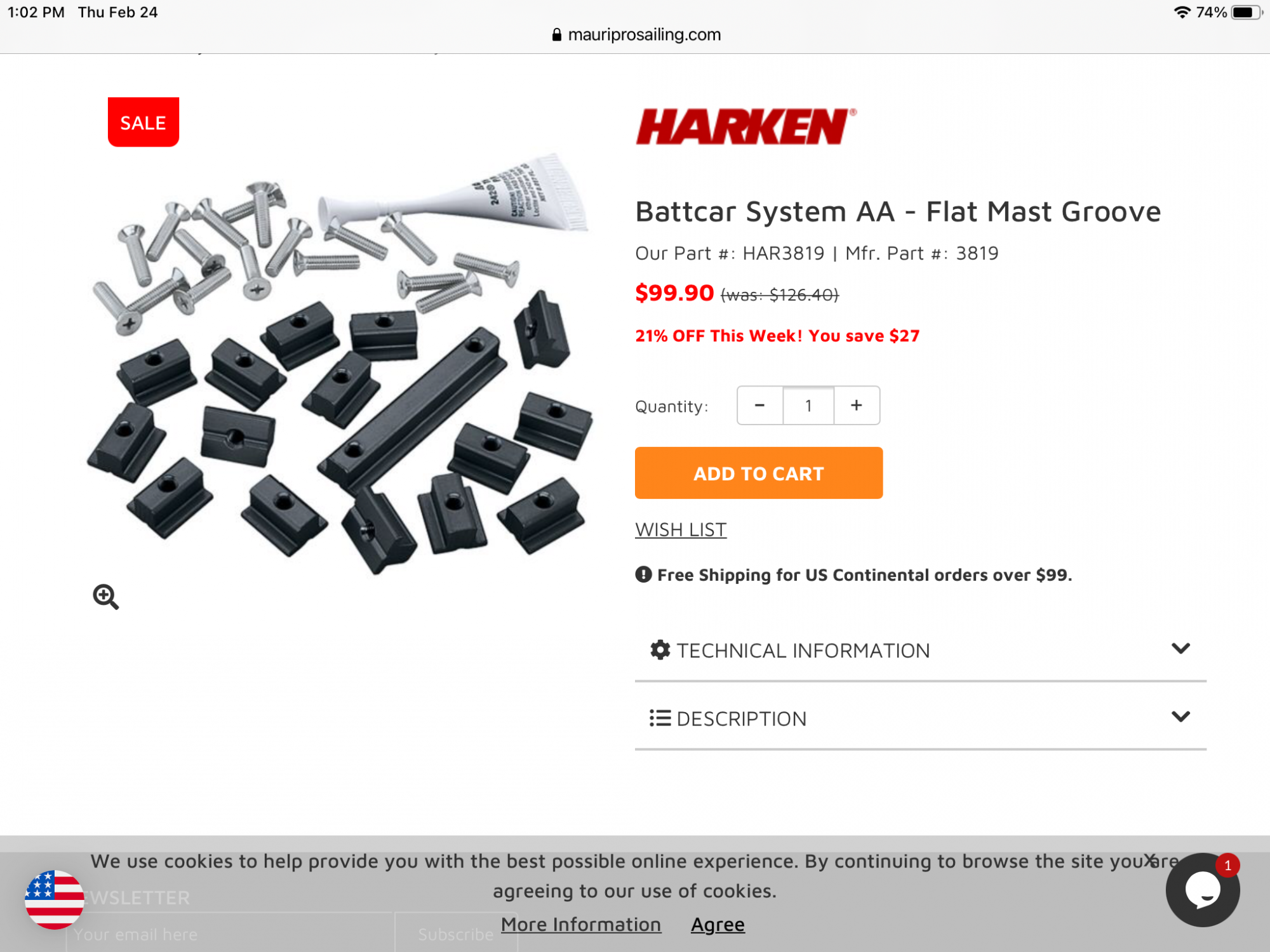

I assume you are familiar with the various options to slugs which are often problematic. One example is:
Even better, cars with bearings make raising/lowering any sail a ‘breeze’. Pun intended.

It is common for a different system at the battens when a sail has full battens. Helps to reduce the friction that full battens can cause when they push against the mast.
I plan on using these slugs as they are designed differently for less friction, when I buy my next sail. Allslip

I have a Harken Batt Car system on my boat and haven't seen a sail slug since I sold my Catalina 25 in 1998! :)
