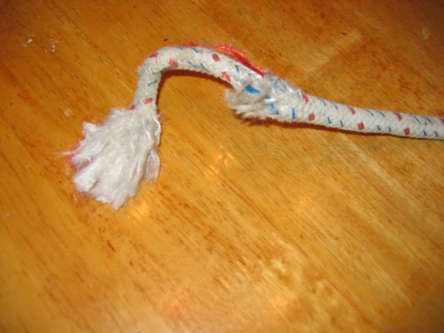

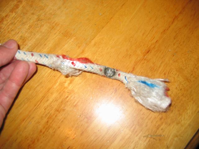

On our same year H340, I've replaced the main halyard, jib sheets, and jib furling line, and shortly the jib halyard. The reason for the first three were normal wear and stiffness, but the jib halyard basically exploded at the eye splice in some 18-22 kt breezes a week ago. On a "new to you" boat, it's probably worth examining the entire length of each line for its condition.
