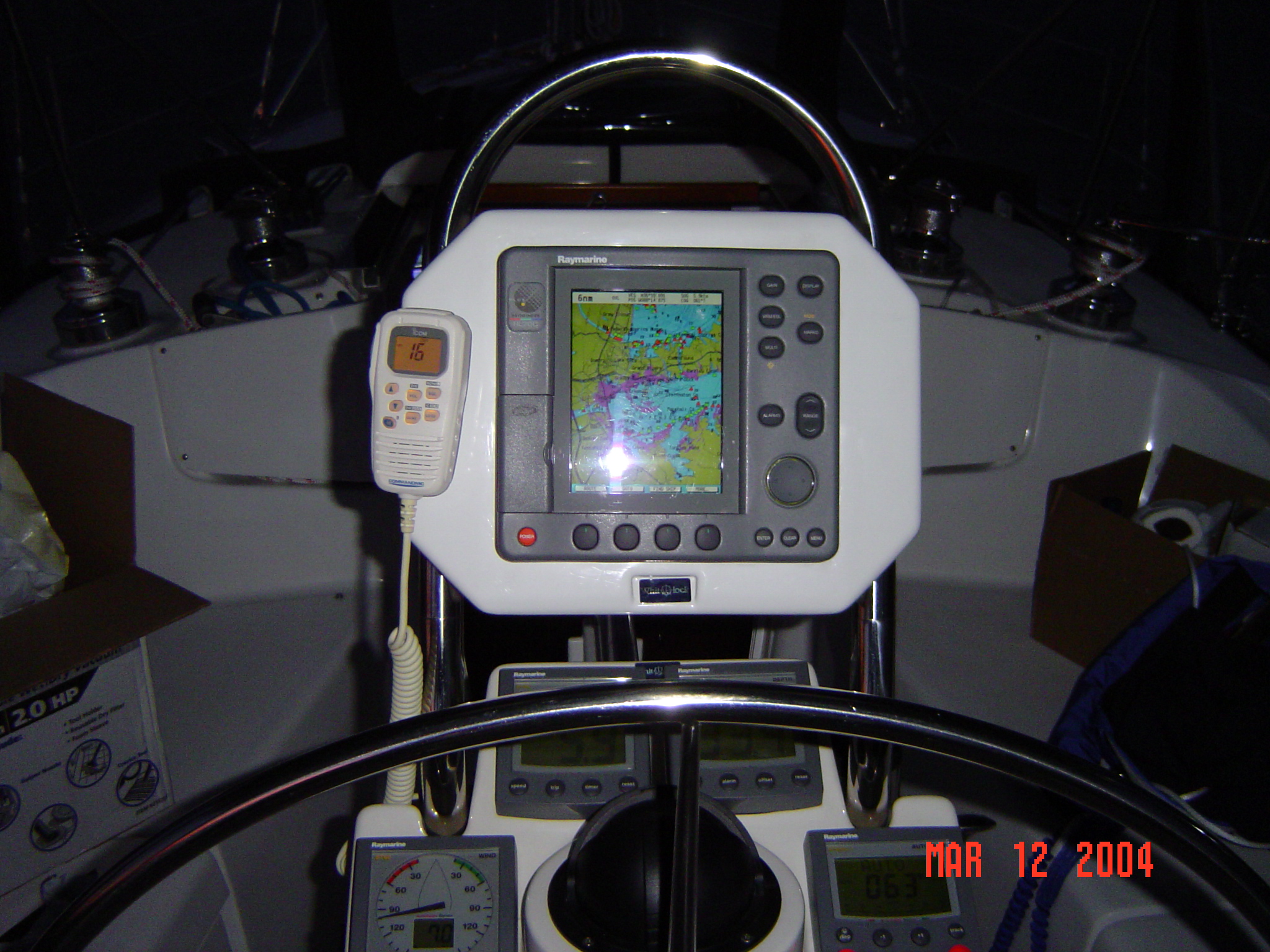

Nick: My depth and speed are at the helm next to my chartplotter
, so the wires shoul feed just like you say. I may go to the boat today and take a look. I move it to Tennessee next weekend and it will be 15minutes from home in a week and I plan on fixing this this winter.
See photo -depth/speed is top left hidden by the wheel. Do you remember what breaker your sensor was connected to?
