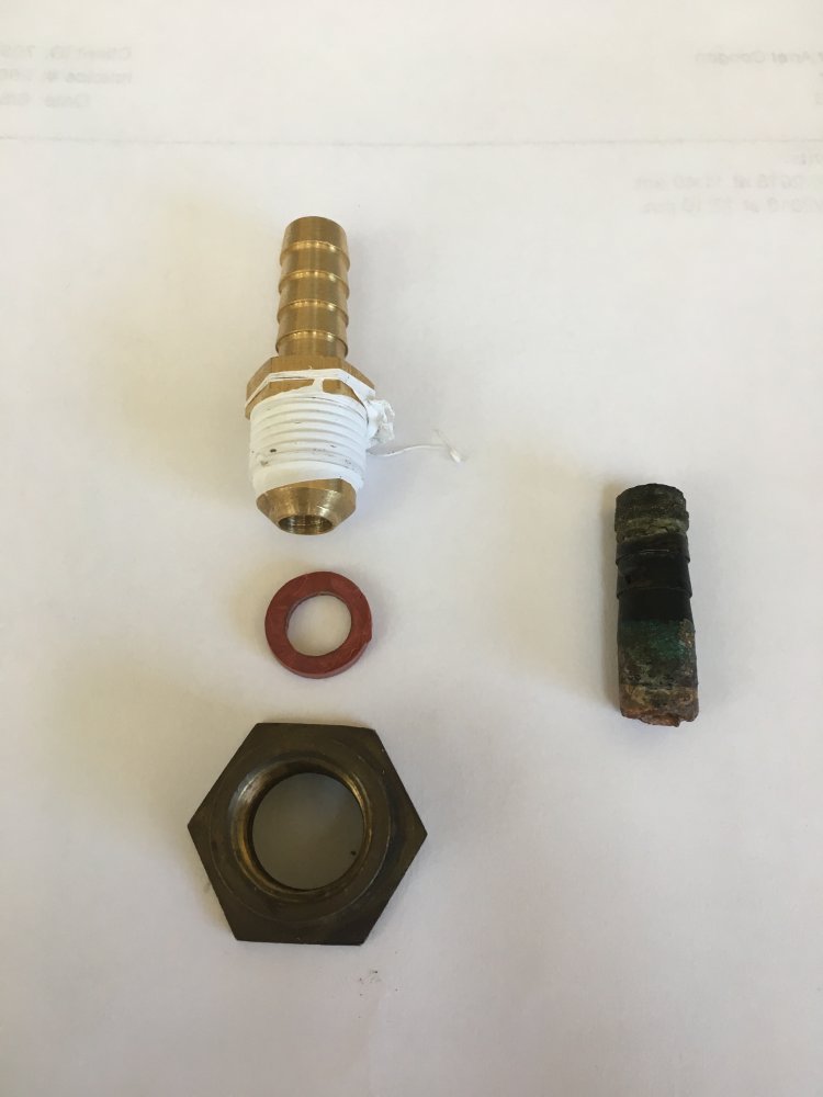

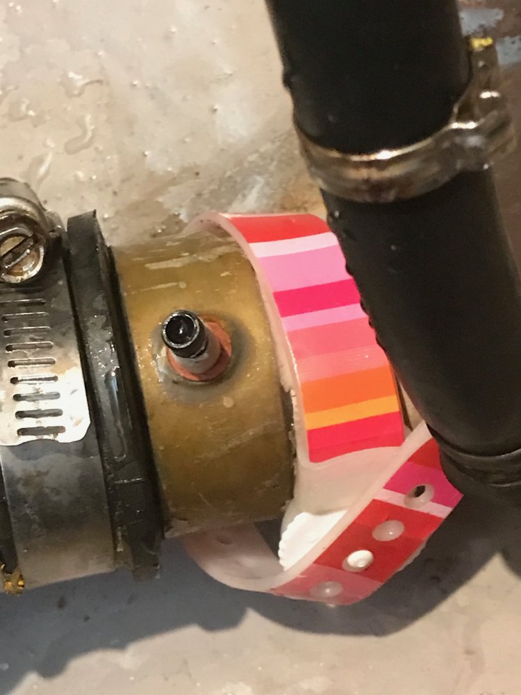

Like a lot of you, my propeller shaft hose barb broke off, leading to a small hole in the bottom of my boat which is mercifully plugged. However replacing the hose barb looks tricky while the boat is in the water but since I can't pull the boat for at least a month I thought I might give it a try. I've been researching how to repair when I saw several suggestions of using fiberglass to build up the area around the shaft and putting in a new hose barb. One suggestion was to glass a nut in place so that the hose barb becomes a user serviceable part. Being a hands on kind of guy I like this idea.
My approach is to keep the broken brass that is through the fitting now, glass a nut on top of it, then screw a new hose barb in place with a rubber washer to seal between it and the existing bronze hole. This should allow the same water volume to the bearings and should be strong as the nut will be glassed in, and has the added benefit of being completely removable should it not hold water well. I would be no worse off, and I would just get the boat pulled.
So my question is what advice would you have in doing this? I know to avoid brass so I am using a stainless hose barb. I will be taking care to really glass the nut in well, and will likely use locktite to make sure the barb is in the nut as solidly as I can make it. Other than minding for leaks is there any reason to believe this won't work?
