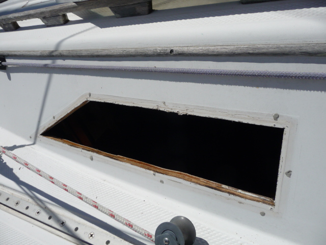

I am replacing the four portlights, and had new plexiglass windows cut from the originals. Am using 3M VHB tape and Dow 795. But found the new windows, cut exactly to old windows were too big to seat flat on all four sides against the 3M tape - so no seal. Thought trimming them 1/8" all around would do - didn't. So am going to measure dimensions of FLAT window frame, where tape will make contact.
Guess it's obvious in hindsight that I should have measured first, although someone said to just bring in old windows. Anyone else have this experience? Or everyone knew to just measure each frame exactly for the VHB mounting ;) ??
Am hoping that using the Dow to caulk between the window edge and up to the slanted edge of the window frame will seal well?
PS have a lot of holes (40) - all the way through to cabin, that I'll have to clean and drill bevels into, to seal with Duraglas before taping and mounting. Lots of interior work to follow up with.

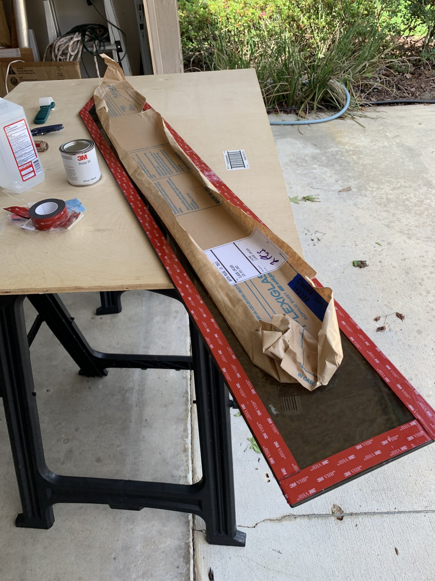

also I found that the windows did need some pressure applied for the VHB to seal well. I cut some wood strips to size and wedged them in between the windows and the stanchions to apply pressure on the plexi against the VHB

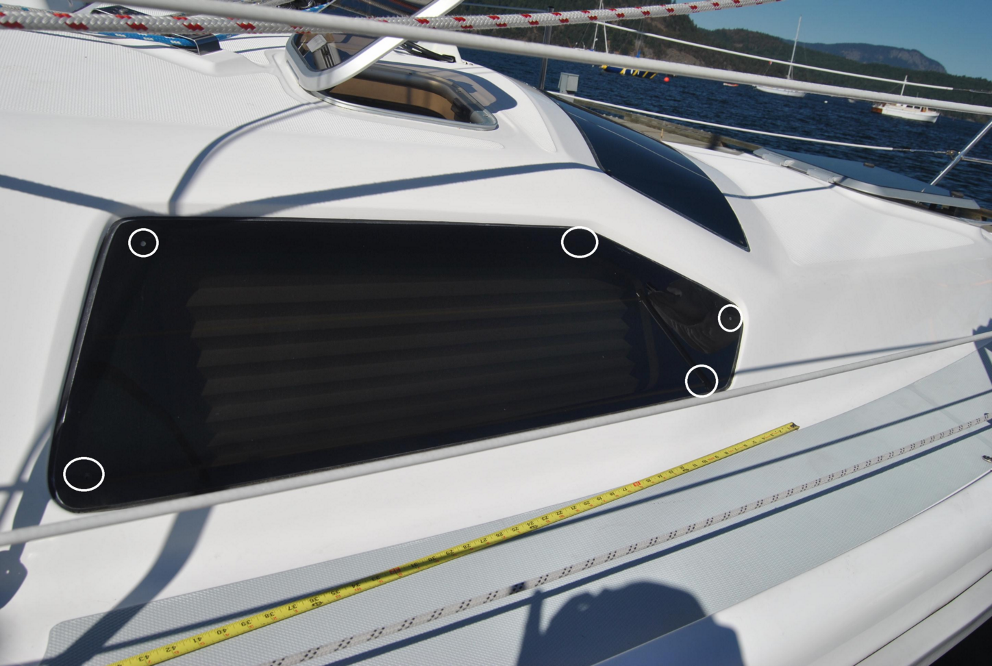

Have to disagree with you just a tiny bit here. Temporary screws are just NOT a big deal when installing frameless glass. They are near invisible. My new 1999 H-310 came from the factory with lots of screw holes in the glass and you have to press your nose up against the glass to see them as they are filled with black 795.
See how many holes YOU can find and win a kewpie doll.
