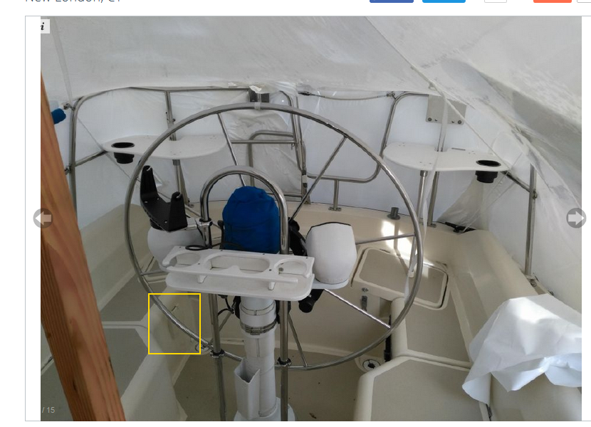

I don't know about the 28's but I should think you have a manual bilge pump standard as well, it should be in the cockpit with a handle around somewhere to operate it. You can also look in the bilge to see if there are two hoses. Mine has a white cover - here's the best picture I have of it (it's in the yellow rectangle):

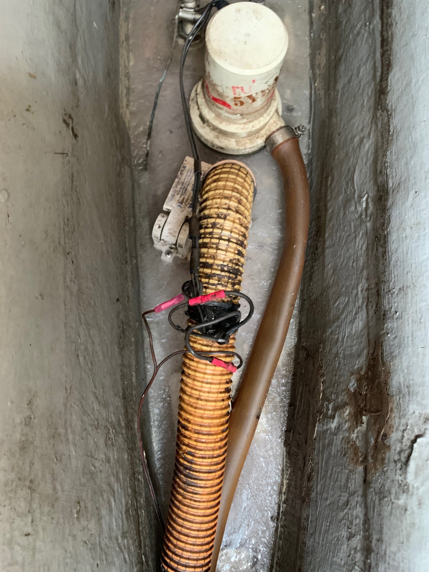

Thank you very much, my first of many projects, I did find out the light at the top of the mast is burned out as well. Not ready to run and fix that yet though. This is my bilge area, not sure what the smaller diameter hose is for? the yellow hose is cracked just outside the picture

Ha…I was trying to figure out when O’Day used yellow bilge hose….now I see. That started out as white hose oh so many years ago!

The larger hose (yellow) is the manual pump hose, the white cylinder that says Rule is the electric bilge pump with a non-standard hose (it should be reinforced so it doesn't collapse, though it will be under positive pressure). Good that you plan on replacing them :thumbup:. The bilge is in good shape for an "abandoned" boat.
