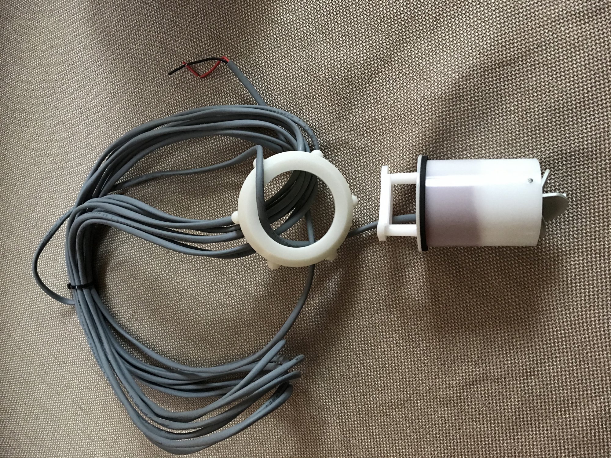

Hey there @Jerdavis77, welcome to the forum. I feel your pain. I’ve replaced the knot meter transducer twice since purchasing my ’78 Hunter 30 in 2014. Replacement paddle wheels were not available. The travel lift strap, when seasonally launching or retrieving boat, slides right over the paddle wheel and has crushed magnets and vanes...:yikes: Can you tell me what the inner diameter of your through hull is? I may have a complete transducer with cable that might work for you...but maybe knot? I will give it you for the cost of shipping. It’s brand new, old stock. Never seen the light of day or water.
The OD of the transducer is slightly tapered from insert end at 1.72“ to 1.81” at the seating end. It came with through hull seal and nut. I think esgdirect.com is where I got it from and of course they no longer carry these items. The filler/sealant for these transducers was color coded. This one is red, of course my limited knowledge of such things was Wayneing at that point in tIme, I needed blue. Slightly larger in diameter. Here’s a pic.
