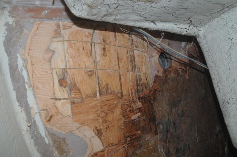

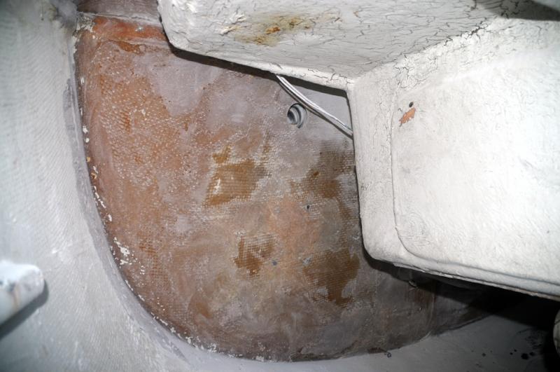

This is the start of grinding, and halfway through. I've got about 10 hours into it so far, and probably have another 5 to go.

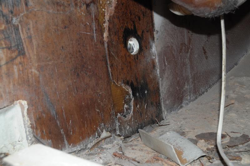

The plate is a piece of 30x30" 1/2" plywood poly'd down to the hull, then sealed with poly. The thru-hull hole edges were not sealed after install, so any water that got in the gudgeon / battery cable holes went right into the wood.

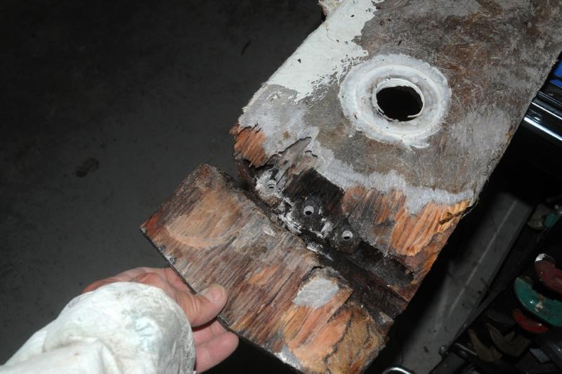

The top half of the motor plate is solid, but the bottom is not, as is the whole king plank. The latter popped right off after I cut the tabbing with a right angle grinder. Wet all the way up.
