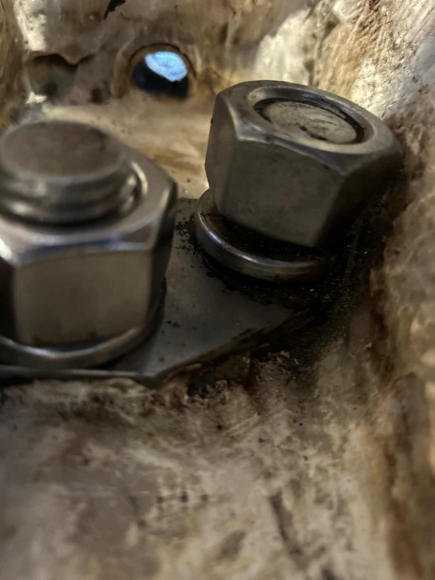

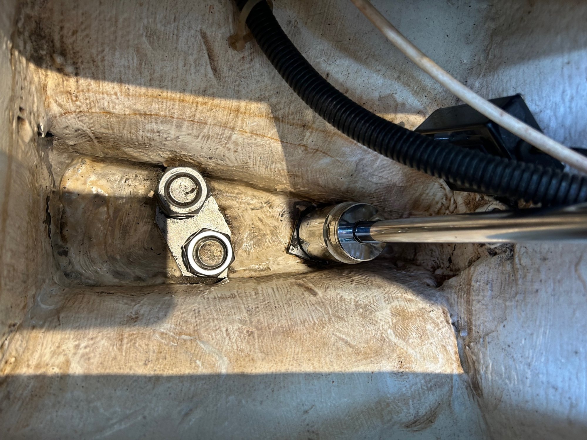

My Catalina has 1" studs and the torque is specified to be 235 ft-lb. There are 9 of them. My bilge was left pretty ugly by the PO 5 years ago and other than scrubbing it the best I could and re-setting the float switch for the bilge pump, I have pretty much ignored the bilge as long as it didn't have any obvious problems. I finally decided to remove & replace the nuts so I could clean up the steel backing plates. I had hoped to actually remove the plates and get them polished or replaced. But they appeared to be epoxied into place so the job looked way to daunting and I didn't have a good reason to disturb them. So, I polished them with a dremel brush the best I could. I bought new 316 ss nuts and lock washers and decided to replace the old even though the old looked pretty much ok. The old lock washers had significant corrosion-like stains, but didn't appear to have any loss of metal. The plates were slightly pitted in spots, though. This is a 25-year old Catalina by now.

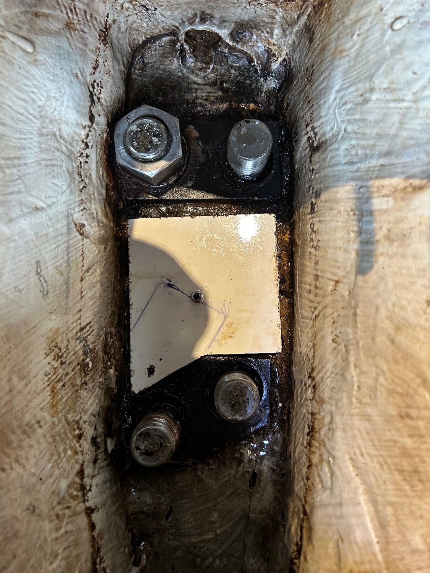

I found 2 nuts of the 9 that I can't get off with a socket, though. They are too close to the sidewalls of the bilge and the socket can't get a grip. In fact, one of them was not even tightened down securely. there is about a quarter-inch gap between the loose lock washer and the bottom of the nut! So much for quality control!

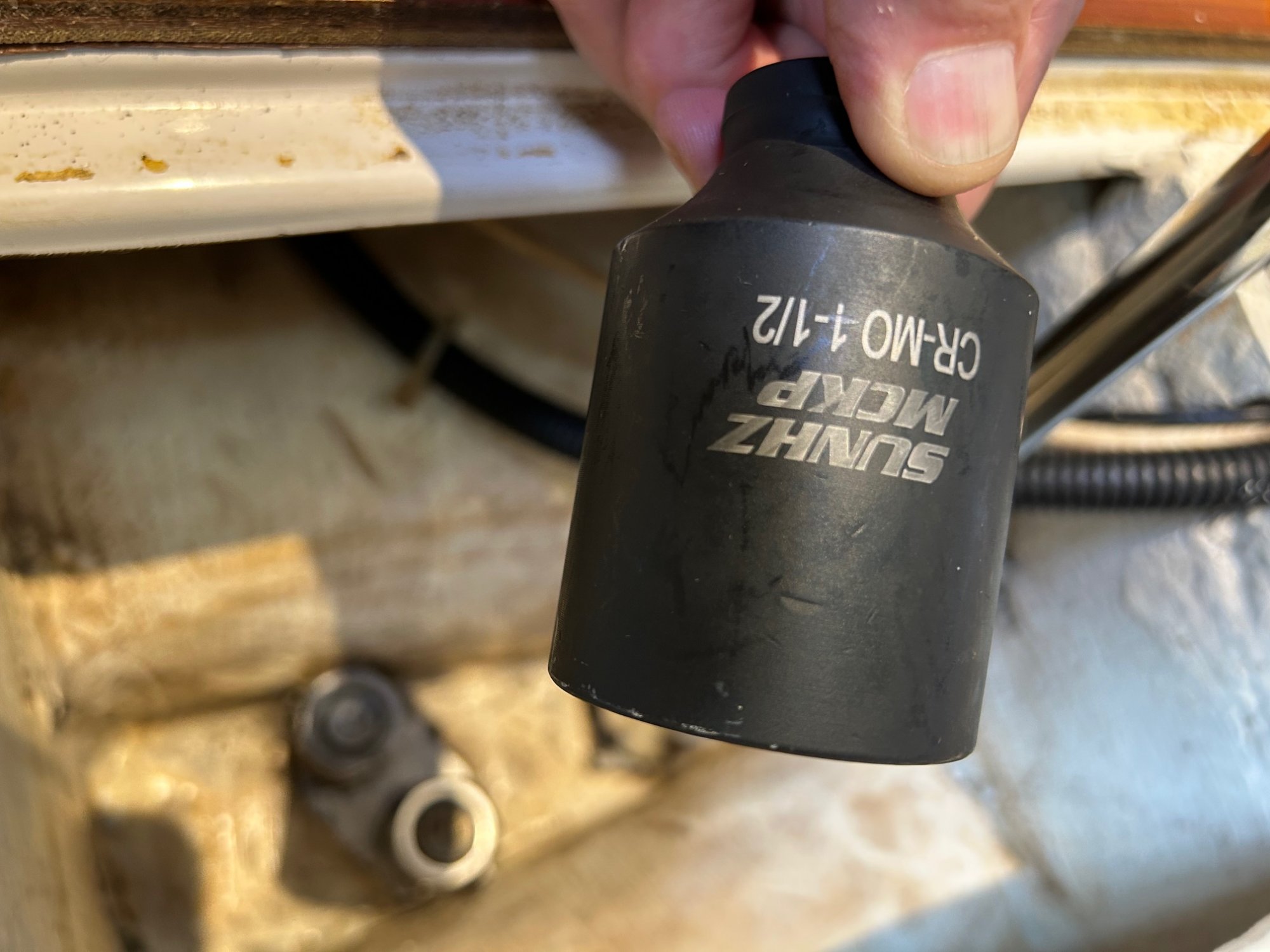

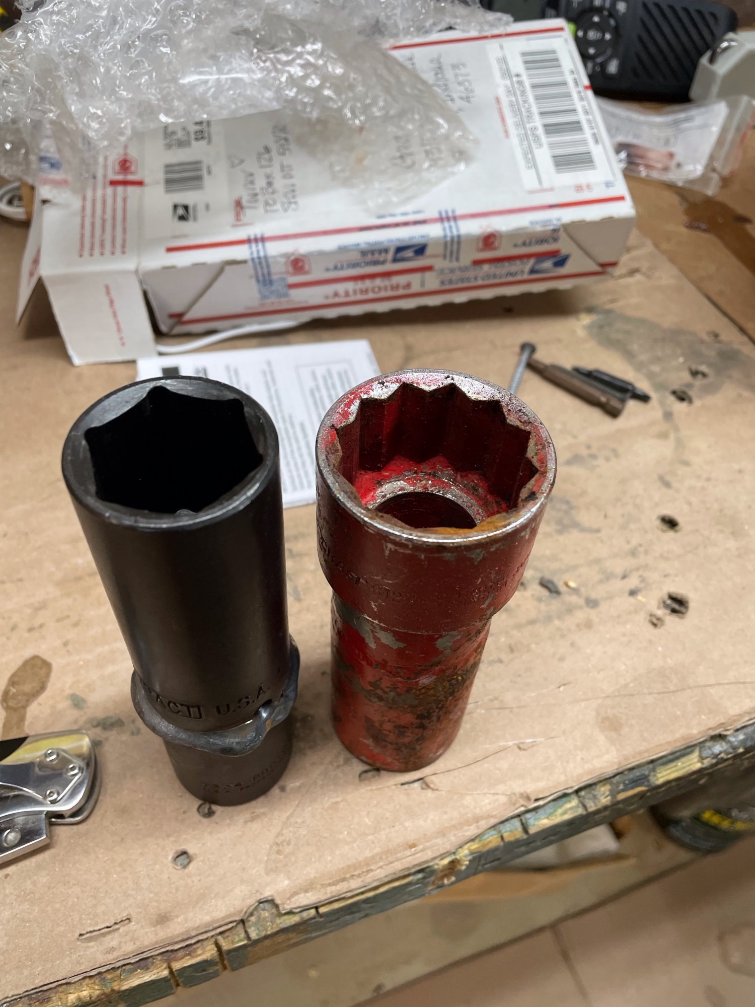

I torqued 4 nuts yesterday. I lubed the studs and the nuts and each nut turned freely when started. I torqued each on gradually up to 175 ft-lb. I have 2 - 1.5 inch sockets. One is just a mild steel socket (silver chrome finish) and the other is a bit beefier, with a black finish. The fit was too tight for the black socket at 2 bolt locations. I could only approach 235 ft-lb by doing a leg press. The 2 nuts in the aft section of the keel were able to be torqued to 235 with the black socket. I could not torque the 2 in the forward section of the keel to 235. The wrench could be pressed forward a significant distance without clicking and it would spring back when the force was released. It seems that the silver socket may be factor. It was also clear that the extension bar was able to twist quite a bit in torque. I was worried about the breaking point.
In any case, I can get at just 3 of the 4 bolts in the center section. I need another few dremel wire brushes to clean up the plates & bilge so I'll tackle that on another day.

That's a lot of keel bolt - my O'Day 35 had 7 that were 3/4" for a 4600 lb. keel. The most forward one was difficult to reach but putting them against the fiberglass like yours was not very nice. Maybe you could find a thin-walled socket and maybe dremmel a little glass away but may not be worth it. Does Catalina reccomend 235 ft. lbs.? I set mine to 110 which is around what Catalina reccomends for their 34 & 36. Even 110 is hard to get to in tight quaters.

First of all, congratulations on doing this, it is inspirational and on the backlog of maintenance tasks for my boat.
For sure, some kind of poor design or practice with the manufacturing process that those bolts are so close to the side of the bilge. Not to mention that one being left loose in the first place.
Unfortunately I have no idea what the best options might be. I guess if those two bolts have been that way for 25 years, leaving them as-is might be the appropriate solution, certainly the easiest? Grinding the fiberglass back brings on its own perils. Both possibly causing structural weakness, and also being extremely diligent about getting it totally sealed and waterproofed?

If you know what a crews foot wrench is, looks like you could get one of those in to tighten those nuts.
dj
Yeah, that is the name of the tool (crows foot), I could picture it but couldn't remember the name.
dLj
Mar 23, 2017
4,520
Another option might be a deep-offset box wrench. But I'm not sure you have the clearance on those nuts...

Would be nice to have one of these but expensive for a single use! I think I'm just going to get at it with a pipe wrench and simply snug it down if i can. Or perhaps I can build up the plate surface with washers if the sidewall keeps it from going any lower. I think it's perfectly safe if I can just get some tension on it.

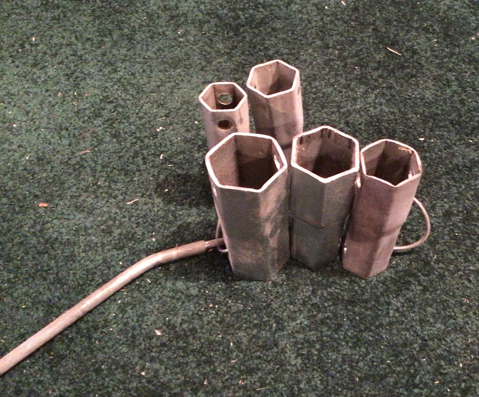

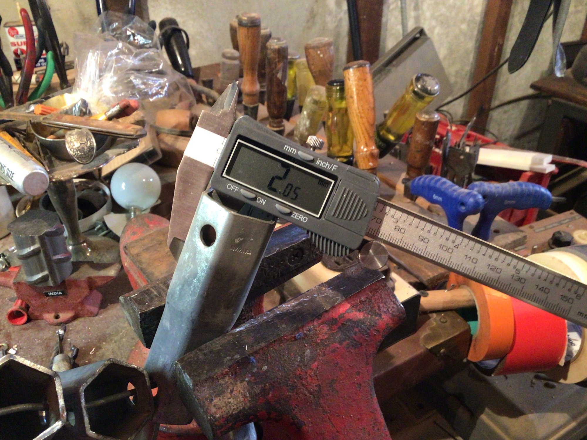

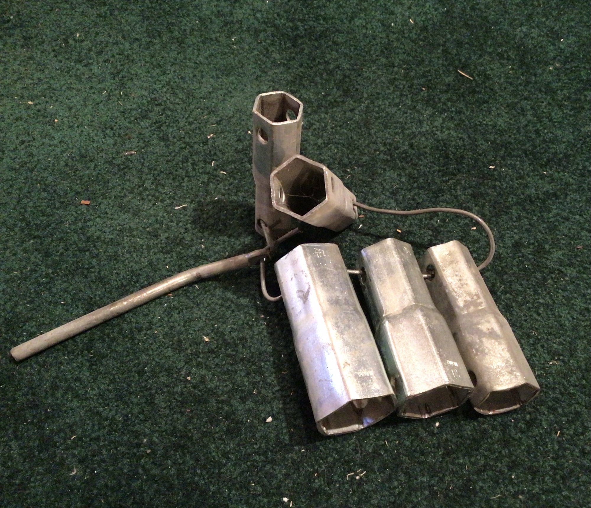

Do you think you could use a set of this type of deep thin walled sockets? I know you can’t get a ratchet on them and torque them down to spec, but you may be able to fit one between the nut and wall and at least sock into place.
Just a thought and a possible way out.

I agree with Smokey73 and using your feet. Be cautious with that.
Please excuse my work bench, I got some projects going on.
I think those thin-wall ones will distort under the 235 foot pounds he is trying to achieve. But maybe he can get the few he can’t tighten all the way at least “ snugged down”.

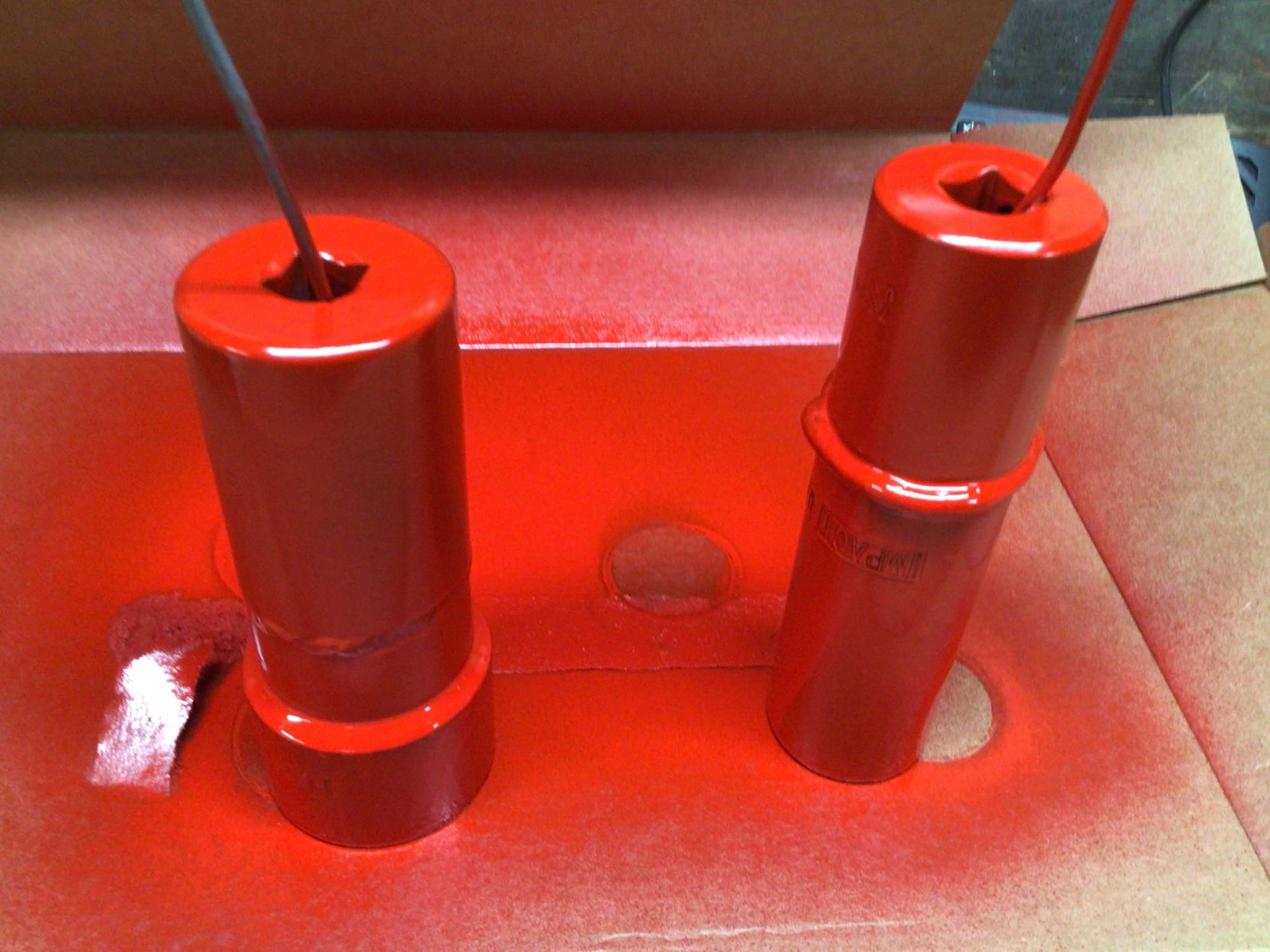

On my O’Day 322, that only has 3) 1” and 1) 3/4” bolts, I use my socket, a 1/2” drive extension (not nearly as long as the OP’s), a torque wench and a cheater bar. I lean into the bar and see if I can get any movement of the nut. If not, I consider it tight and go sailing. My torque wrench doesn’t go to 235, so i am really giving it a good grunt with a little help from the extension. I had to have some special sockets made because they needed to be extra deep.

I actually don't think I would hesitate to get in there with a Dremel and shave the fiberglass back just enough to squeeze my socket on. It looks like very little material would need to be removed. In terms of structural integrity, in that location, only vertically-oriented fibers are contributing to strength. And, in that location, by the time you even get to those fibers, you will have gained about 0.5 - 1.0 mm - which alone might be enough. But, even another millimeter or two will not appreciably weaken the region, provided you just do it right at the nut.

Here is an option for you, 235 ftlbs is too much for half inch drive tools. 3/4" 1 1/2" sockets can be had for $10 to $12 on eBay. Grind the socket thinner across a third of the circumference, you'll only be able to turn it 30 to 45 degrees at a time perhaps but it 'll get you there. Get a 3/4" extension 10$ to 20$. Your extension in the picture looks too long but you know the length you need for all your bolts. Two extensions to make a longer one is an option as well. Lastly a 3/4 to 1/2 adapter for your torque wrench.
