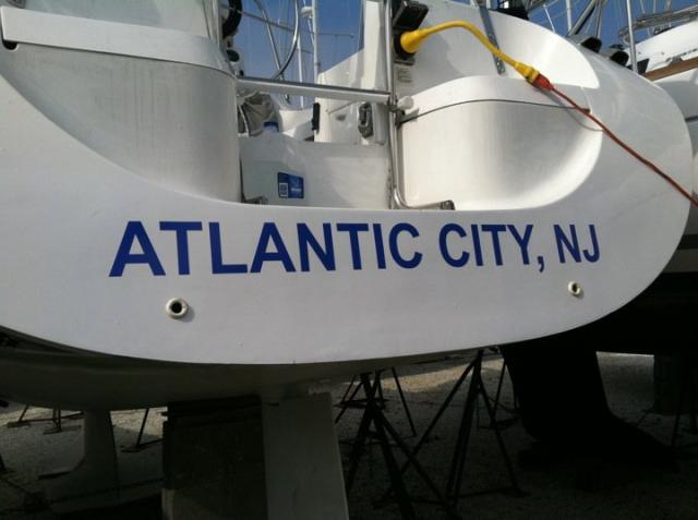

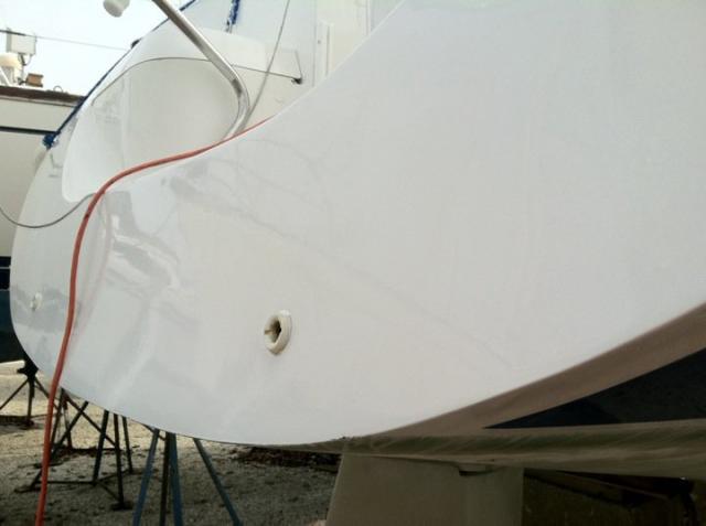

Used Sticker Off and found that it worked incredibly easy, fast and there was absolutely no ghosting left. WM has it for about $7.
Pic 1 is after using the Sticker Off and Pic 2 is after application of new graphics. Didn't think of taking the "before" one with the ghost lettering "Bowleys Quarters, MD"
