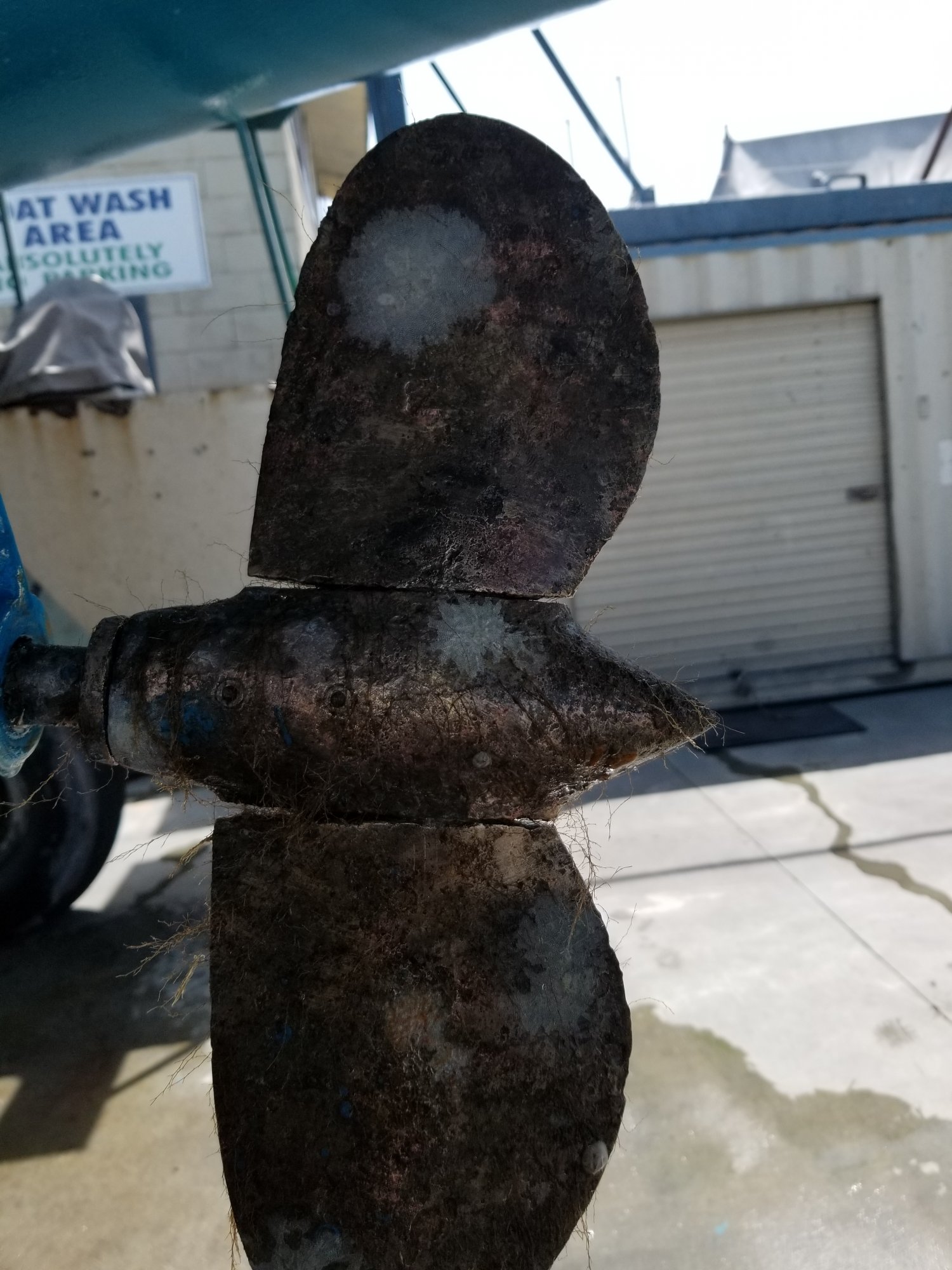

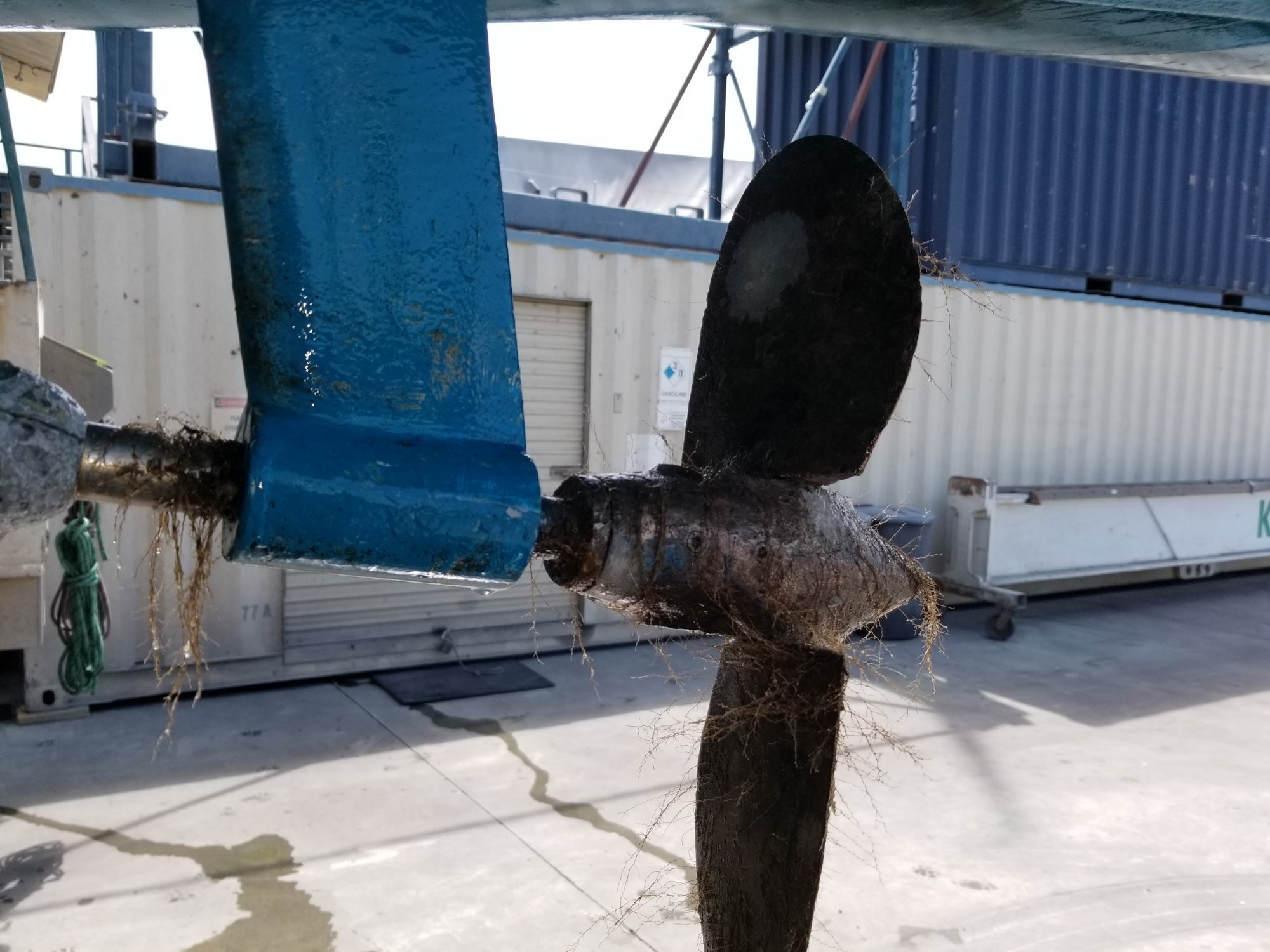

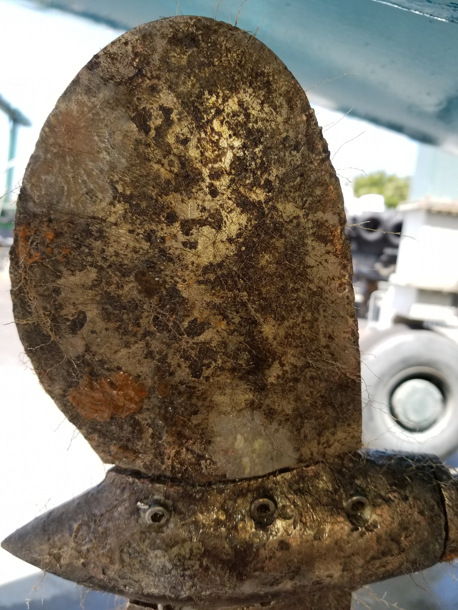

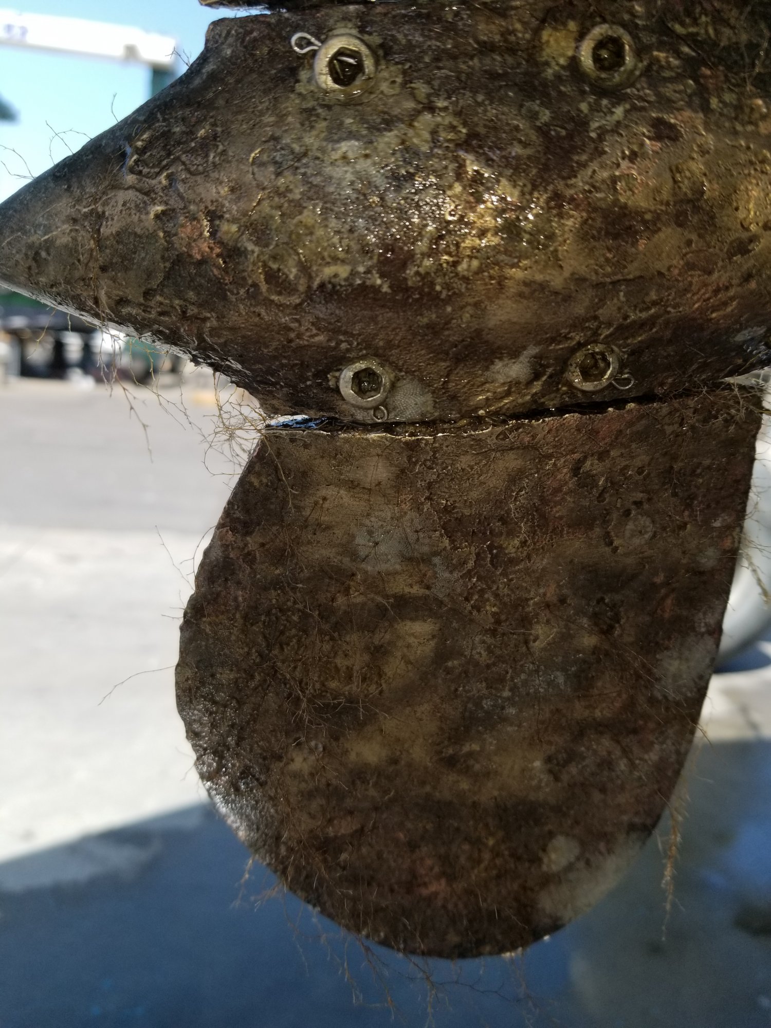

Has anyone replaced their Max Prop with a fixed prop? Our 1989 Beneteau First 35s5 has a Max Prop. We bought the boat in June of 2019. We hauled it out for the survey and I checked and photoed the prop. It functions properly, but it is really pitted. I don't know if it was original to the boat 31 years ago, or if was an upgrade. I'm not happy with the performance of this prop. Especially in reverse. It takes a lot of RPM to get it going in reverse and it has nor prop walk, (which I am used to and take advantage of). In close quarters, it is sketchy with this prop. I don't care about the extra speed that it provides. We're not racers. We sail in the SF Bay Area where the currents are strong and I like the extra power when I need it.

1- Is it likely that the end of the shaft was cut down to accept this prop? I saw installation videos for new Max Props AND THEY CUT THE END OF THE SHAFT OFF!

I have a Max Prop and I'm pretty happy with it. Before going further on the decision to replace it, take a scotchbrite pad and clean it up. It is difficult to see its condition.

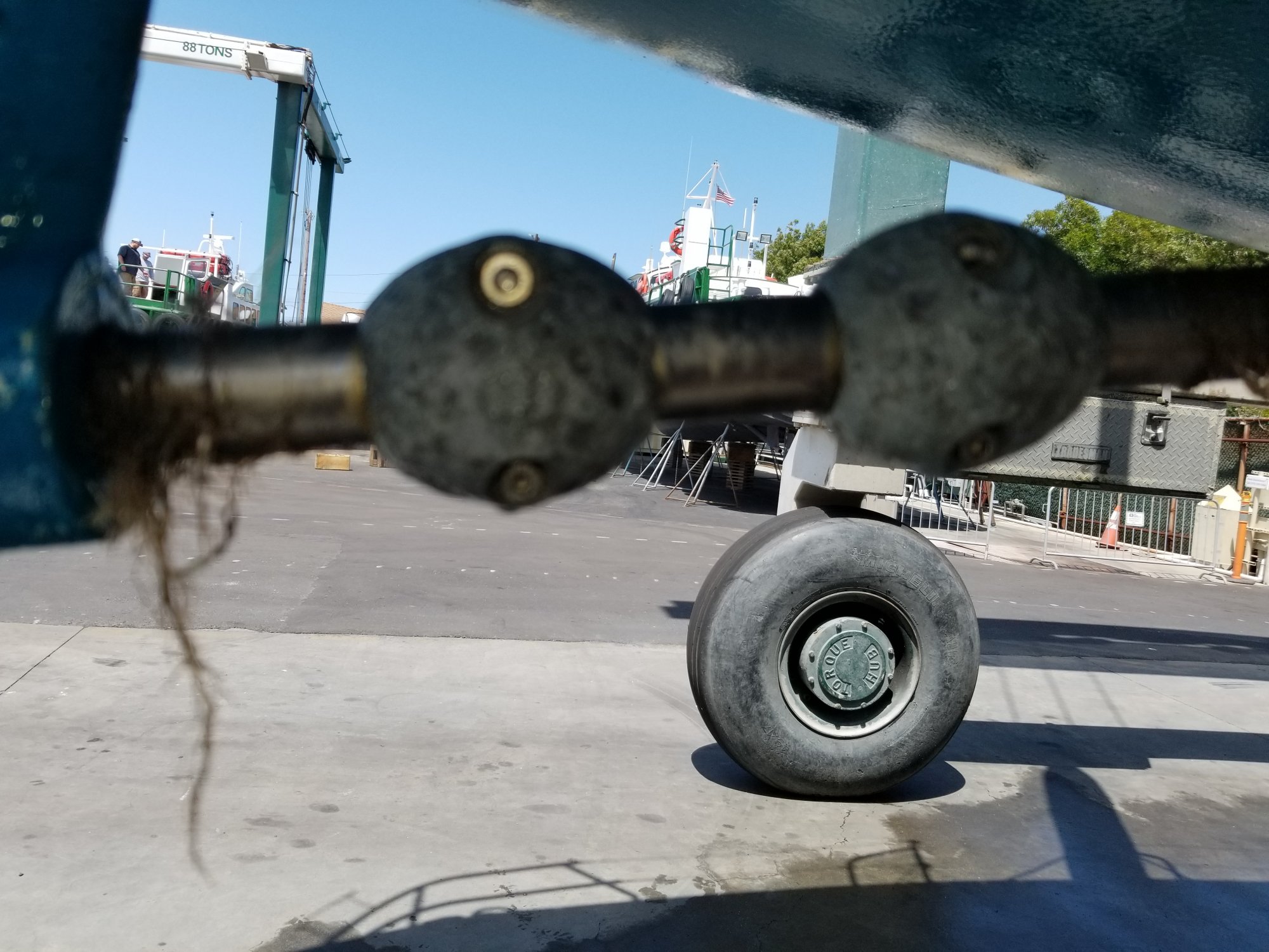

There should be an anode on the aft end of the prop hub. The cone on the aft end of your prop does not look right, it is far too pointy. The prop should have this in addition to the shaft anodes, which look like they need replacing.
Rotate the blades, they should turn smoothly, if not, they need to be lubricated. Check with PYI, they have instructions on how to grease the hub so the blades rotate smoothly. It is a 5 minute job if you don't drop the set screws in the grass. This may be part of the problem you have with reverse.
I find the Max prop to have a lot of prop walk in reverse, sometimes too much. All folding or feathering props need a burst of energy to get the blades to open up or change direction, either going from forward to reverse or vice-versa. The water flow over the blades causes them to feather, that water flow has to be countered before the blades rotate out.

That is an older model MaxProp, like mine, which does not have an anode. It does look to be in rough shape, indicating that the shaft anodes were not adequately maintained. I don't understand the comment about poor performance in reverse, and no prop walk. My prop has crazy reverse thrust, better that a fixed prop, and prop walk about the same as a fixed.
If you clean up the prop, you may be able to get some more use out of it. For sure follow the advice above, disassemble it, grease it, and consider changing the pitch. There is no way you should have to rev the engine to get reverse. One thing - it will be a LOT easier to reassemble the prop with two people. A lot of greasy little parts that all have to line up at the same time.
Yes, your SAE shaft had a part of the threaded end cut off to accept the Max Prop. This is not the case with metric shafts however.
