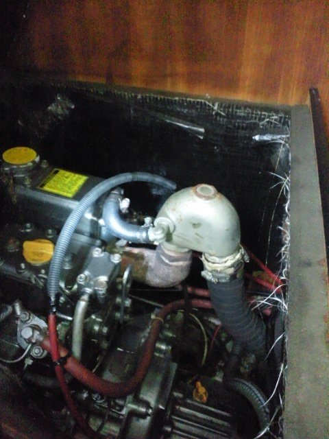

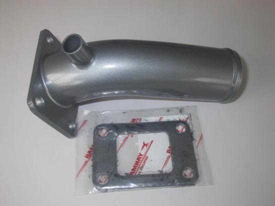

Since I'm facing over heat problem in higher rpm, guys advised me to check the water line and replace the mixiing elbow. So I inspected the parts and find out there are two kinds of elbows. One is U as now installed and another one is slightly bend elbow (New?)
Does anyone did it before? My engine is 2GM20F 1988 proping O'day 302 by KIWI 3 blade prop.

I have the same engine and the mixing elbow is the one on the left. In my Hunter there is very little working room to the rear of the engine and it was far easier to remove the flange from the head with the elbow attached and separate them later. For me, it took a very large vise and gigantic pipe wrench. Some have said one can decarbonize the elbows, but everyone I spoke with said the only realistic option is renewal, which I did. Since you will have drained the anti -freeze, you might as well check the cooler by removing the end caps to make sure they are not corroded. Make sure you have all the gaskets you need beforehand.

I've done mine twice. First time was completely blocked and cleared 95% of carbon with a hammer and cold chisel (in a vise). 2nd time had to replace. Hardest part was getting the exhaust hose off. The bolts were no problem. Take the exhaust hose off first. Then the raw water intake hose. Then heat exchanger bolts. Only way to get the elbow off the flange is in a vice with a very large wrench, and maybe a heat gun. Watch for thread direction. When reinstalling, you can change the angle of the elbow for easier removal in the future. Have fun!

Ricky, it seems like clock work that I need to change my U mixing elbow every 2 years. I had wanted to change the U to the straight SS type but realise it makes the whole assembly lower in height, hence higher risk of letting backflow into engine since my exhaust outlet is underwater.

A couple weeks ago there were several elbows on ebay made out of stainless. Some guy needed a new one, and made one up, then since he had the patterns, made some more to sell. Think they were 2QM or possibly 2GM and were going for around 125. Wouldn't hurt to look.
