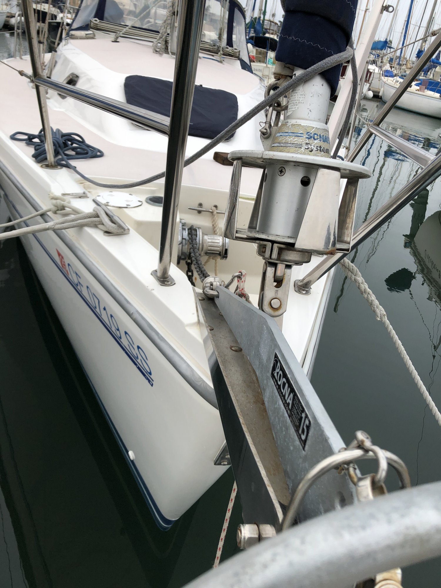

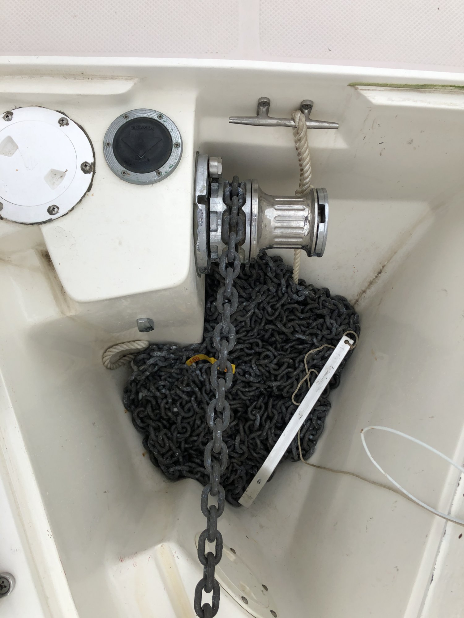

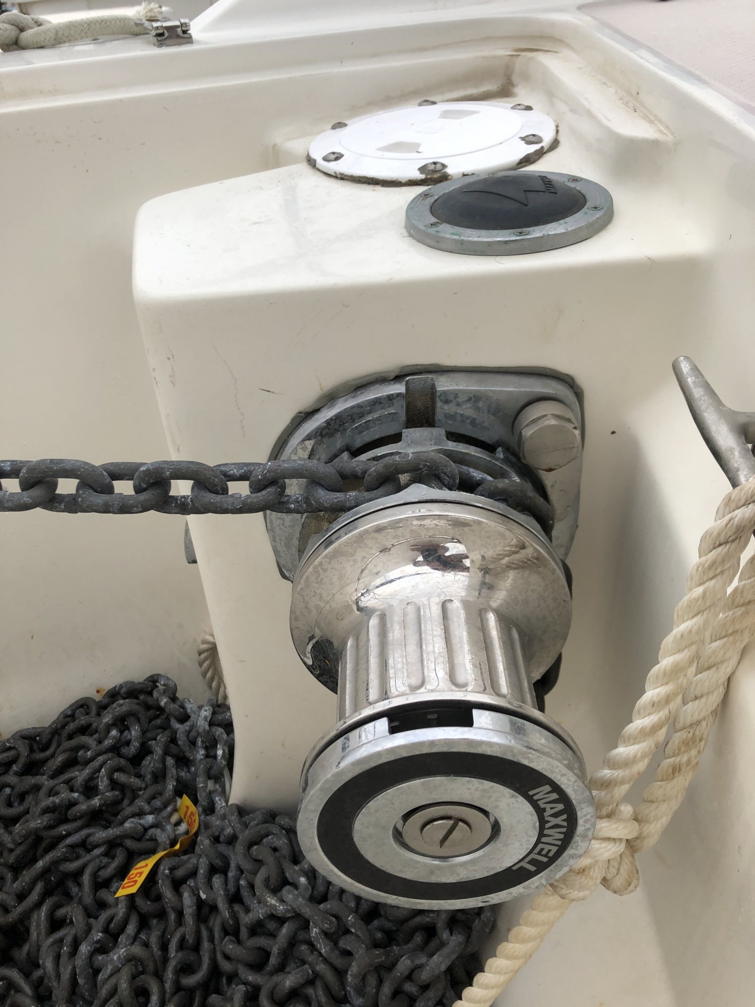

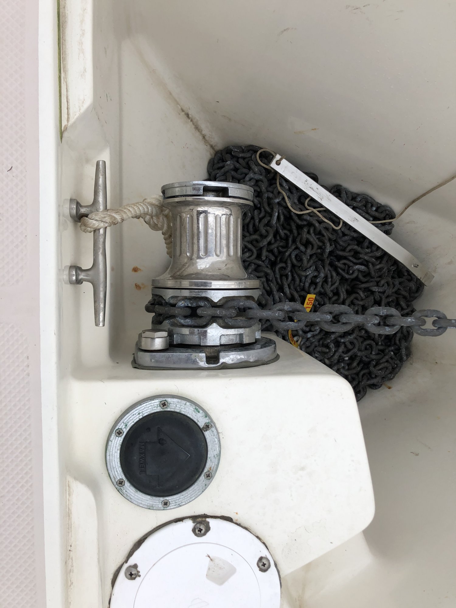

Looking to replace my original windlass with one that will take chain. I want to put it in the same opening as the original one. Has anyone done that.

If you'll post several pictures of your current setup, those of us who don't have Cats will tell you which windlass will fit.

I was able to upgrade the windlass on my boat. Due to the shape of our chain locker it does not work well.
There just is not enough of a vertical drop for the chain. I tried installing rollers and guides to get the chain to not jump the gypsy when raising the last 50 to 100 feet of chain. Nothing worked until I used a piece of 2x4 between the gypsy and the bulkhead. Not optimum but it does work well. I have 150' of 5/16" chain, usually anchor in 30' of water.

Hello Mark. Where is the 2x4? I do not see it in photos.

I am interested in this project also. Right now I use the original Maxwell 500 windlass to assist retrieval of 5/16" chain. I have 120 ft of chain and typically use between 60-80 feet while anchoring mostly in Florida. It works OK but a chain gypsy would be better just not sure if that is realistic with the limited vertical drop. Wonder if any 310 owners have solved this?

I use a scrap piece about 2' long and just slide one end between the gypsy and the bulkhead to keep the chain from jumping off the aft side of the gypsy and to keep fingers far away. Like I said not great but it does work.
