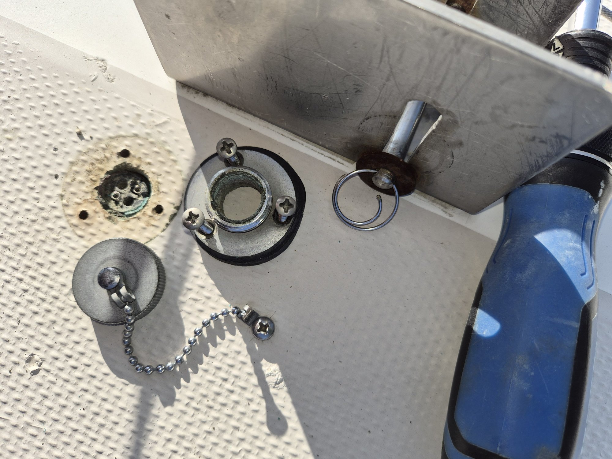

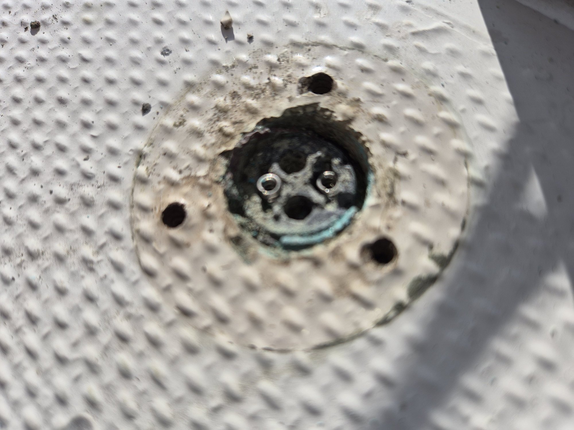

Next project: mast-wiring. PO ran new mast wires (4 of 'em), but never finished the deck connection. Looks like the original 2-pin female plug. All I need is the masthead light and forward steaming light. My thought is to replace with a 4-pin plug, but I know little about electrical systems. If I take out the original deck plug, what am I going to find underneath? Any wires with enough length to connect to new plug? (Inside the cabin, I can't see anything -- all the wires must be inside the head-liner.).

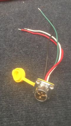

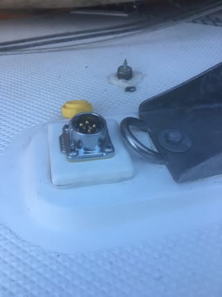

A trailer connector worked for me for years, and I will likely do the same when I rewire the mast on our new-to-us boat. See my comment in the discussion at
Photos a few posts down from that comment.

I have the 4 pin deck connector from Catalina Direct. It's a beautiful piece of harware but Shemandr is right, it's hard to keep a good connection. Keep having to go back, clean contacts and wires and coat with dielectric grease. Danooxnard it right about the screws.

After alot of trial and error I found CNLinko connectors and after 3 years they still work great.They have very large soder connections. I did add heat shrenck tubing to the end for extra waterproofing

As far as I know, your model C-22 did run the wires in the head liner. My '74 C-22 did not have any lighting on the mast. I used a lantern as an anchor light. Your model year introduced a steaming light on the mast and had a two wire harness in thru the cabin top next to the mast step. I have the same connectors in my cockpit for my solar connections but I don't know how good they would be for a cabin top application. You can get a direct sized replacement mount in either two, three or four wire versions. I doubt that you have a three wire harness led through the ceiling. I would suggest that you check the female connector for continuity and if it's good, use that for your steaming light by installing a new male two prong connector. Then you can easily hang an LED anchor light off of your pig tail. This is what will get you going with the least amount of rigamarole.

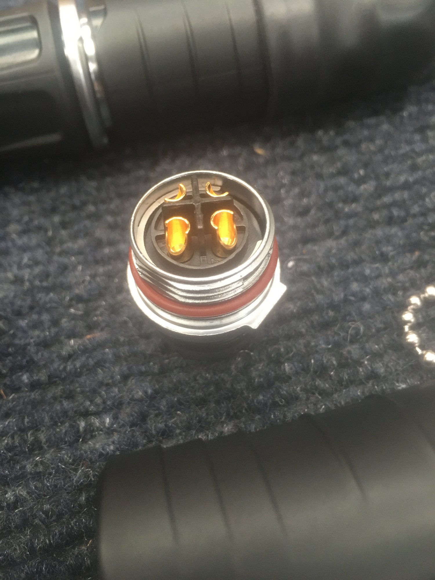

Gene Neill makes the case for using a trailer connector because the female plug is on top and the male on the bottom which means the plug sheds water instead of funneling water into the female plug. He has photos located about halfway down the discussion at Protecting the mast light connector and VHF connector. I plan to make this conversion after the end of this season.
