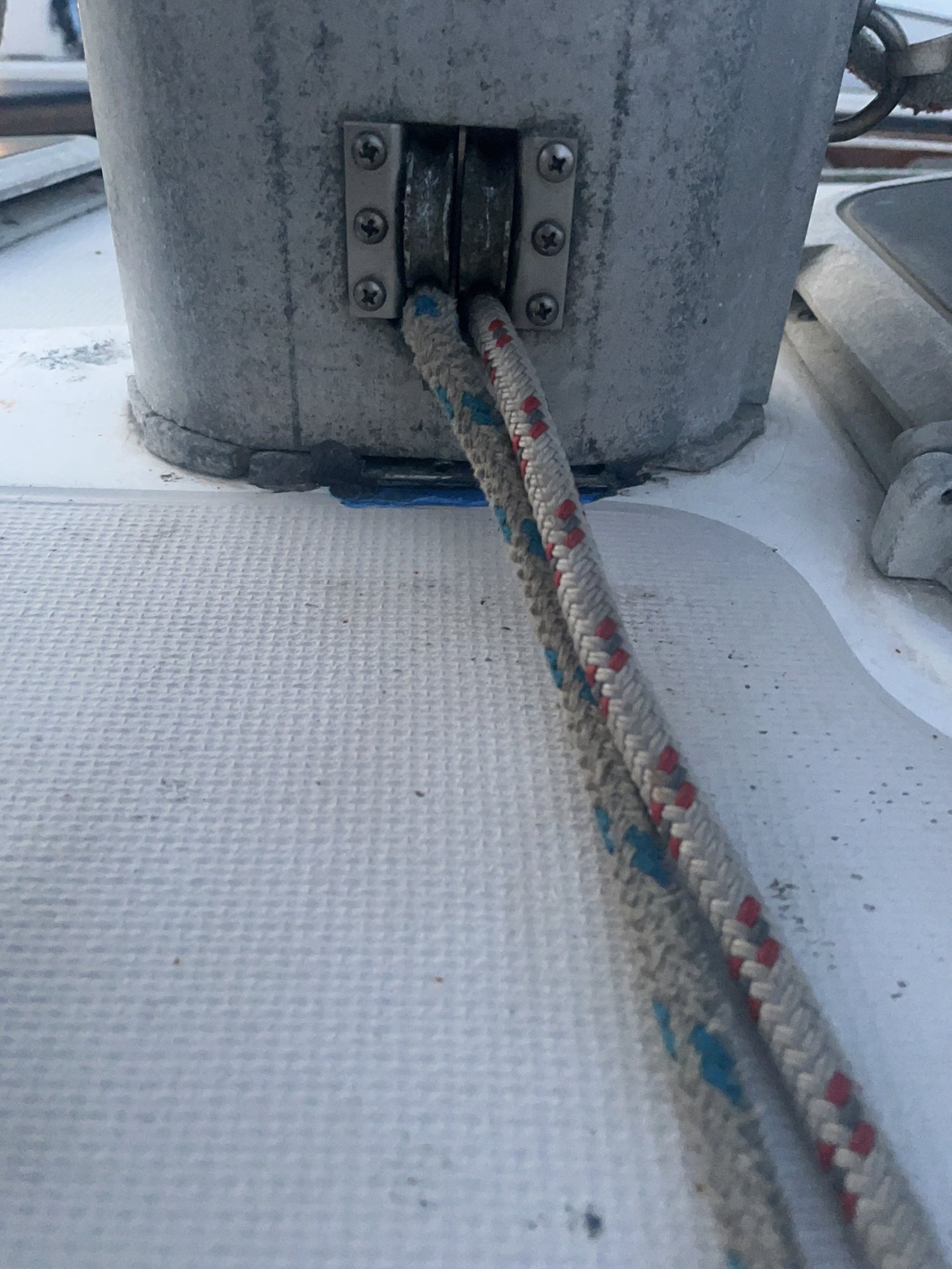

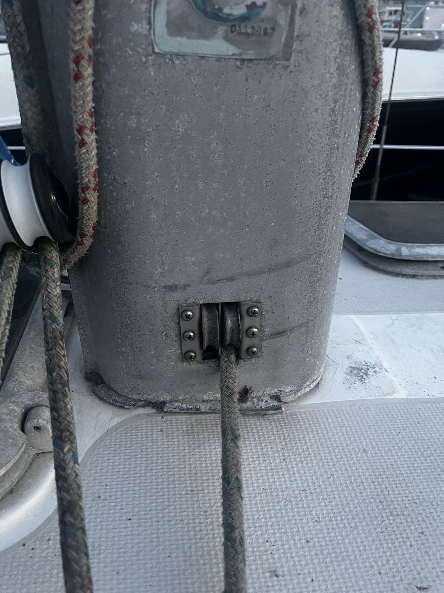

I purchased this boat three months ago and have been working to get her to sea for a trial. The halyard for the jib is frozen. I ascended the mast expecting to see it wrapped, but it looks good on top. I was able to get slight movement of the halyard at the top. At the base of the mast, there is a dual roller clip with a frozen sheave. I ordered replacements for port and starboard from Catalina Direct. Each clip has six stainless screws that are frozen tight to the aluminium mast. I tried multiple coats of PB Blaster of the last three months, but it is frozen. I tried vice grips + phillips, and a manual impact driver. I think I need to drill and retap. Does anyone have any ideas? If I have to drill, is my 18V Dewalt drill a good choice, or should I get a larger 120V drill? I bought the best cobalt bit that my hardware store had, and oiled it every 30 seconds, but it stopped cutting as it barely penetrated the screw head. I hit the head once with a chisel and hammer, and the top came off. At this rate, it looks like about a dozen drill bits.
I certainly am no fan of drilling and tapping and welcome any other ideas!

Thanks for the advice! RitSim was right on with the power impact driver. I think you could have knocked me over with a feather when I saw the first screw turn! I thought for sure it would just strip--which is why I purchased the old fashioned manual impact driver so I could clobber it with my 20 ox dead blow hammer. What a waste of time. I was able to remove 10 of the 11 remaining screws with a simple Milwalkee power impact driver.
I do wish I had read RitSim's advice on the drilling technique. I made a mess of it, but will figure something out to reinstall the new sheaves, which were just delivered by Catalina Direct.
Thanks all! I am all set.
