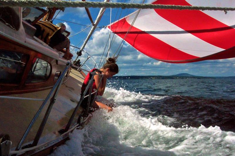

Are you people nuts! Seriously bonkers!
Lifelines are not made to render aid in your driveway. These are not driveway boats, They are sailboats. Sailboats heel, and many a folk take great comfort, and fun, using them for support and safety, while heeling under sail. See no benefit to lifelines in these photographs?
I am pretty green at this, having sat out sailing 25 years, but even I can figure out the extreme level of safety these provide to everyone on a sailboat.
Leave them on!
Put them back, if removed!
Get them updated with new lines if need be!
Waterproof the stanchions if they leak!
Don't have em, get em! www.MarinePartDepot.com.
One of the most important pieces of equipment on any sailboat.
With lifelines, getting knocked out cold by a boom is bad, but staying on the boat afterwards is critical. Lifelines just may do that. Better to slump over the lifeline, than fall into the water. Without lifelines, getting knocked out cold, falling off the boat, lungs fill with water, as the crew works at turning the boat back around, locating you, getting your lifeless body out of the water and onto the boat again. One option, is a headache, or concussion, the other option without lifelines, is a great potential for a funeral!
People in this thread talk about removing lifelines, like it is nothing more than removing the expired green tree air freshener from your rear view mirror in your car.
I had single lifelines on my William Crealock CM32, and I replaced them with double lifelines from another CM32 I own, to better protect my crew.
