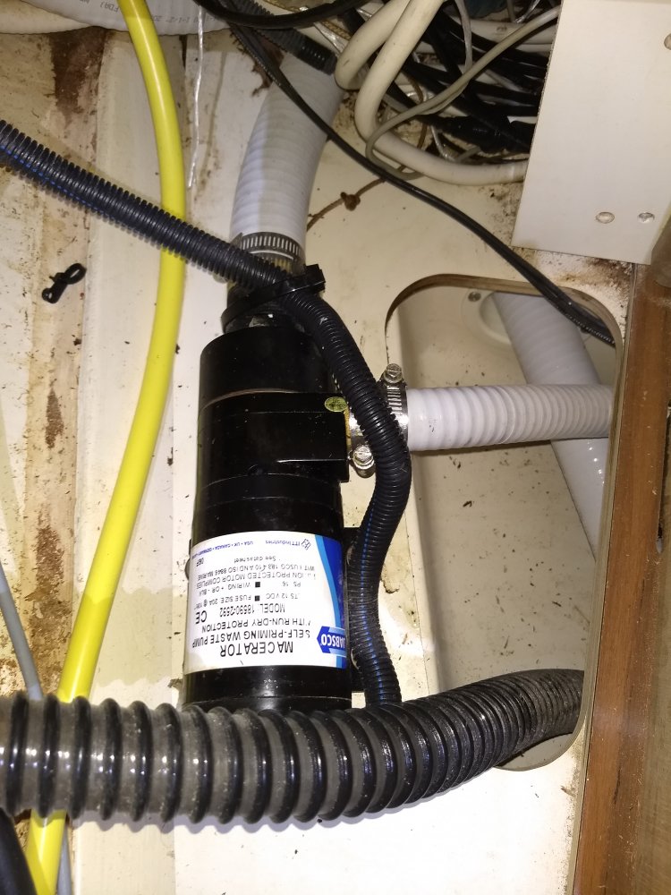

I am replacing my broken Jabsco maserator pump with a Seaflo unit. Of course the Jabsco broke by the bolts snapping because they are NOT made of stainless. This has happened on 2 Jabsco units, which is just amazing. When they snap, of course they leak which at best is disgusting and at worse can sink your boat. Although the Seaflo units are made in China, they carry a 4 year warranty vs 1 year for the Jabsco. The Seaflo unit looks good to me, but only time will tell.
Has anyone out there have any experience with Seaflo products?

1. I believe it's still legal past the 3 mile limit
2. My maserator is mounted under the floor and connected by a short length of hose to the sea cock. How else could it be plumbed? If the sea cock is left open and the maserator leaks, sea water will and has entered the boat.

I have replaced with SEAFLO. This is NOT Shrurflo. Seaflo is a new brand, made in China with a 4 year warranty. I am wondering if anyone has any experience with this new brand.
On the issue of below the floor macerator mounting, that's where Hunter put it in both of my boats. I think it's a good design as it lessens the load on the pump to discharge and makes for a simple, cost effective installation. The failure in this system is that it relied on a name brand pump, with a really stupid fault. The bolts that hold the pump together are NOT made of stainless. Of course Jabco now sells for around $20 bucks a stainless bolt upgrade kit. I bought a kit as I thought I could fix the broken pump, but one of the bolts sheared where it enters the plastic housing with no way to remove whats left of the bolt.
As far as the bolts snapping on the Jabsco units, corrosion did NOT play a part in there failure. The bolts appear to be made of bronze. I think the problem is they are of a very small diameter and cannot take the strain of the torque applied when the motor starts. It would have been really hard on Jabsco to increase the diameter of the bolts to make them better able to resist snapping. Jabsco saved at least 2 cents per pump.
I have had other problems with Jabsco products, such as having to replace water pressure pumps after very little usage. When the water pump fails, it's a nuisance and can ruin a weekend or a vacation. I'm sure Jabsco knew Hunter and perhaps other manufactures were mounting the macerator pumps below the floor, where a leak from the faulty unit could sink a boat. It's amazing that Jabsco has had made no effort to address this problem or at least warn boaters of this potential defect.
