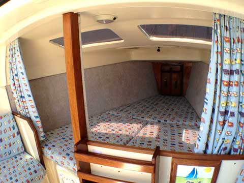

Are your fixtures like this?
If so, there are 4 little tabs holding the clear lens in place. I remove them by slipping something thin and flat (little a tiny screwdriver) between the clear lens and the solid fixture and prying the tip of the screwdriver towards the center of the light and then down and out. I can't remember if these tabs can be anywhere or if the lens is always clicked into place in the same orientation. For example, the 4 tabs might be with one lined up with the on/off rocker switch, or 45 deg away from it. Or, the position could be random!

Thanks, but yours look like upgraded lights or perhaps they changed them after 93'? Mine do not have a rocker switch, they are turned on by twisting the entire fixture. I will post a picture at my earliest opportunity. By the way the interior looks awesome, did you install a locker in the bow end of the v berth? Great idea!

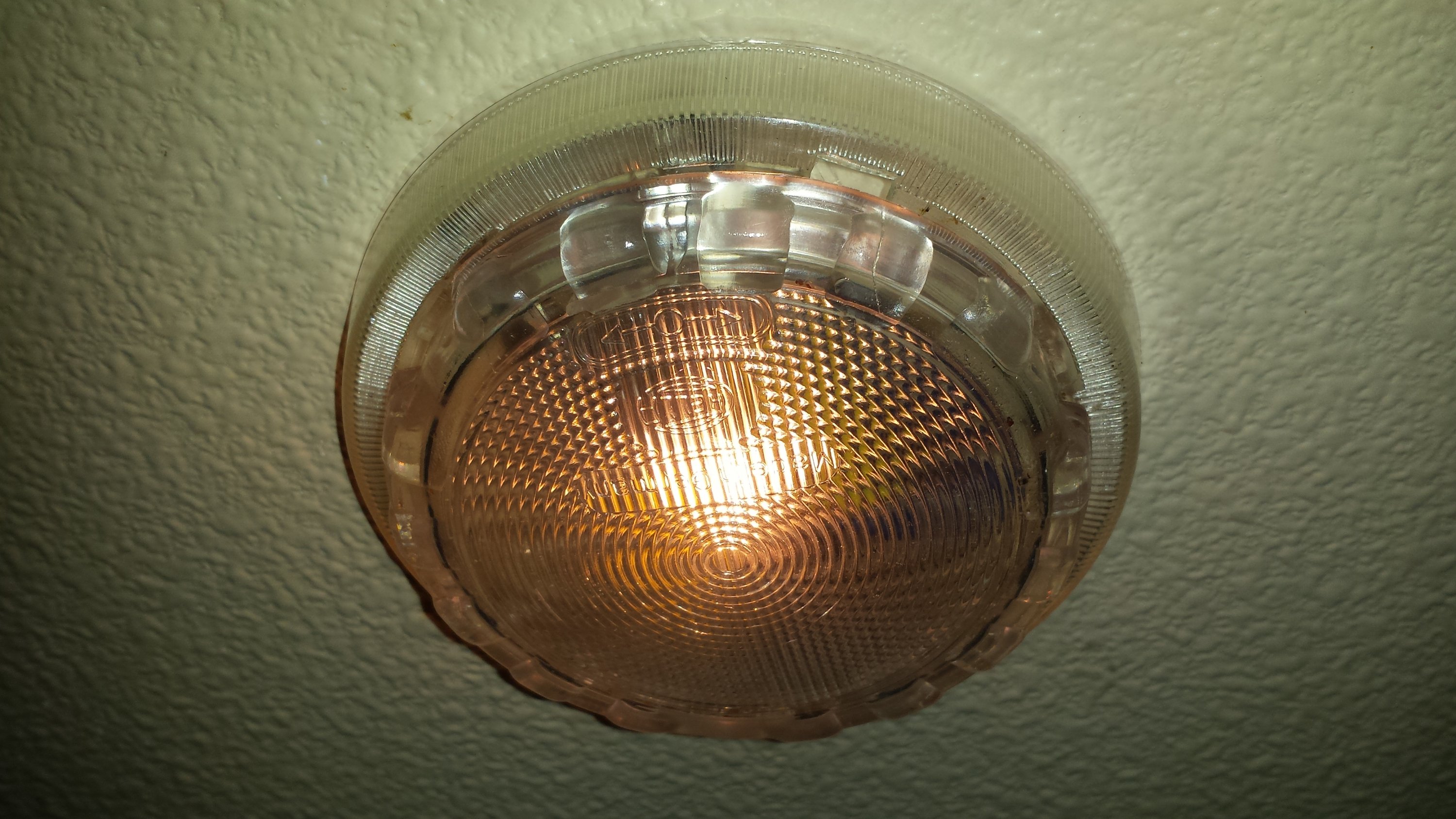

Is it like this? If so, push in and turn counterclockwise. The lens will then drop out. My boat is a 94', I had the same question. I couldn't figure out how to open it either and someone on this forum had the answer.

As it turned out it wasn't the festoon bulb, the fixture is bad. Apparently this fixture was discontinued early in the Hunter 23.5 production and replaced with the type seen in the picture of the 95 model sent above. Since the bad fixture is above the saloon table, I'm going to replace it with the one hidden in the rear berth and replace that one with one of the new fixtures in the previous posts. I may decide to replace all of them. Thanks for everyone's help!
