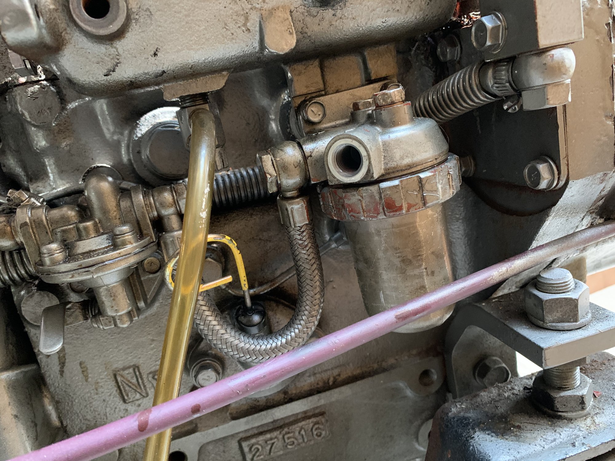

Scott, That picture helps to understand your setup.
I'd go with the simplest test first. Change both fuel filters. Try to capture the fuel from the filters and put it in a clear bottle. Let it settle and see what the condition of the fuel is.
If the fuel is clean, then I'd go with feeding the Racor from the can. That would rule out the fuel tank and pick up tube. Put the can wherever is the safest location. Probably next to the tank.
Once that is ruled out I'd borrow an electric fuel pump (someone at the marina has one or we can put one together) and pump from the can to the injector pump.
Your problem started on a rough ocean ride back from CM. That tell's me your tank probably got stirred up and started sucking crap. My bet is still on the filters.

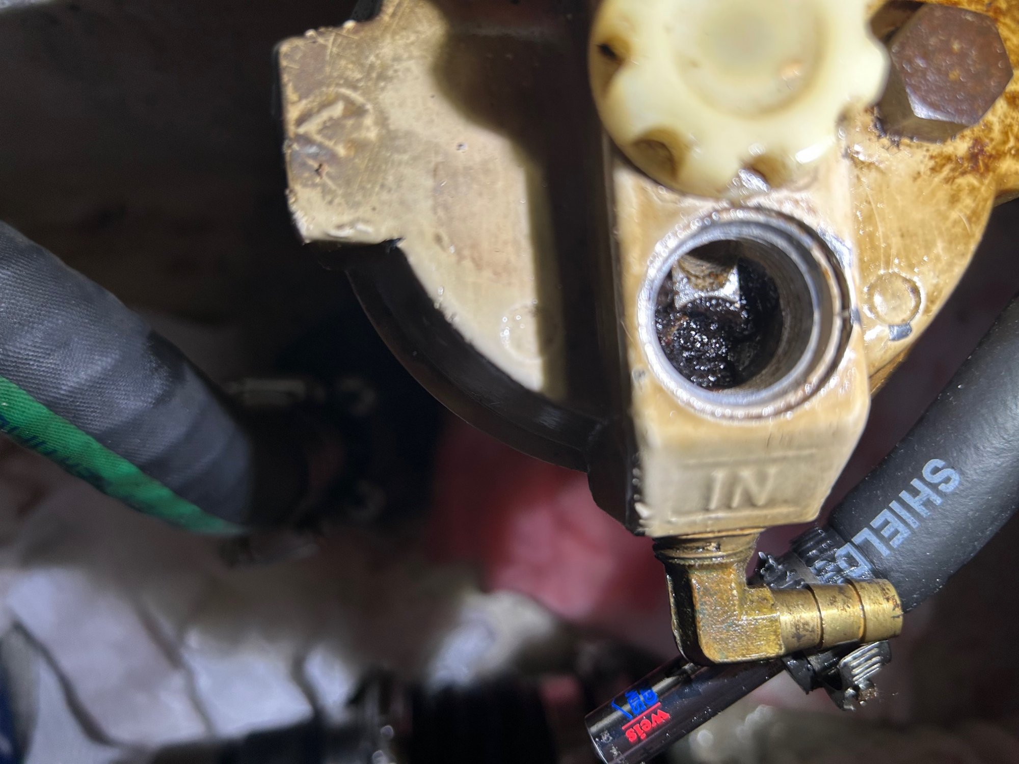

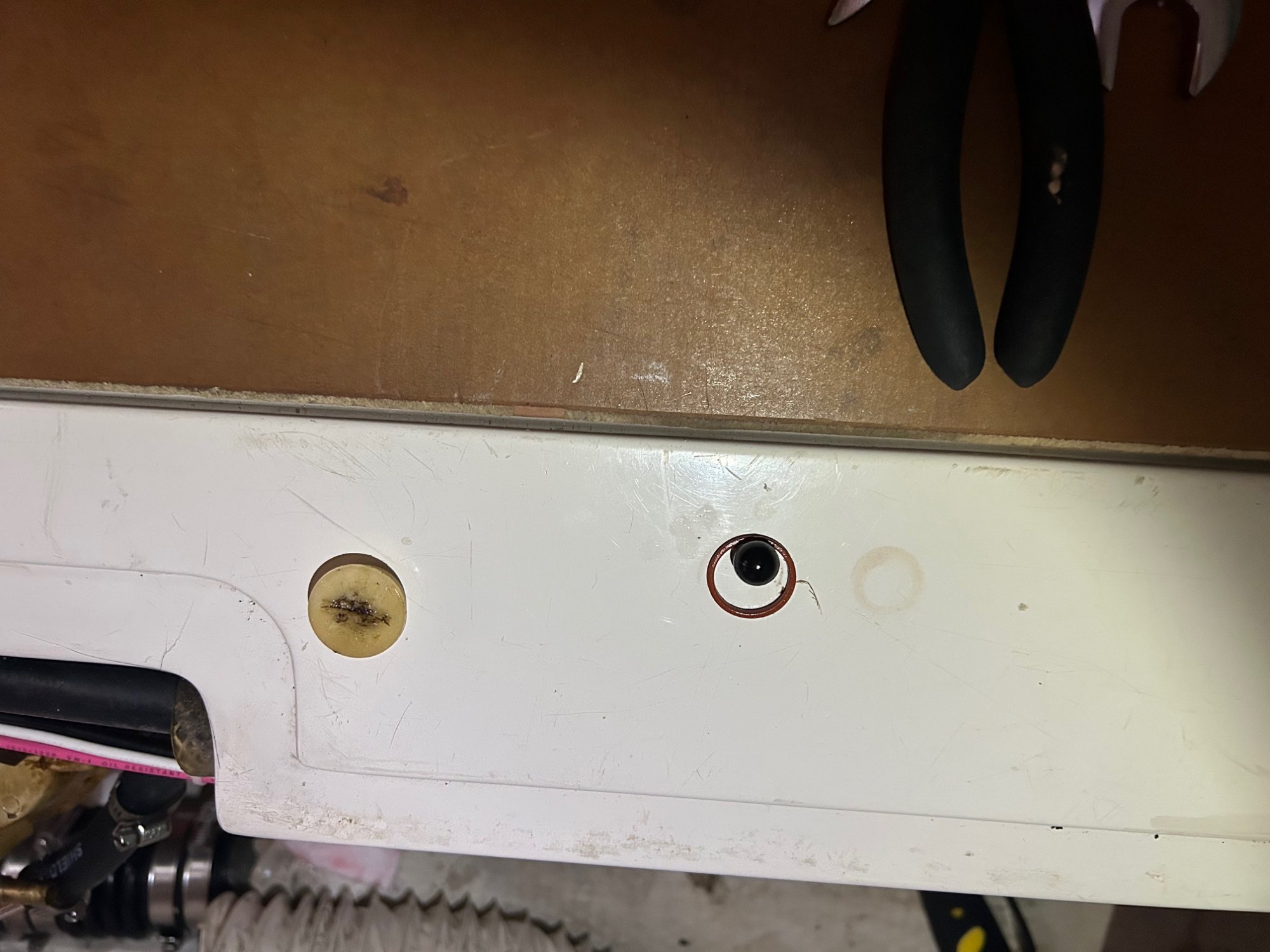

Well, it turns out that the ball valve WAS the problem! So a great big thanks to Stu for reminding us of this possibility! Also, I did replace the lift pump because it was an easy replacement. I think the old one was fine because I could hear that the membrane was functioning properly. I understand that if it begins to fail, fuel will begin to leak into the oil and you might start to see the oil thinning out & increasing the oil level when making routine oil checks. Anyway, I have a spare to give away if anybody ever needs one.
I mentioned this issue to the 3 mechanics that I was in contact with. The only guy who showed appreciation for the knowledge was the cruiser I met in Cape May (he spent time on my boat in AC helping diagnose). He said "thanks! it's good to know". One mechanic ignored my comment and the other one said "well, it would be stuck in open, so that wouldn't make any difference". I was pretty sure this was a foolish statement! :facepalm: As soon as I took the plug off the top of the chambere, it was a very obvious problem. The gunk clogged the ball so that it could barely move!
Here's a picture of the ball and o-ring removed for cleaning. It wasn't that easy to clean the gunk out of the chamber. I used a q-tip & dental pick and flushed the chamber with fuel until I couldn't extract any more material. I didn't remove anything except the cover plug to gain access. I may upgrade the filter, but that will be a winter project.
