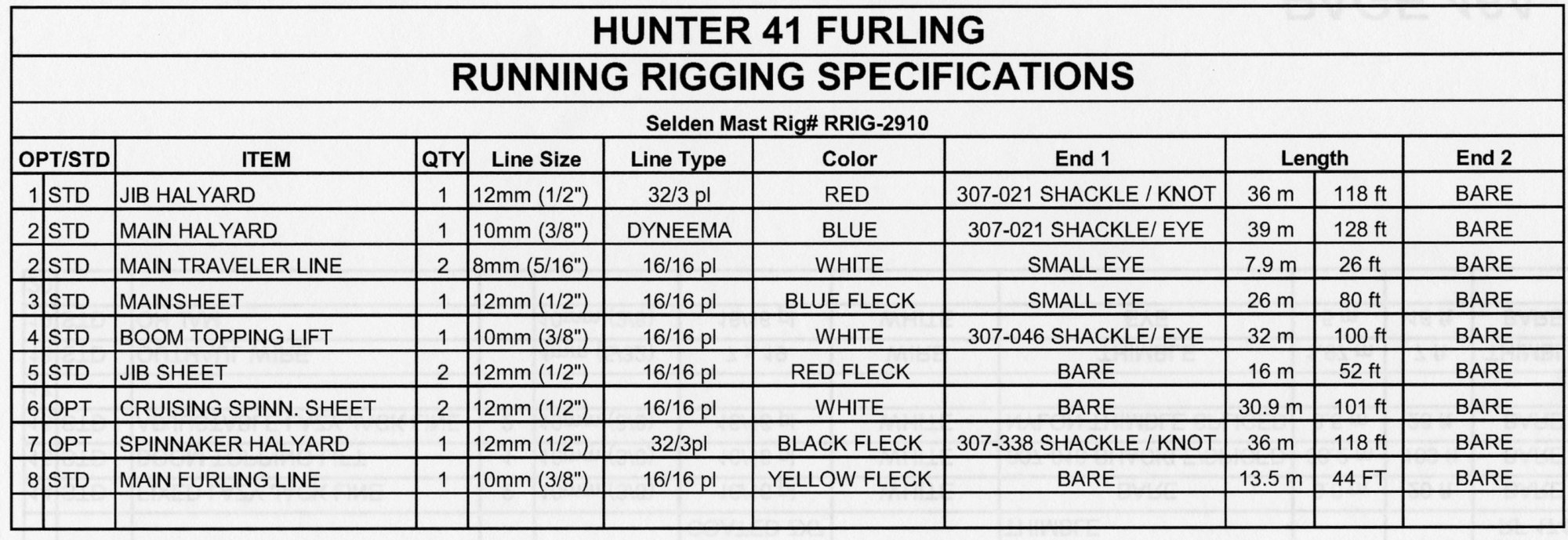

I'm looking to replace the running rigging on our 2007 Hunter, beginning with the topping lift and the spinnaker halyard. I'm choosing these first because I want the new lines for ascending the mast. In the attached image, taken from the Hunter manual, the sizes, styles and lengths of each of the lines is given. I'm trying to understand the entries in the column with the heading "Line Type". I'm guessing that the "pl" is an abbreviation for plait and that the first number might be the number of plaits in the cover while the second number might be the number of plaits in the core. Is that a correct assessment?
Also, other than for the main halyard, no information is given about the material. What would be a good choice for the topping lift and spinnaker halyard lines?
24,598
You have "European" line types listed.
It would be a twisted 3 ply core covered by a 32 plait cover.
USA terms describe the line material i.e. Dyneema, polyester or Dacron, nylon... and single or double braid line, or 3 ply which would be a 3 strand twisted line (not usually used for halyards but serviceable for anchor line).
This link may help you. https://www.sailrite.com/PDF/Rope Selection Recommendations.pdf
Typically you want a low stretch line for your halyards, and a low to moderate stretch for your sheets.

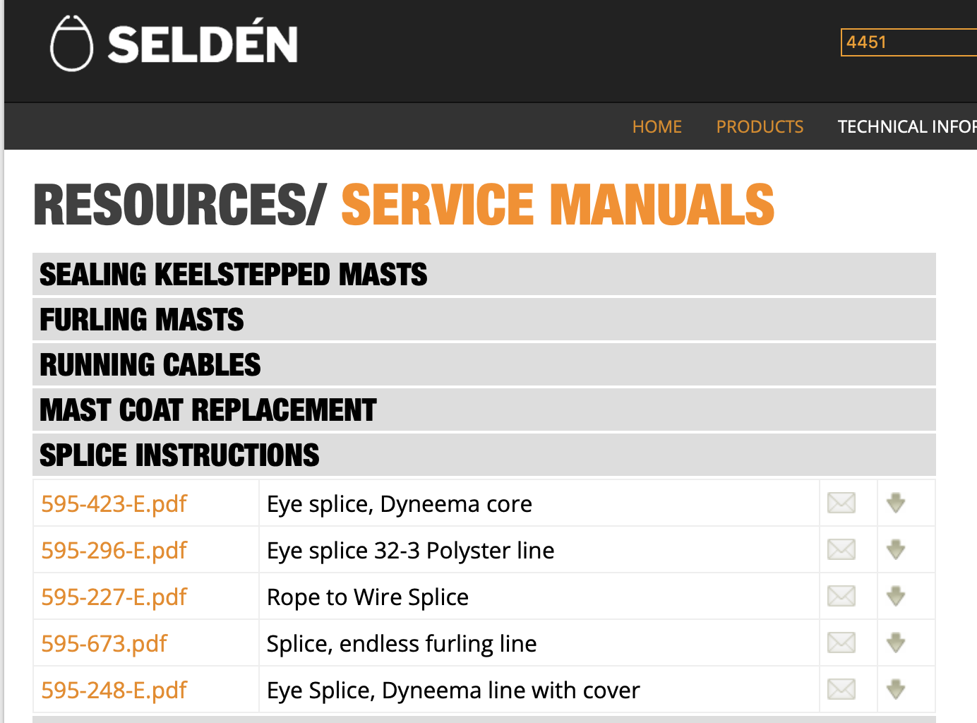

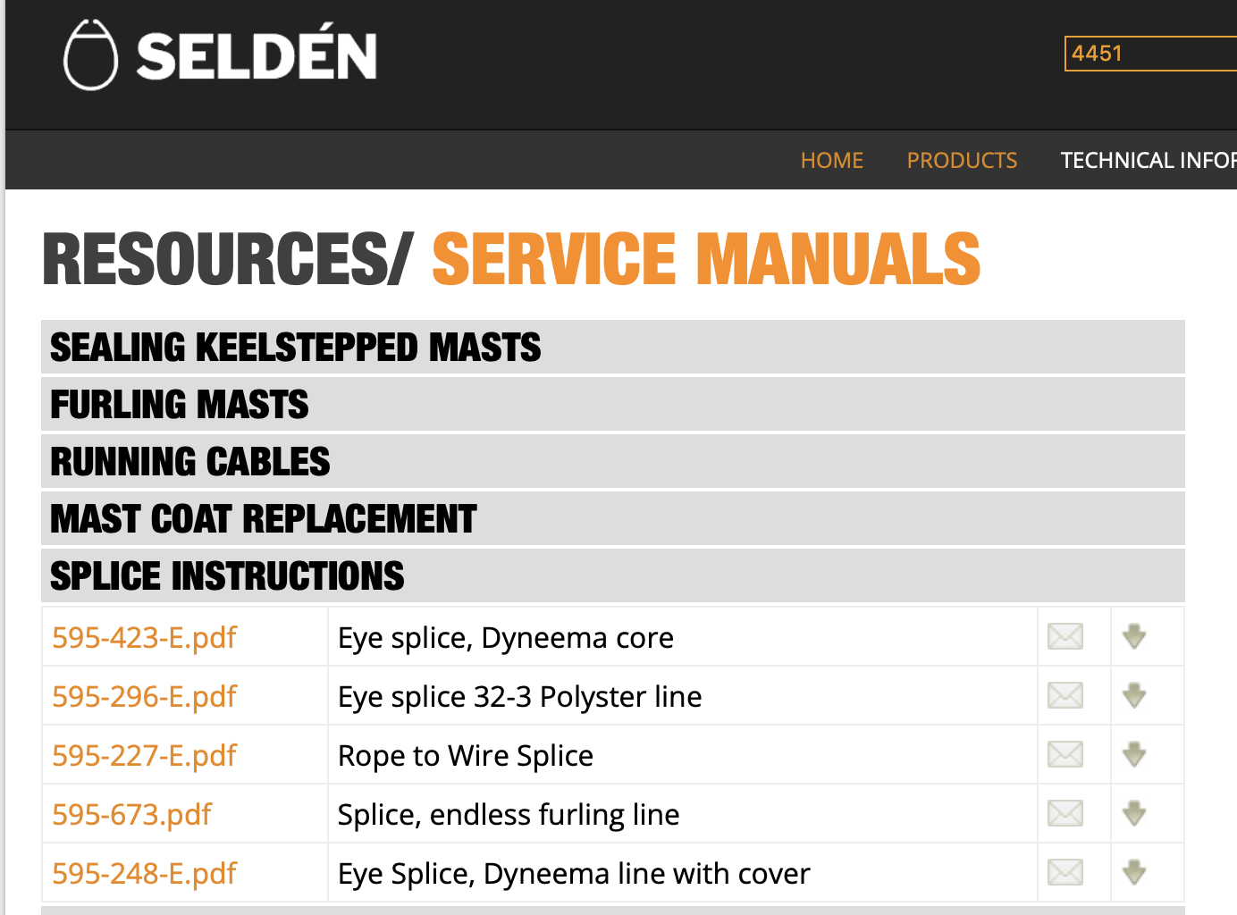

Dreamer, my Michigan friend, I reviewed the Selden website. Where I came upon a Splicing PDF with the title "Eye Splice 32-3 Polyester Line.
It is an older reference and one I believe used in Europe to describe Dacron Double Braid Yacht line.

I like the idea of measuring the lines rather than relying on the chart. Rather than pulling the lines, I devised a way to get an approximate (but close) measurement without removal. I'll use the spinnaker halyard as an example. I attached the end of a 100' tape measure to the clip on the halyard as well as a retrieval line (I just used one of the jib sheets). Then I hauled the clip up to where the line enters the mast and noted the reading on the tape at the bottom of the mast. This gave me the appoximate length from the halyard sheave to the bottom of the mast. Next, I pulled the line back down using the retrieval line and clipped the halyard to the base of the mast, pulling the other end taut. Then I measured the remaining halyard line leading away from the mast. This length was added to twice the distance from the sheave to the mast base to arrive at the total length. The result for the spinnaker halyard was 138' compared to the table entry of 118'.
I repeated the same process for the topping lift line (but I had to use both jib sheets for the retrieval line due to the extra height) and got an estimated length of 122' as compared to 100' in the chart. I suspect that the topping lift line has been replaced because it is larger than the 10mm shown in the chart. It measures the same diameter as the spinnaker halyard - 12mm. Further, the color doesn't match what is given in the chart.
