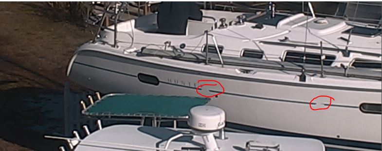

Hi Everyone,
I became the owner of this 2002 Hunter 356 this summer and she just got hauled in Mystic, CT for the winter. Does any one have advice on removing and replacing the hull stripe? I plan on replacing the Hunter and 356 decal too... I know both are available from the Hunter parts store... Mostly wondering about the difficulty of removing the old stripe?
Thanks,
Jerry
