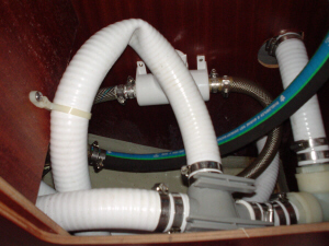

Heating any hose to bend it tighter than it will bend willingly is not a good idea because the outside of the radius will be stretched enough to weaken the hose and cause it to tear--if not immediately, within fairly short time...and soften the inside of the radius enough to kink it. (See photo). Instead, break the hose and insert an inline 90 or 45 degree radius fitting. Dometic/SeaLand has a complete selection....see page 35 in this brochure: SeaLand Marine Toilet Systems Product Guide
