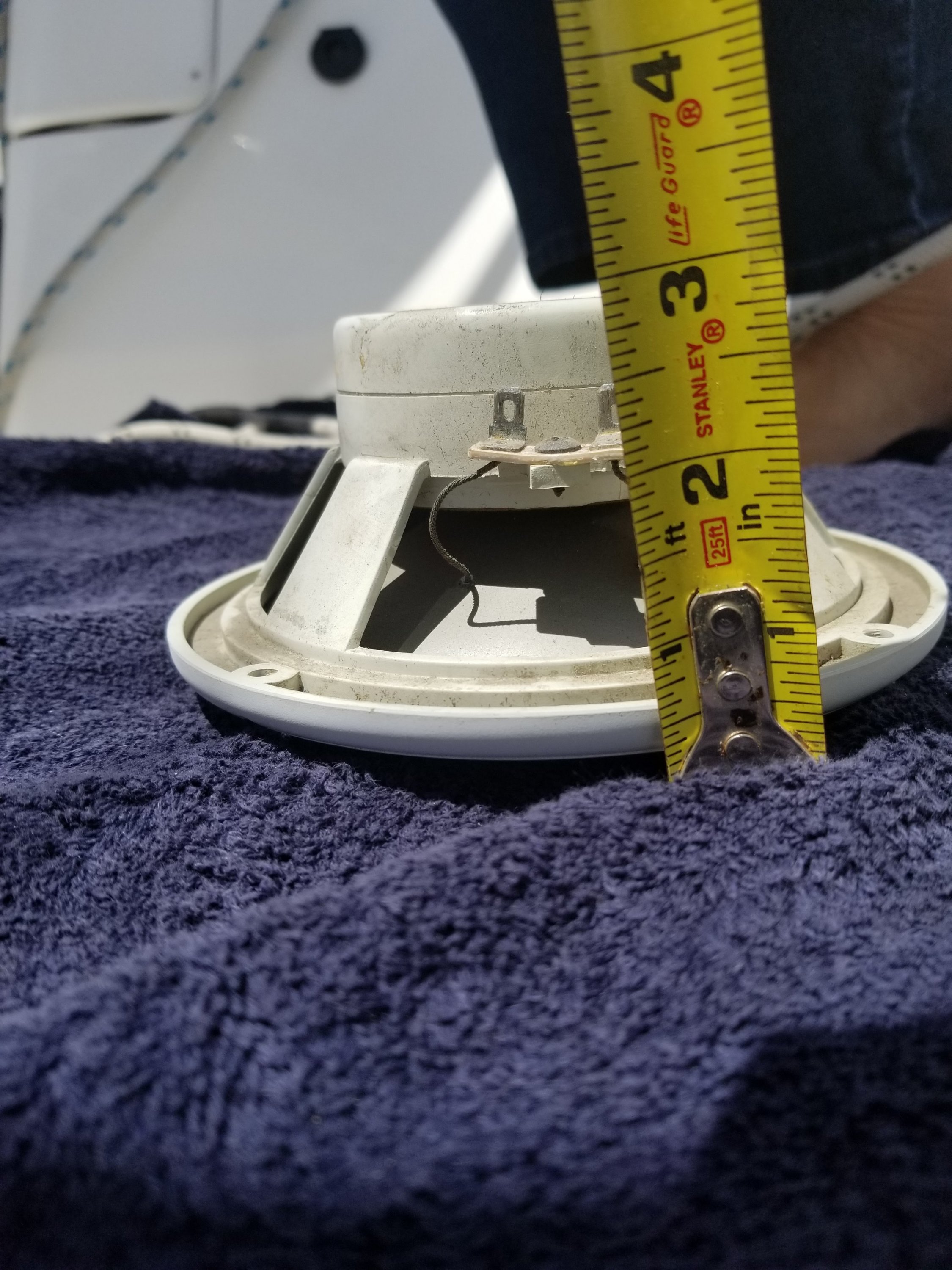

What size and depth are they?

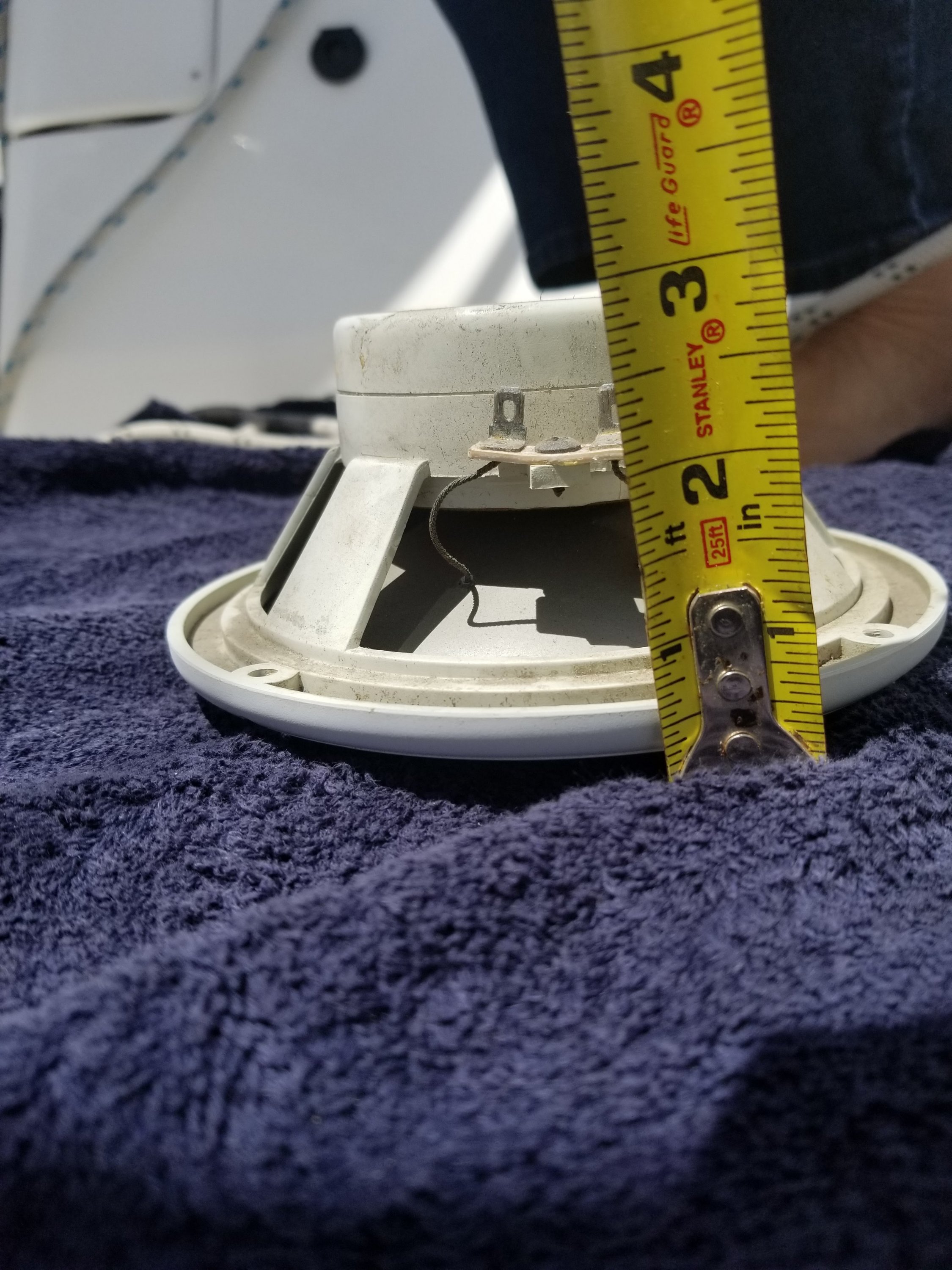

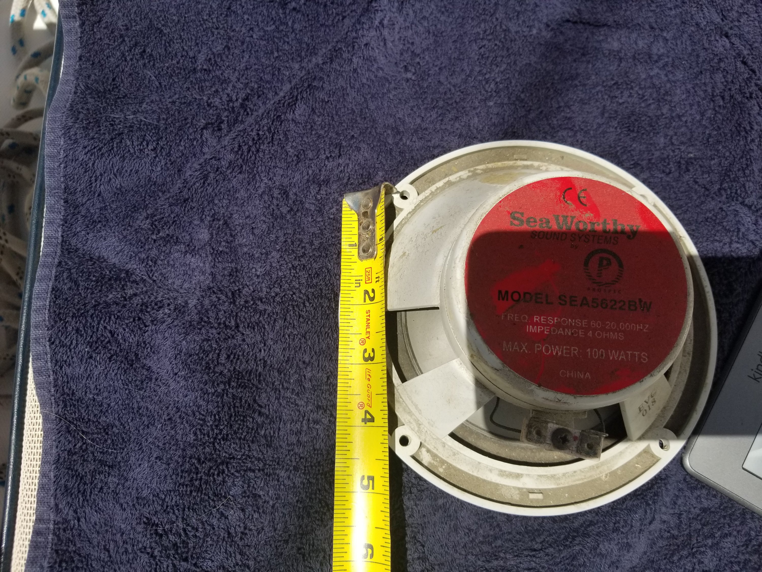

The existing speakers are Seaworthy 5622BW, listed as 6 1/2" round. I think they are about 3" deep, but they narrow fairly quickly which is important because it is not completely clear behind the speaker.
I guess I could add a bezel which would help the depth issue.

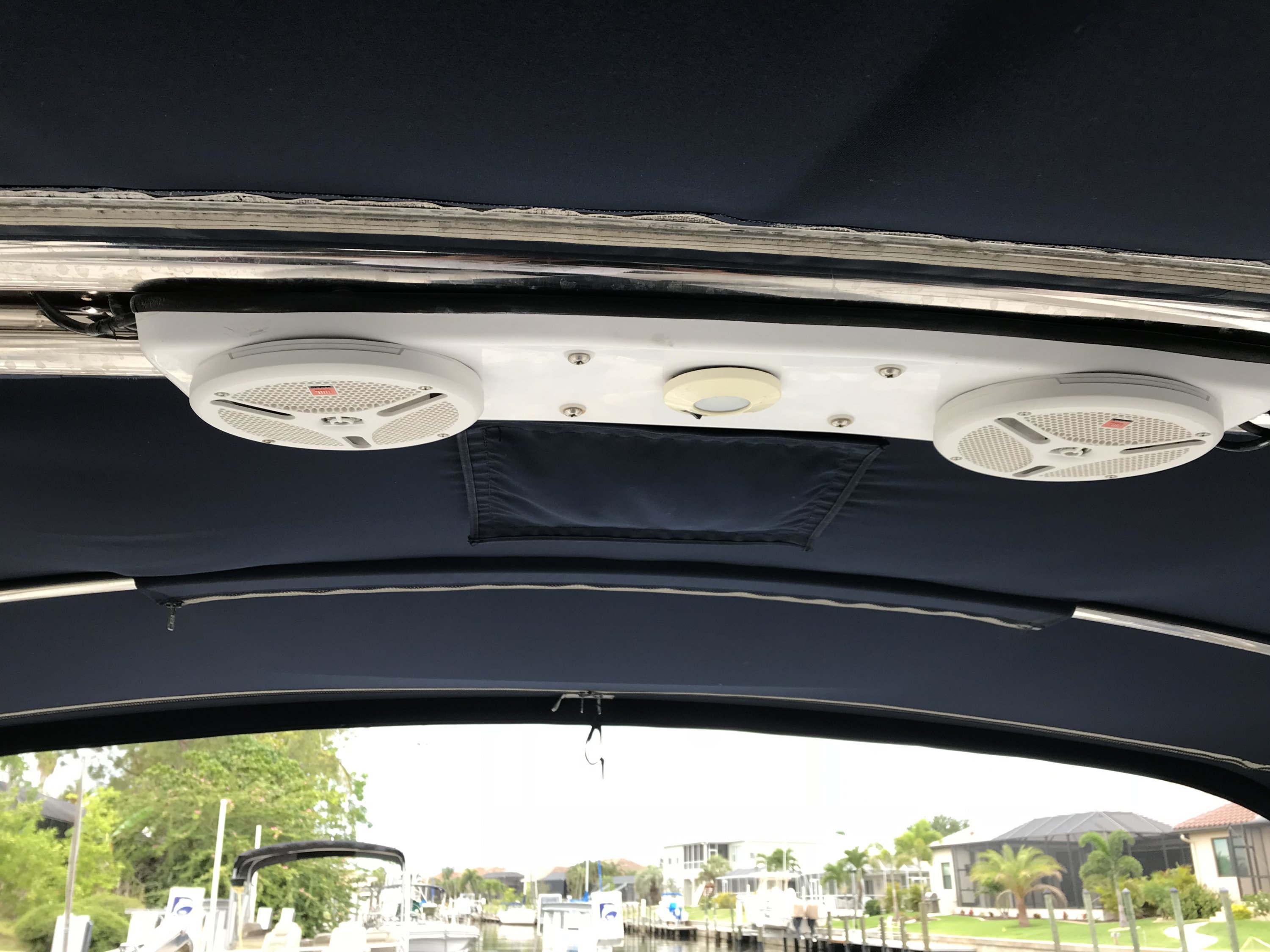

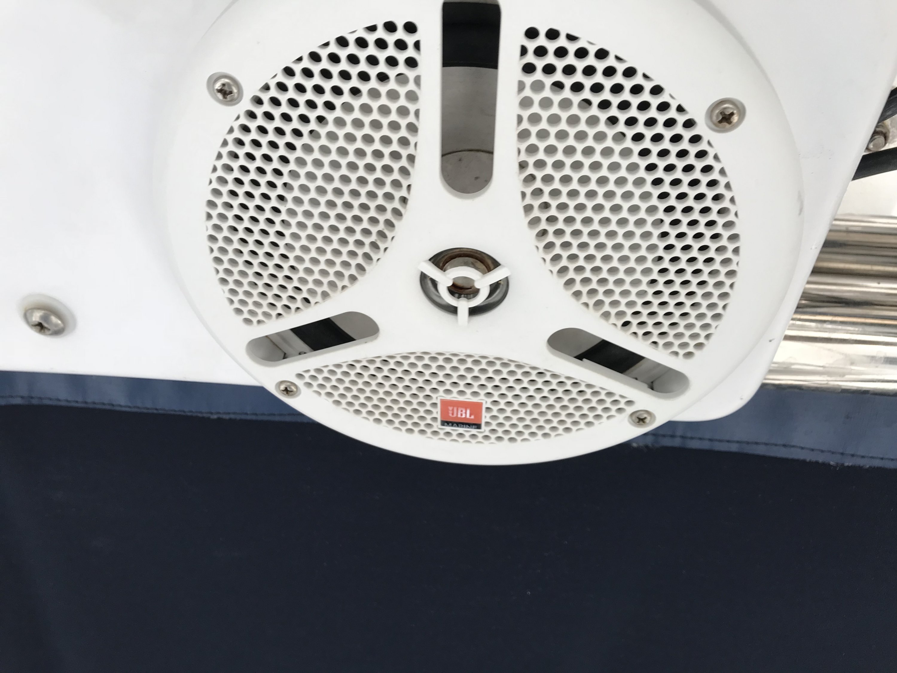

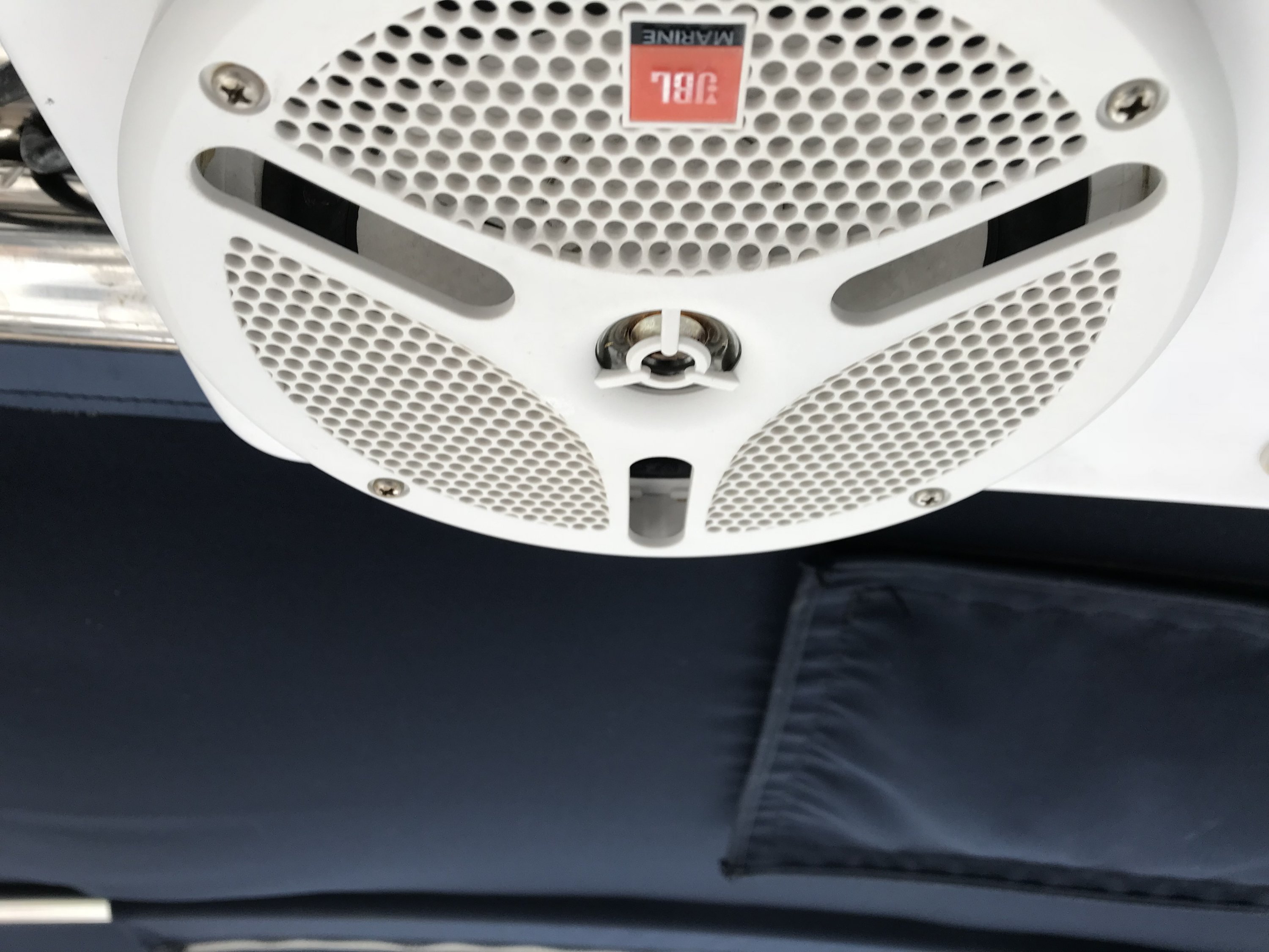

Dec 19, 2006
5,836
Hunter 36 Punta Gorda

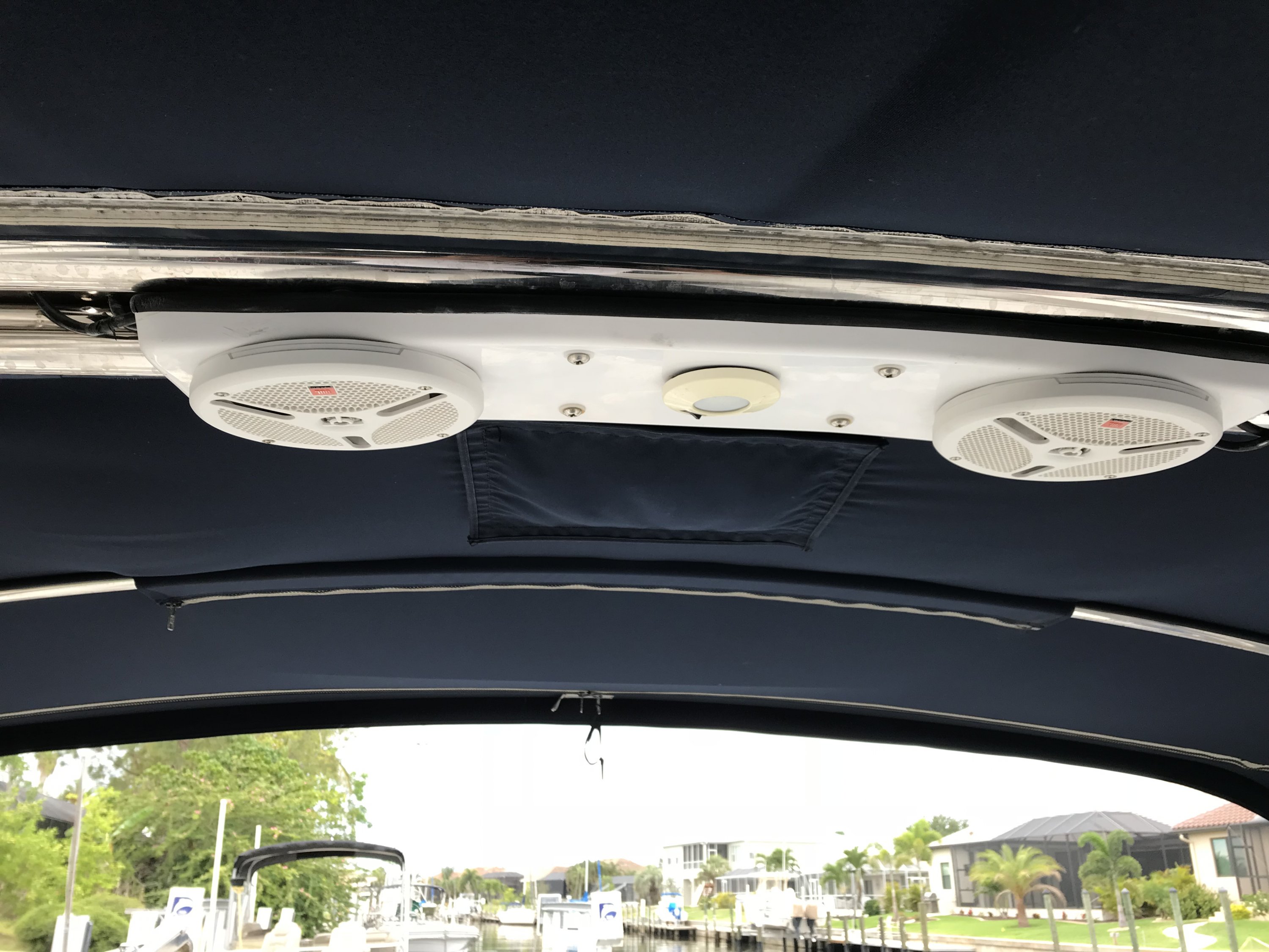

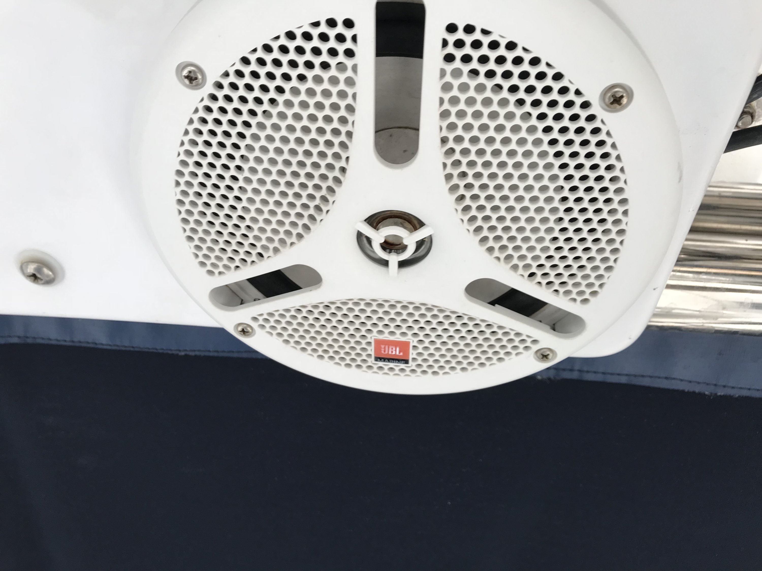

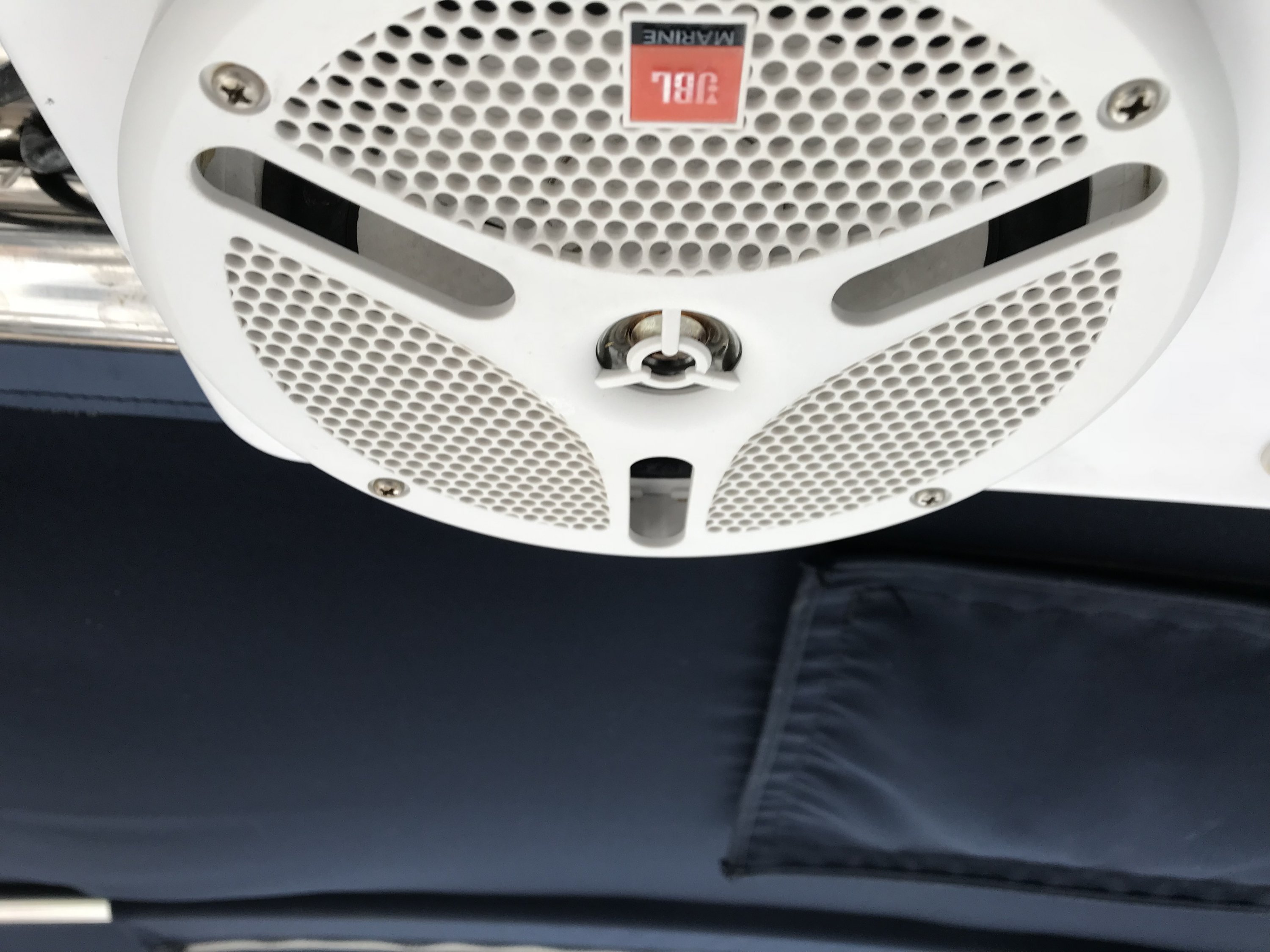

I will look at what speaker I have but in 2008 I sailed down from NY to Fl. mostly out in ocean not inside only 1 day inside but anyway the boat had a 1 inch coating of salt on it and a week later the speakers stopped working and what happen was corrosion had destroyed the wire connection on the speakers and have had I think JBL speakers I think and they fit perfectly and will take photo today and they been working just fine.
