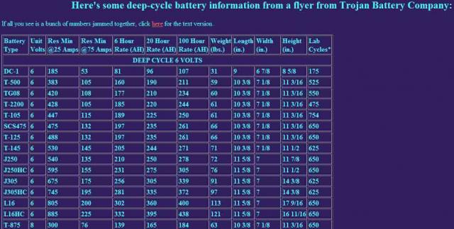

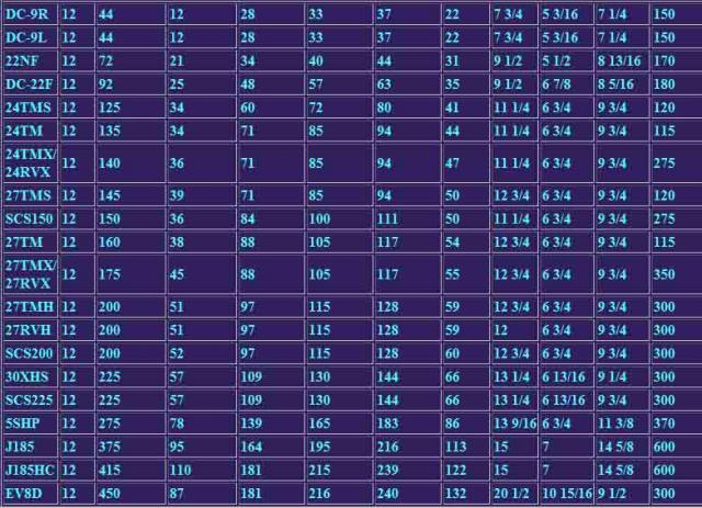

How long did the T105 batteries last? They are among the longest lasting batteries available and very affordable. They will withstand more cycles to 50% discharge than even any other Trojan battery. Definitely the best bang for the buck for a few minutes a month maintenance. Below are two charts from Trojan showing in the right column cycles that they sustained in testing.
Brian

zeehag - that is pretty normal from people I've talked to. Trojan rates T105 at 754 cycles while with only a couple of exceptions their 12 volts average less than 300 cycles - and all Trojans are pretty good batteries.
Brian
