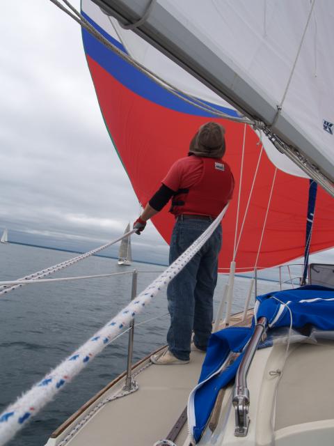

So I'm thinking of replacing the exterior wood with composite decking material. My boat has a molded fiberglass toerail with a trim cap strip of teak. It looks nice when finished properly but it's time to either refinish it, strip it and let it go natural, or replace it with something different. I've been doing some testing and I'm leaning toward ripping strips of composite decking from TimberTech (timbertech.com). They make one called Tropical Teak that has a warm, varnished look. I made stair treads for our swim ladder four years ago and they still look great. My thought is to rip the strips at home, rout the edges to match the existing profile, then bring my benchtop drill press to the boat and use the existing caprails as patterns for drilling the new ones to match up the hole patterns on the boat. I was thinking of using butyl tape for bedding. You can see the toerail in the photo, it looks better in the photo than it does in reality. Any thoughts?
