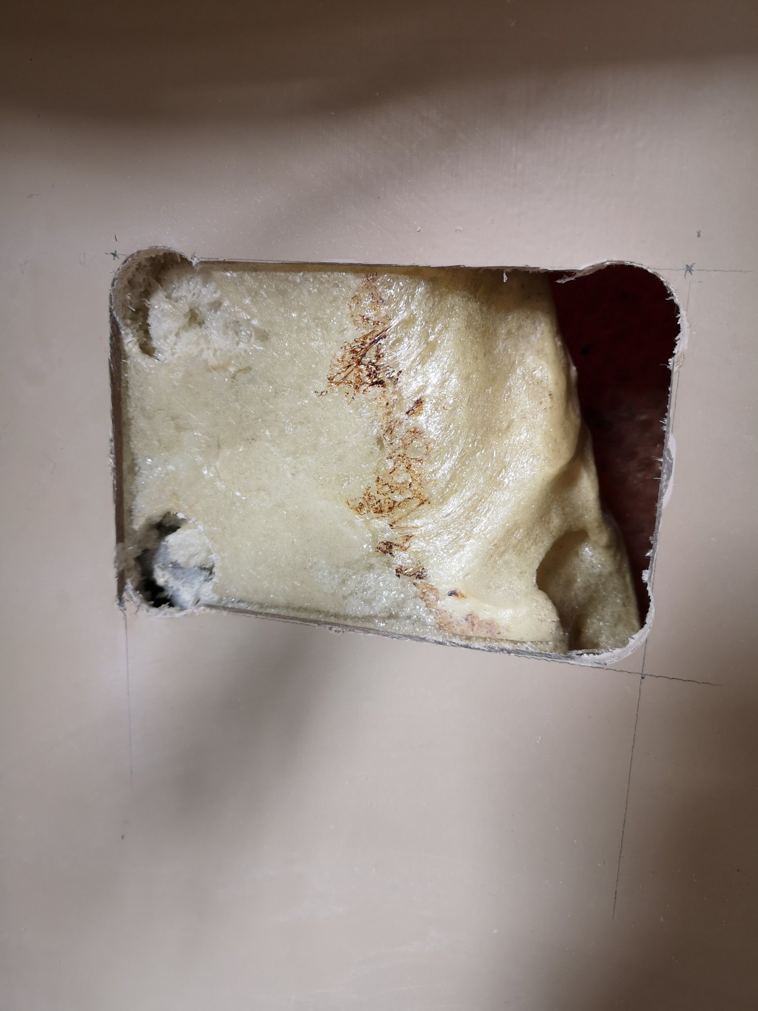

Is the loop necessary? I don't think mine had a loop but I can't really tell because they filled the whole area with foam which is a an absolute nightmare

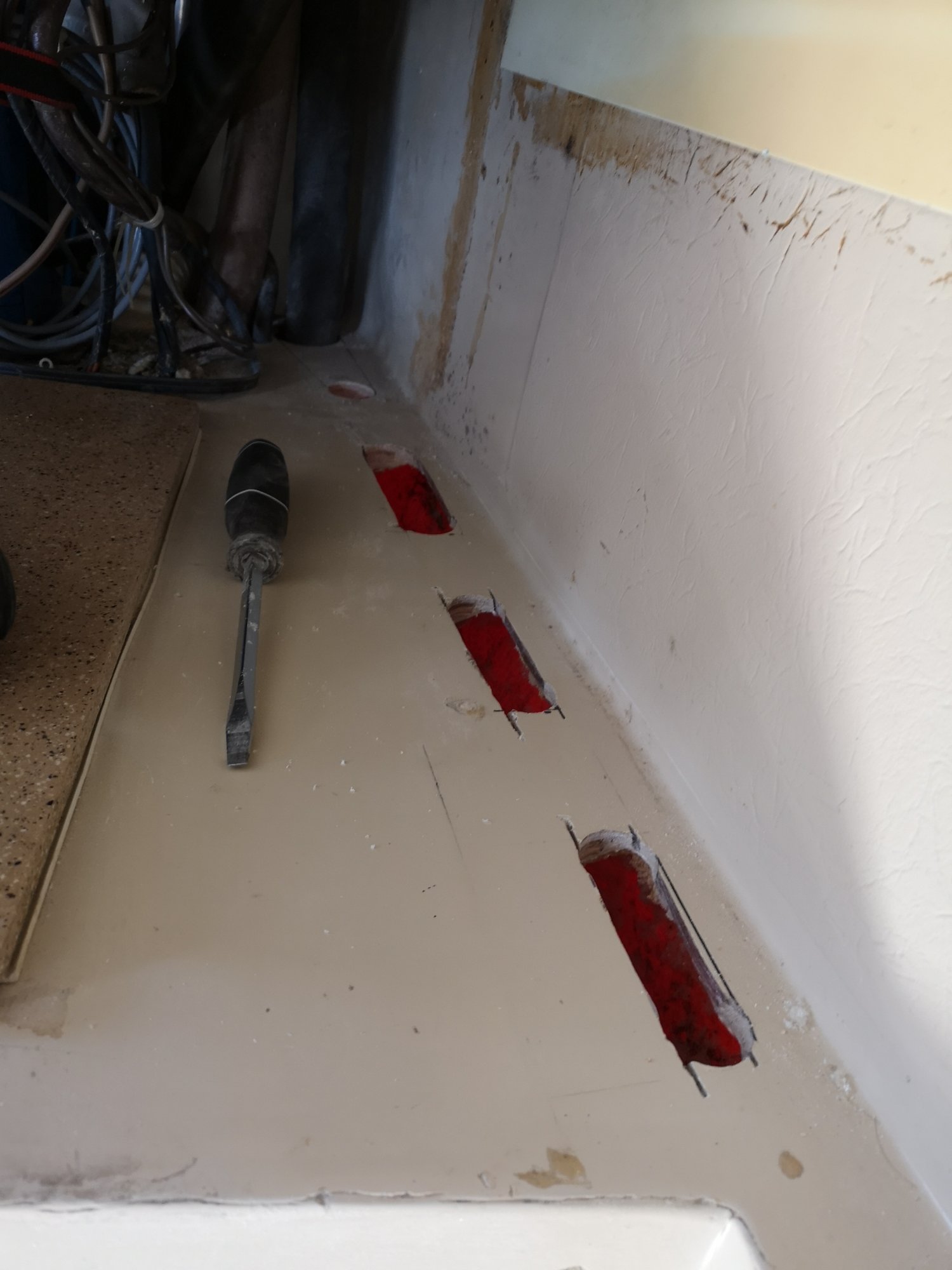

I've just been cutting holes along below the counter and using a flathead and my hands slowly working foam out, I'm going to need to drill a new hole for the new hose though as the angle would be too much, so instead of coming straight up out of that area it will come out sideways.
