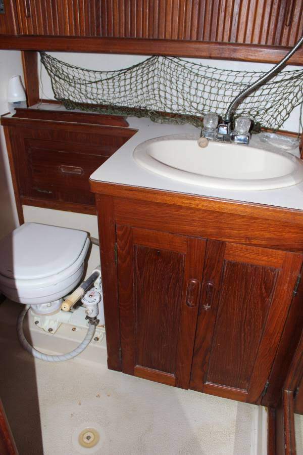

Replacing entire head, toilet, hoses and holding tank. 1977 Endeavour 37, Any recommendations on brand, (elec or manual) and model and size of holding tank? Need to make it a better experience for wife.

Hi Peggie, so good to hear from you. Chesapeake is our primary cruising ground. but plan to take a trip to FL and south next fall. 37 foot Endeavour. 1977, would like to upgrade to electric. budget is enough to cover all options. bob at banksfineart dot com
