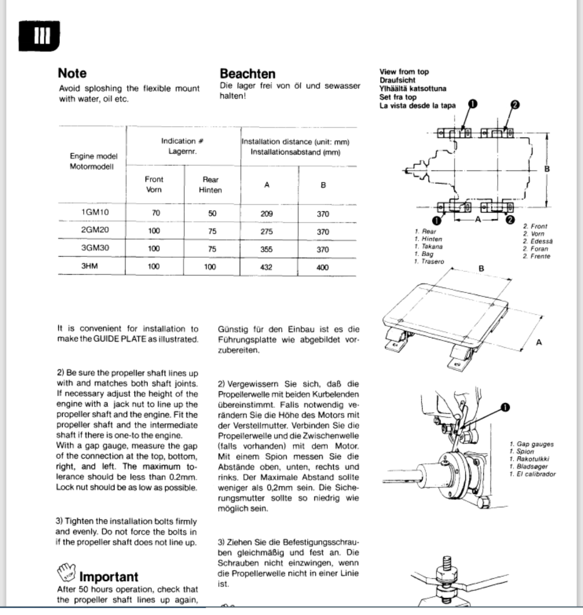

Update....DANG. I feel I work hard to ensure I do things right. I talked to others and solicited information about mounts for my 3GM30F. Even the engine mount website confirmed 100 for the front and 75 for the back. I just pulled the back off and they are 100 also. Can anyone confirm the '86 H34 with a 3GM30F had 75 mounts on the back? I guess it's possible a PO (for whatever reason) changed the back to 100s. I need to determine if I'm okay putting the 75s on.
TIA.

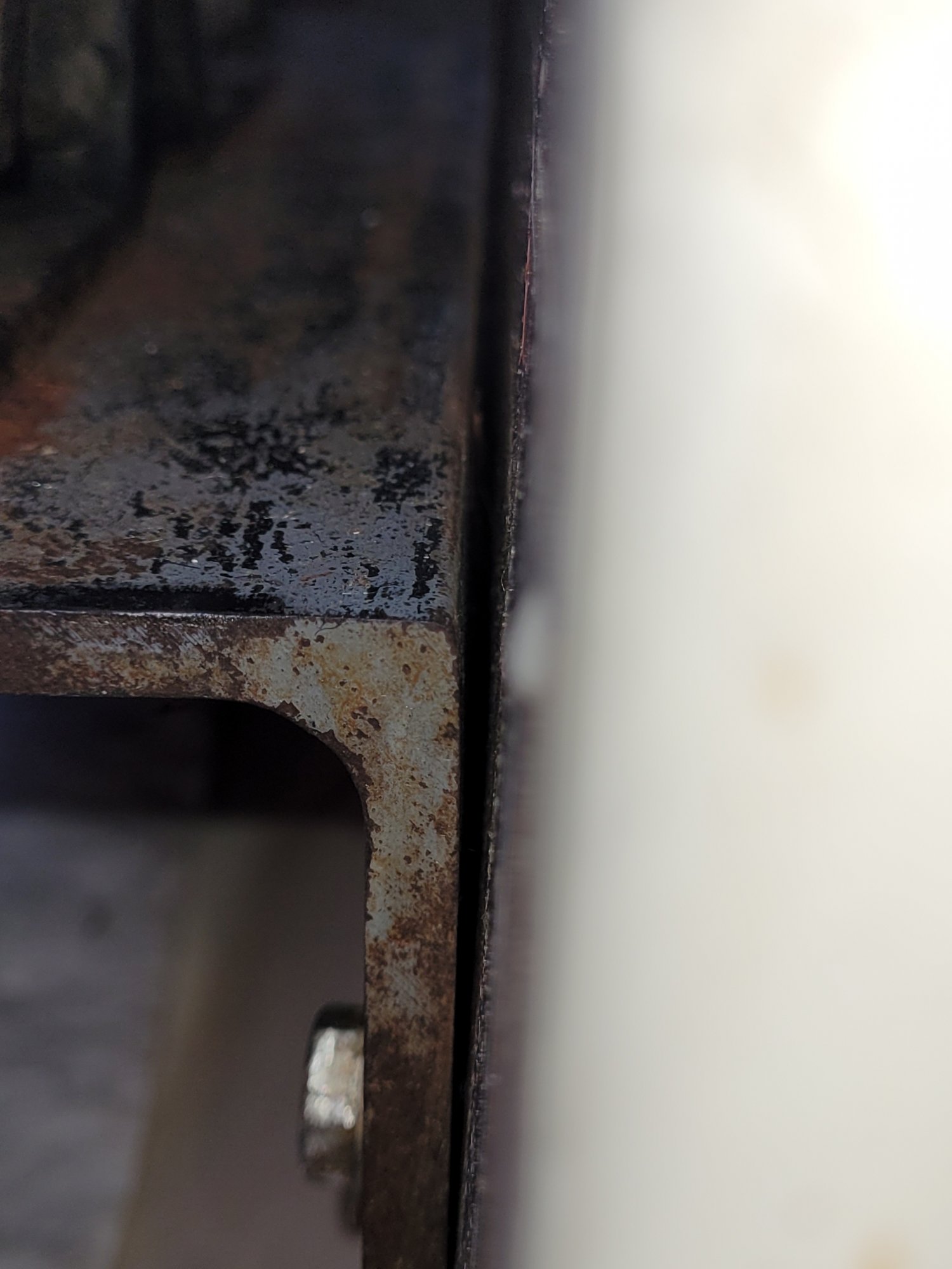

So, I have this problem, but I also have another problem. The bolts holding my angle iron on have loosened from the years of vibration on bad mounts!!!
You can see the separation between the angle iron and the bolts on my port side. Its almost an 1/8" at this point and getting bigger as it continues to loosen.

I ran into this problem and had to remount the angle bar. I ended up removing a 6 inch high panel in the aft berth. behind the doors. eventually I'll replace it and add a thin teak strip to cover the cut.

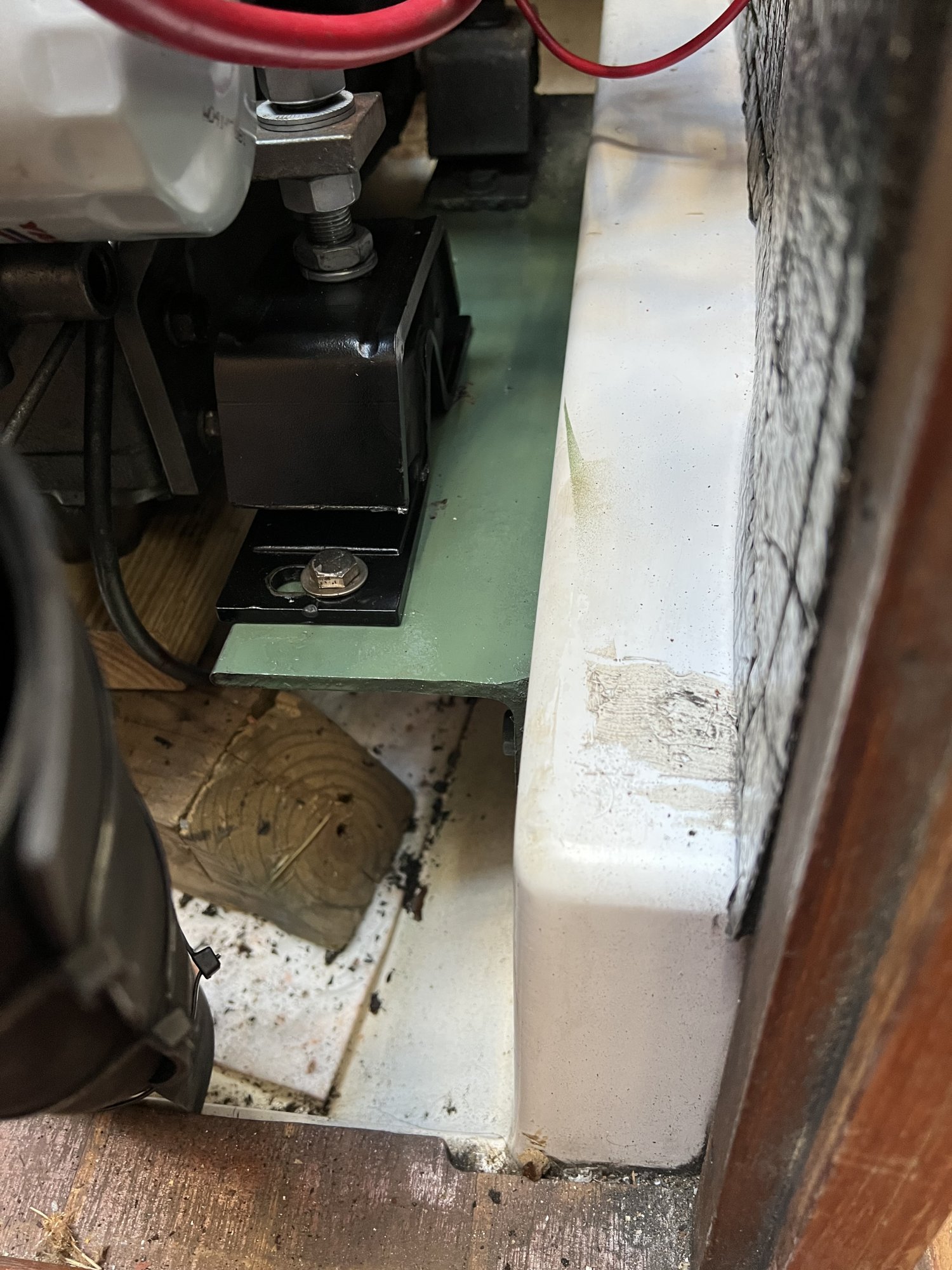

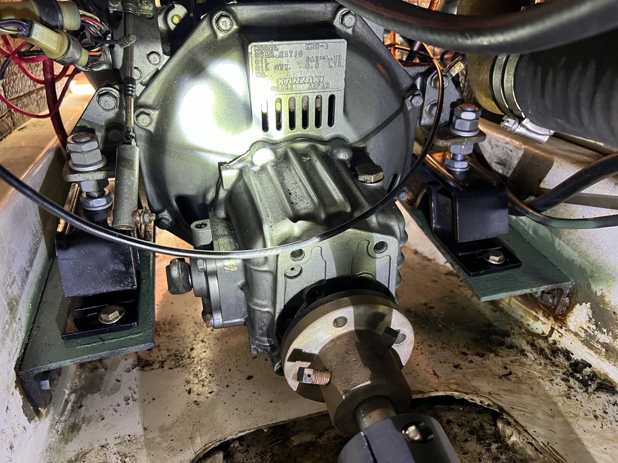

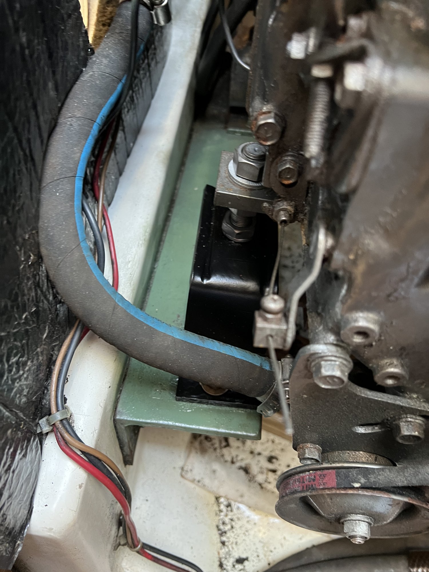

Completed. Took a little time to spruce up the angle iron brackets with some Yanmar green.
