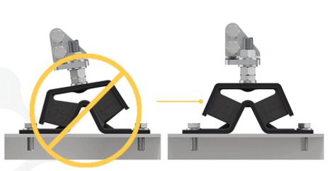

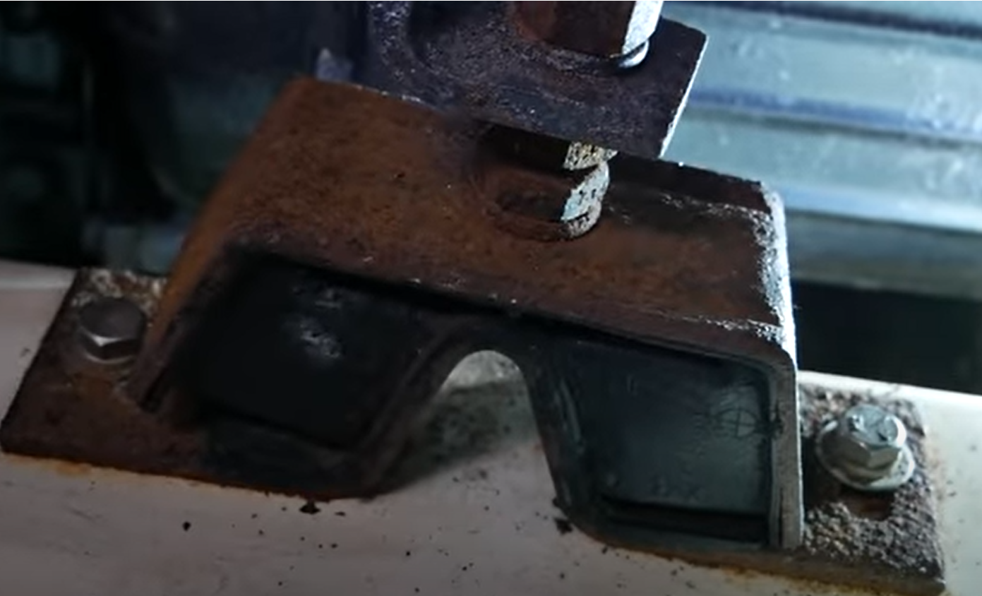

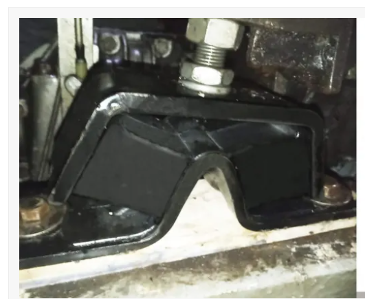

A timely topic. I just watched the youtube channel Jibsea sailing's latest video, change his engine mounts. The issue he did not mention was the HP42 engine is tilted and the mounts are flat. This violates the mounting instructions resulting in what mine and his look like, extremely tilted with the metal on one side touching the base. The question I am pondering is how to remedy this when I replace mine. I am thinking a shim wedge of some sort underneath the mount. A figerglass board like G10 sanded into a wedge and coated with epoxy would be easier, not sure if it would be strong enough. Aluminum another option that I would have to have fabricated. Any Ideas? I am surprised none of you have had to replace yours given this tilt will wear them out sooner.
