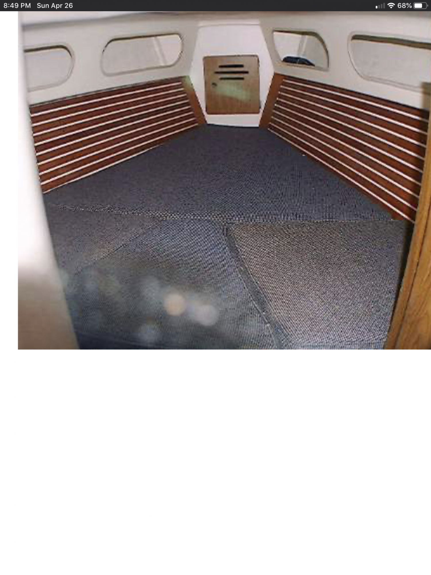

Like everyone, the foam backed vinyl on our 93 351 Oceanis is detaching. I came to Beneteau via Pearsons and the Island Packet over last 45 years. Particularly in the Pearson community, there was a strong push to pull the fabric and install slatted wood in forepeak. I think they are called “ceiling” strips. Has anyone done this in a Beneteau. Great room for insulation behind the teak strips. This is not the prettiest picture, but probably reflects my level of carpentry.

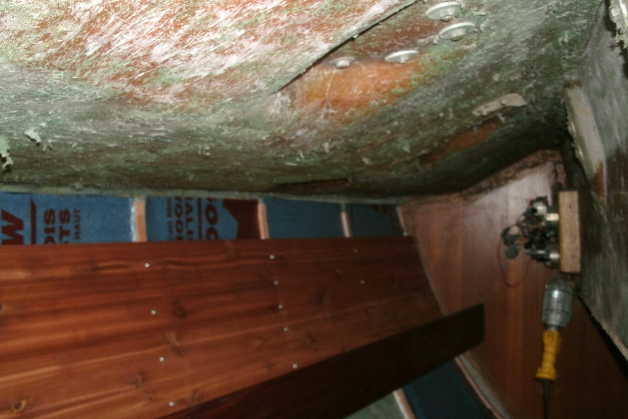

GEDC0141.jpg This is the only photo on this computer. Still under construction. I used tongue and groove cedar and stained it.

We are planning to do the same for our 84 Beneteau First 38. Instead of using teak we are also considering using a composite (plastic) ship-lap. Perhaps less weight and no mold/rot. Also we may be be "whitewashing" instead of staining to lighten up v-berth and aft-berths. Previous owner had used carpet adhesive to attached marine grade carpet - which did not sag but has been a big PITA to remove. So far all of the marine carpet &/or vinyl headliner is removed. I think your work looks quite good!

Where did you source the cedar? Looks like you installed battens to the hull with insulation between. What did you use to attach the battens to the hull? What did you use for the battens? Any issues with moisture or swelling/shrinkage?

Hi John, I got the cedar from Sleggs in Sidney, I know Home Depot carries it as well ( at least in Canada) I used 1/2 X3/4 fir strips glued on with 5200. I put kerfs in my battens but still had to but braces them to hold things while the glue set. No issues to date.

I put kerfs about every inch on the battens and still had to brace them while the glue dried. Was thinking that next time I’d use small blocks glued in a row. Always a learning experience!

Here is a post from Don Casey on what we are talking about.
