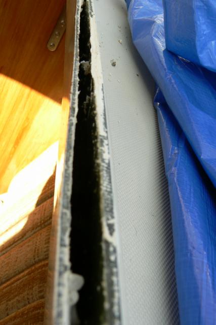

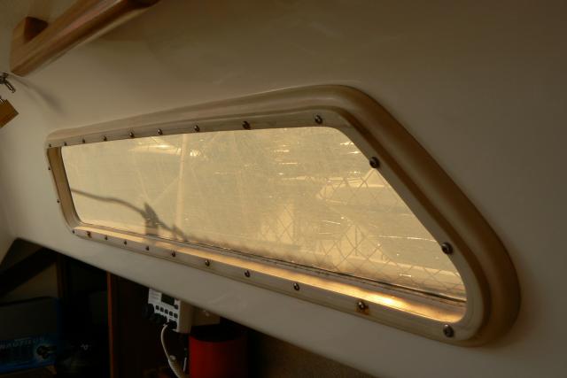

I’m replacing my fixed saloon deadlights (side windows) with 6mm (1/4”) tinted Plexiglas acrylic and am looking for any thoughts / advice. The existing factory deadlights are about 1/8” thick tinted acrylic held in plastic frames with a pressed-in rubber gasket. The flanged frames are inserted into the opening from the outside and sealed with what looks like white marine silicone. A plastic trim is screwed to the inside of the frame to clamp the assembly and to finish the inside appearance. The cabin wall fibreglass is 0.18” thick with a 1/4 “ air space between it and the headliner fibreglass that is about 0.12” thick. I’ve had new tinted acrylic cut one inch larger than the opening with twenty four ¼” diameter holes drilled ½” from the edge at about 3” spacing. I plan on inserting a ¼” wood shim into the air space between the headliner and the cabin wall and using Butyl tape to seal the Plexiglas to the cabin wall. The assemble will be though-bolted with 10-24 x 1¼” S.S. button head socket cap screws from the outside, fender washers on both sides and Nylock nuts on the inside. I will probably use white marine silicone to finish the outside edges.
What are your thoughts?

II’ve had new tinted acrylic cut one inch larger than the opening with twenty four ¼” diameter holes drilled ½” from the edge at about 3” spacing.

- I am aware of this, that is why I'm planning on cantering the 10-24 machine screws (0.20" diameter) in the oversize (0.25" diameter) holes.

Our boat came from the factory with the drilled & bolted acrylic side windows. They have lasted 28 years, so I guess that means the holes are large enough to avoid problems from expansion and contraction.
One previous owner had remounted the windows, but I think they used house caulk or similar as sealant, and the seal area had become all dirty and mildewy. Looked like hell.
My wife and I removed the windows. The acrylic and the cabin cleaned up nicely. We remounted the windows, this time using clear silicone as the sealant. As each screw was added and fastened, we stuck a toothpick between the cabin and acrylic, to maintain a 1/16" gap, and only lightly snugged the screw to the toothpick.
After 2 days we pulled out the toothpics and lightly tightened each screw a bit more.
This has remained waterproof for two seasons so far.

Thank you Maine Sail, I looked at Select Plastics web site and that would definately be the way to go if I had reusable metal frames and lived a lot closer to them. Thermal expansion is not a big issue here in south-western Canada as our maximum temperature swing is less the 30deg C (50deg F) and this port is about 3 feet long. My previous Hunter sailboat had ports about 4 feet long and the Acrylic came from the factory glued and screwed (oversized holes) to the flat cabin side. I will let you know how the project works out.
