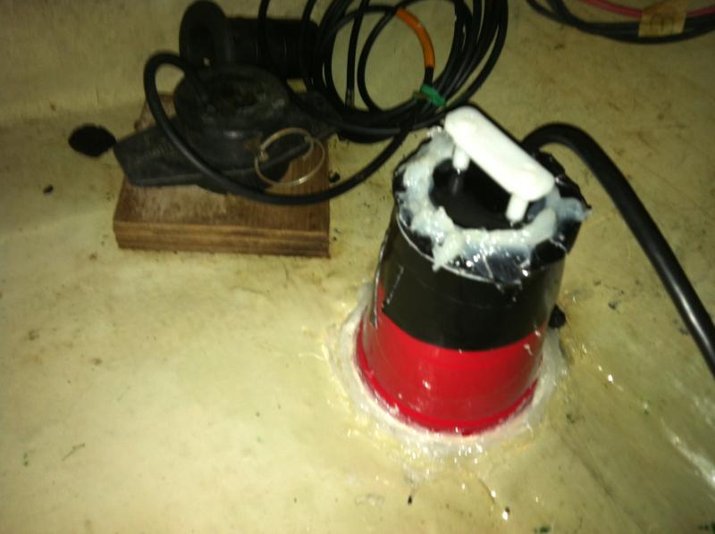

1. Clean inside of hull where you plan to put transducer. Use Scotchbright and acetone.
2. Attach wiring of Moor electronics depth finder so that you can test transducer.
3. Put a large glob of vaseline on the transducer and then test the hull area for good acoustics. Vaseline is really easy to use for this purpose and, as discussed below, a good predictor of your water box performance. Mark the spot where you got good readings.
4. Get an 18 ounce red plastic cup-the kind the college kids use at keg parties
5. Cut out a round part of the middle of the bottom so that the transducer will fit there later.
6. Epoxy the cup rim to the hull.
7. After it has cured, use silicone sealant around the epoxy.
8. Fill the cup with mineral oil. As turns out, this is a petroleum product which has great acoustic properties. Vaseline is rather similar, so if it worked with vaseline, it will probably work with mineral oil.
9. Insert the transducer and seal it with silicone.

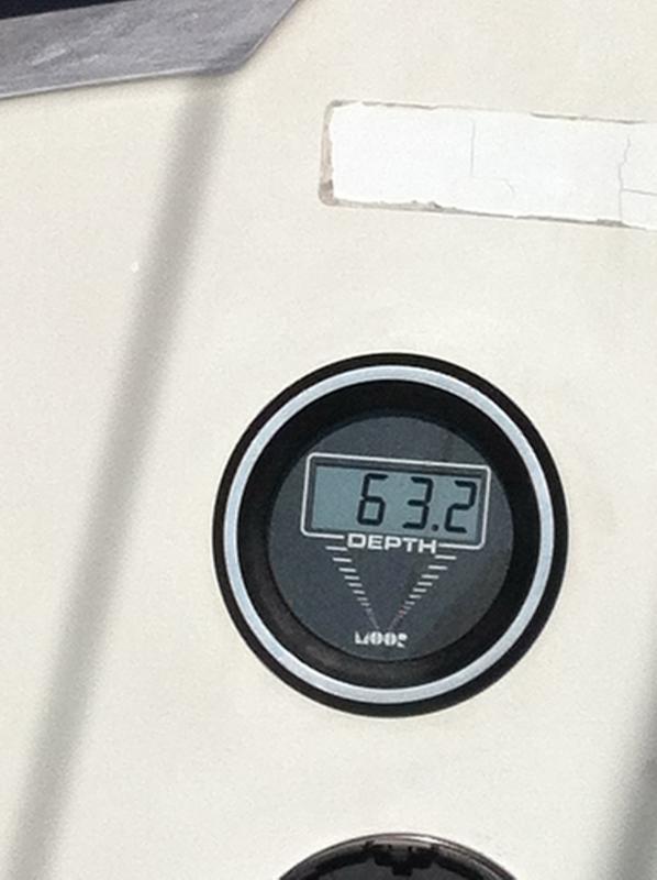

10. Enjoy your new depth sounder.

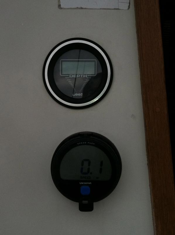

Also, for the speed, I got a speedpuck and used commercial velcro to attach its holder over the old one. The speedpuck is terrific. Now i have depth and speed without dealing with holes in the hull or fiberglass repair.
The only question is whether the mineral oil will eventually degrade the silicone. I called 3M requesting advice on what to use instead and they said to wait and see because they think it might be OK.
I attached photos.
