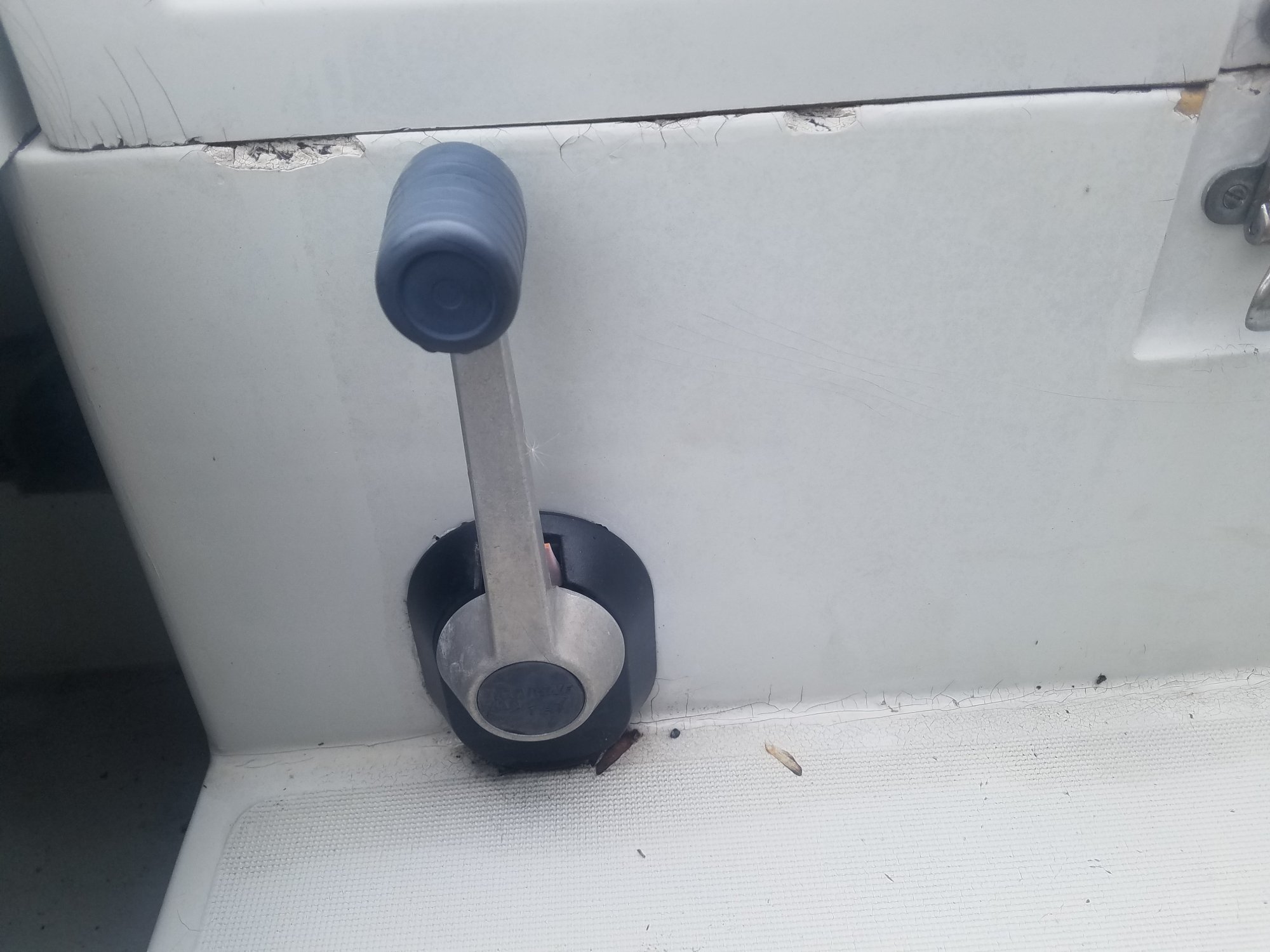

Need to replace a broken throttle on a 1984 Elite 29 (aka Feeling 850). Current one is a "Marine Master." Has anyone replaced a throttle and if so, any wisdom you might be willing to share from replacing it will be greatly appreciated. Thank you.

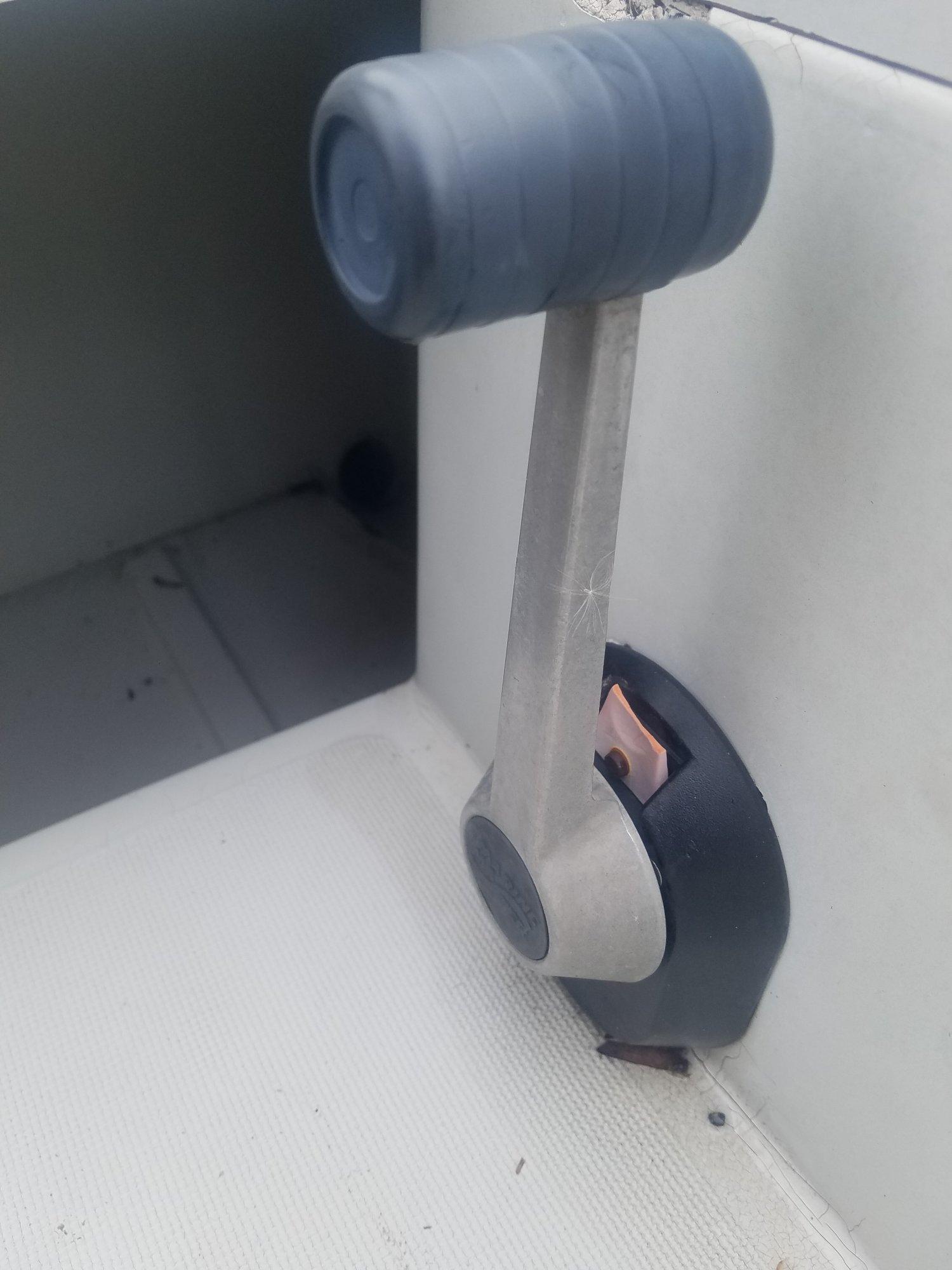

Throttle issues are often linkage problems. Something has come loose or worn out. You find the issue or issues and tighten or replace the part. It may be in that box with the single screw holding the cover in place. That screw looks newer than the surrounding material which leads me to guess someone has removed the cover in the past couple of years.

It looks like your access will be quite good (remove the housing inside the locker). I don't think the cables are necessarily proprietary and may well be Morse anyhow. If you're certain it's a broken cable (not just a loose/parted linkage) it's likely you can buy a suitably long replacement.
If the lever assembly is somehow damaged that's a completely different story....

Thank you both for your responses. Fortunately, the mechanical linkages are working fine. The problem is with the throttle column itself. The lever that engages/disengages the clutch apparently broke off with the previous owner. You can force it with a thin blade but obviously replacing the throttle column switch would be optimal. Given the age (guessing it is OEM from 1984), I'm thinking it will be easier just to replace the entire throttle assembly.

..... Given the age (guessing it is OEM from 1984), I'm thinking it will be easier just to replace the entire throttle assembly.
I think you're on the right track there!

Edit: Is it just the red 'neutral' switch that has broken off?? You might be able to fabricate something for that function....
