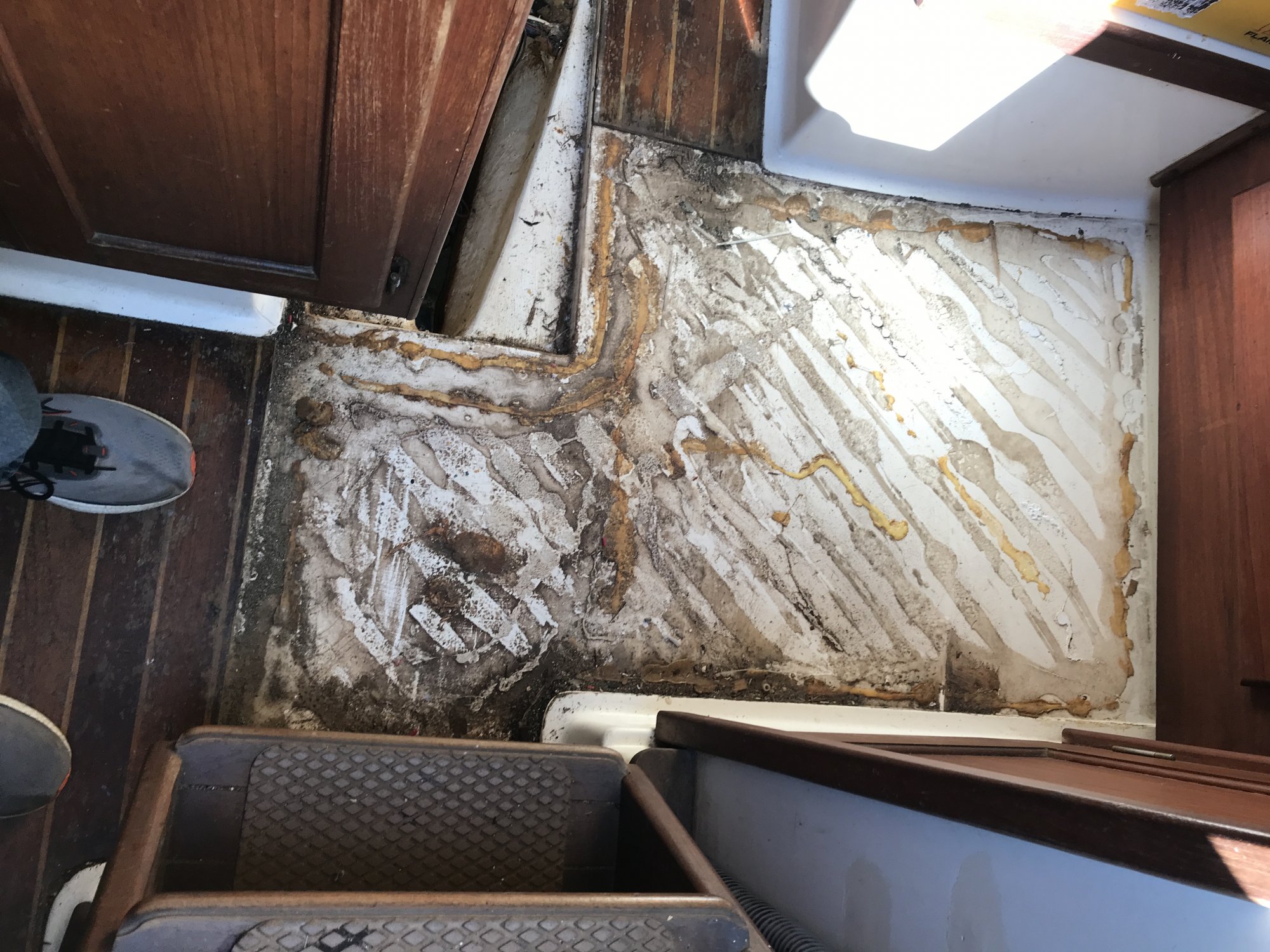

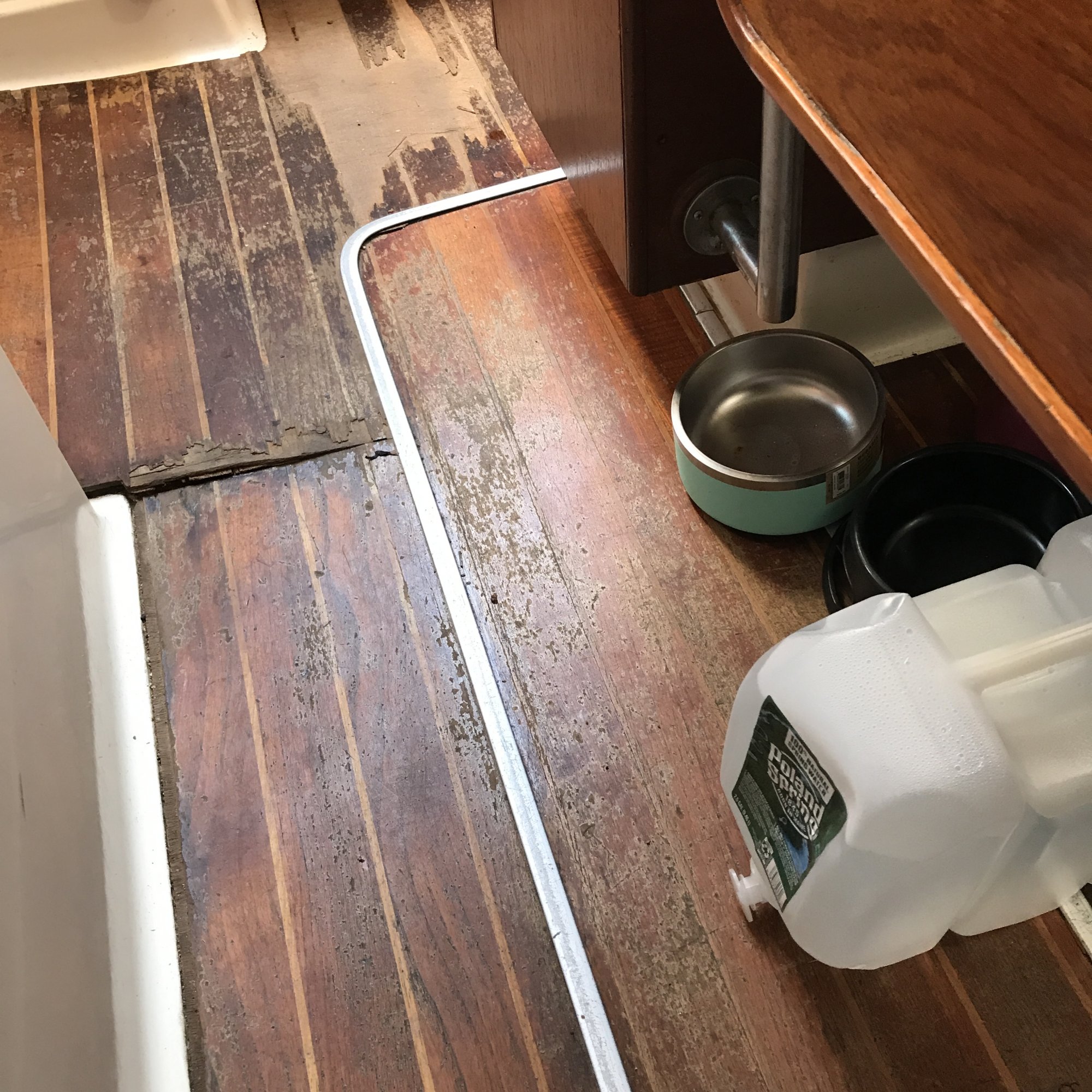

The cabin sole in my forty year old boat needs to be replaced. Spent yesterday tearing the old Teak and Holly plywood out. What I found underneath was silicone caulking that was spread out in a haphazard fashion to hold the plywood to the fiberglass liner. I intend to install PlasDECK flooring in place of the old plywood. PlasDECK is installed with a glue supplied by the manufacturer. My question is how do I completely remove the old silicone? It can be peeled up with a putty knife or similar tool but my fear is that it is still embedded in the fiberglass. Nothing will stick to silicone and I am worried that my new floor will lift. Any suggestions on how to completely remove the silicone?

Have you considered a composite material that is the approximate thickness of the old plywood sole. You could screw the new decking to the liner, so there would be no issues with any adhesive bonding because of silicone residue. Also, if you ever need to run new plumbing or wiring, it would be much easier to unscrew the flooring rather than ripping it up. The flooring on my Beneteau is screwed in place and it is easy to remove for accessing & cleaning the bilge areas. Amazing how much crud & critters build up in those areas and I have a dry bilge mostly.
My question is do you really need or is it even possible to remove "all" of the old silicone including the residual or embedded silicone in the fiberglass? Ideally yes but absolutely necessary???? This is a quote from a webpage discussing this issue (link here). I would definitely touch base with PlasDECK support to see what their advice is.
"At least chemically speaking, it is theoretically possible that silicone adheres to silicone, but the basic prerequisite is that the silicone sealant on the same chemical basis. This means that the old silicone joint must be on the same type of crosslinking as the new silicone.

I worked through the same situation a few years ago. Looked almost identical to what you've posted above, including what appears to be a myriad of different adhesives. After trying a few different approaches, a rubber mallet and very sharp 2" chisel held at a shallow angle made short order of what you're looking at. It left behind a smooth surface with just a residual tackiness in a few spots. For the most part, that cleaned up with acetone (at least to the touch). It's inevitable that chemical traces of the previous adhesives will be left behind (even if you can't feel it). As already mentioned, you could try sanding the liner after removing/cleaning the existing adhesive, but there will always be something left behind.
I'm with @Hello Below. If silicone was used you won't get it all off, but I'd be surprised if the residual traces result in bonding failure of the new flooring. If you look closely, you'll see a lot of naked surface area in between the existing beads of adhesive. That's the original liner and hasn't come in contact with other adhesives yet. If applied thoughtfully, the new adhesive will bond to at least those surfaces provided they are clean and dry (and the temperature is warm enough). I would lay up one of the smaller sections of new sole first and evaluate over the Winter/early Spring before going all out with the rest of the new installation.
Good luck. It's a fun project and the results are something you'll enjoy every time you go below decks.

Yesterday I finished prying all the old plywood up. After that I invented a simple test for the presence of silicone. I placed a piece of masking tape onto an area with obvious silicone residue. The tape had absolutely no adhesion. I took a razor blade and carefully peeled off the residue down to the bare fiberglass and placed the tape down. Only slight adhesion compared to uncontaminated fiberglass. I took the paint stripper grinder disk by hand and sanded the peeled area until the fiberglass felt clean. The tape adhered much better. Not a very scientific test, however it does prove that cured Silicone will certainly prevent anything from sticking to a contaminated surface. As for a contaminated surface remaining after grinding, due to the disk transferring the silicone, we will find out soon. After I scraped up all the Silicone residue with the razor blade, I had reams of the stuff in the form of shavings. I put a few ounces of the Silicone shavings in a container with denatured alcohol and another sample in a container with acetone. After soaking overnight there was no change to the Silicone in either solvent. Regarding Dow's DS 2025; I watched a video on that chemical and they recommended soaking the contaminated part overnight. This is obviously not practical with a boat sole. It is doubtful there is any chemical that could be wiped on and then wiped off and have any effect against the amazingly indestructible Silicone. Grinding today. Thanks again for the suggestions.
