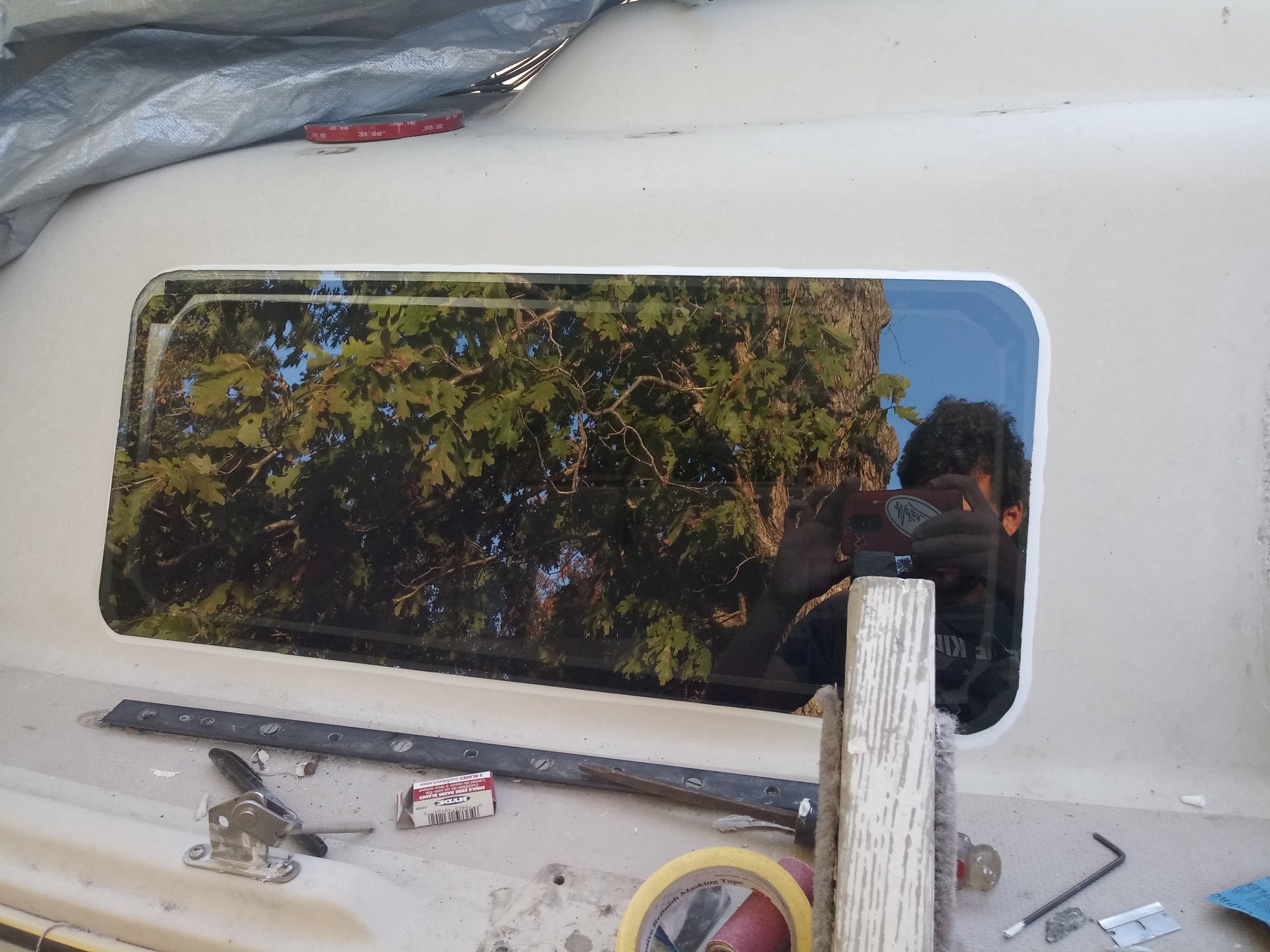

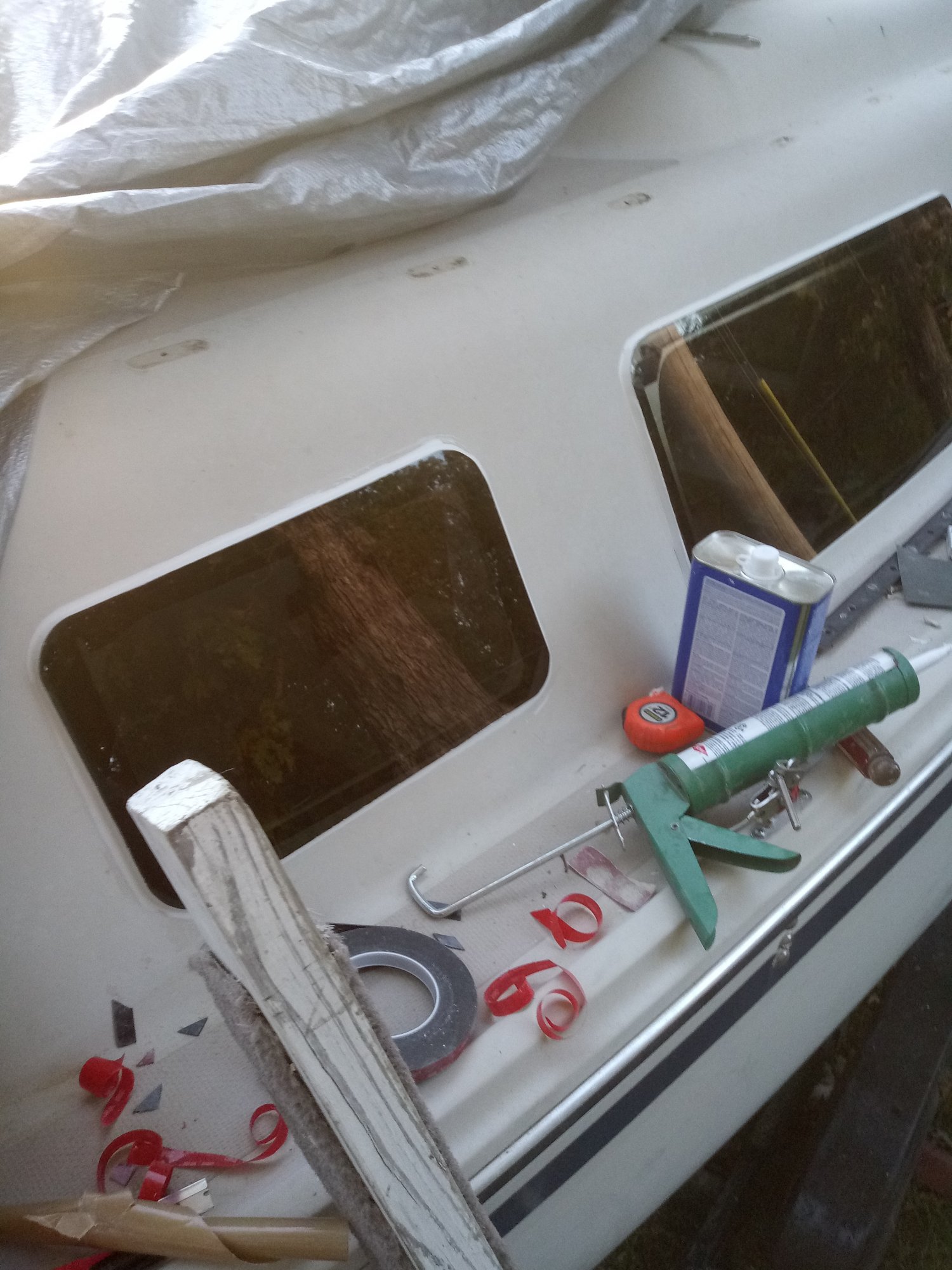

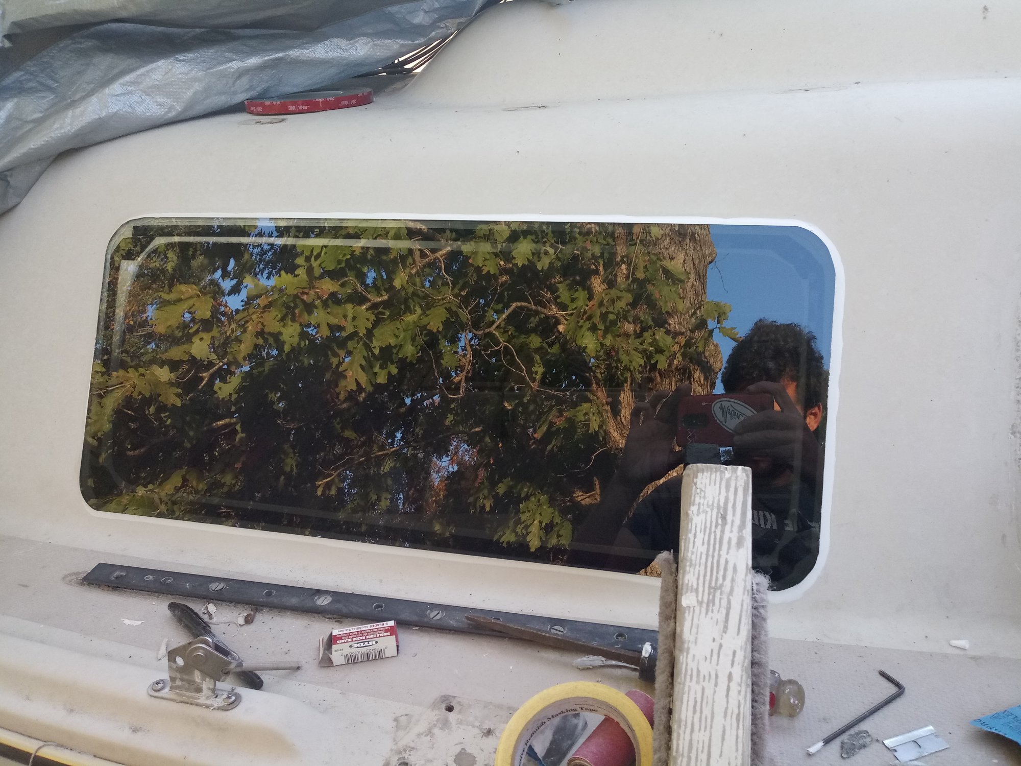

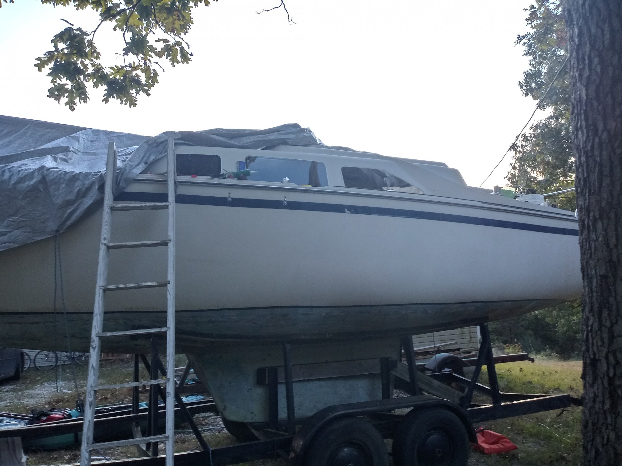

Is this what you are going for? I did this on my Laguna. I cut them out if a sheet of 1/4" cast acrylic. Mounted them with 3M VHB tape, and bedded them in with Dow795.
I think the total cost was $120 to do 4 Windows.
You can do the straight cuts on a table saw and round the corners with a bandsaw.
Pretty easy job really. I recommend running one continuous piece of tape if you can, and put the seam ay the bottom, just in case your caulking fails.
Message me if you have any questions.
