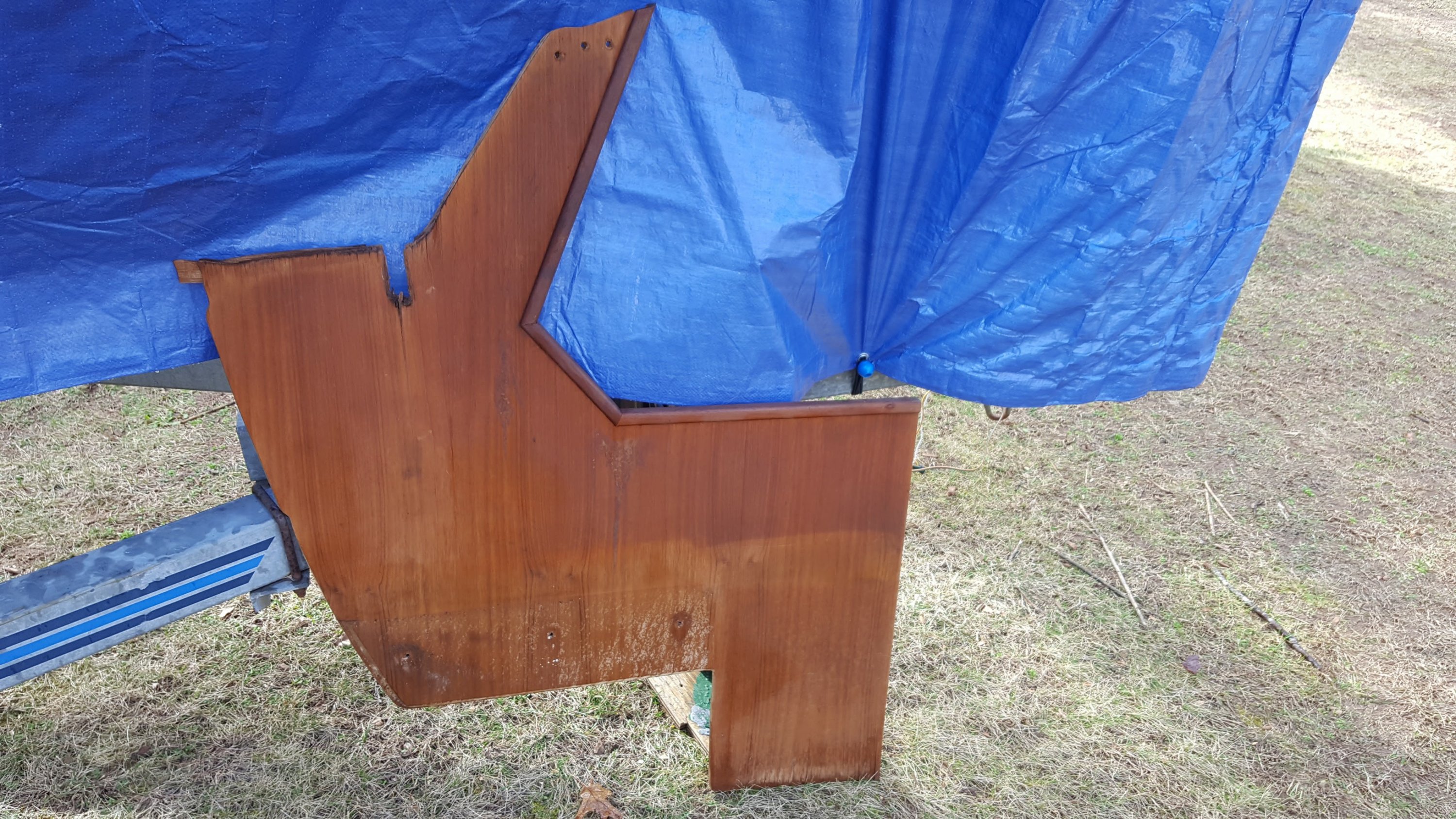

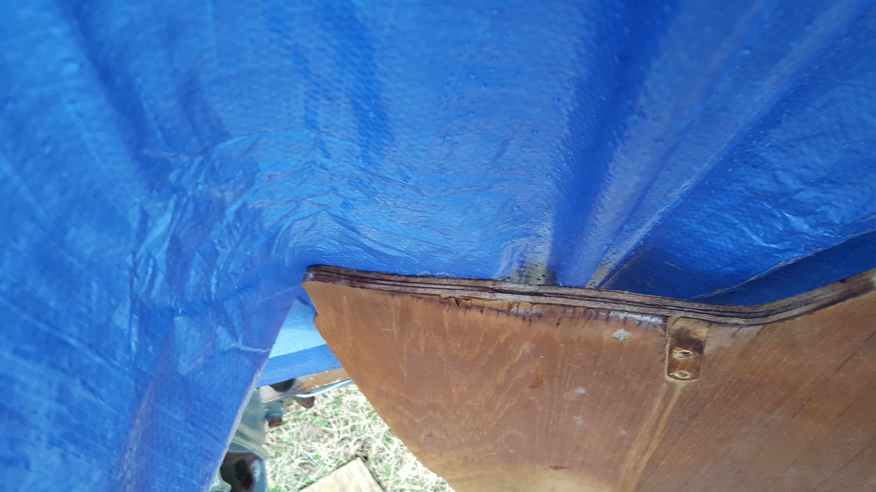

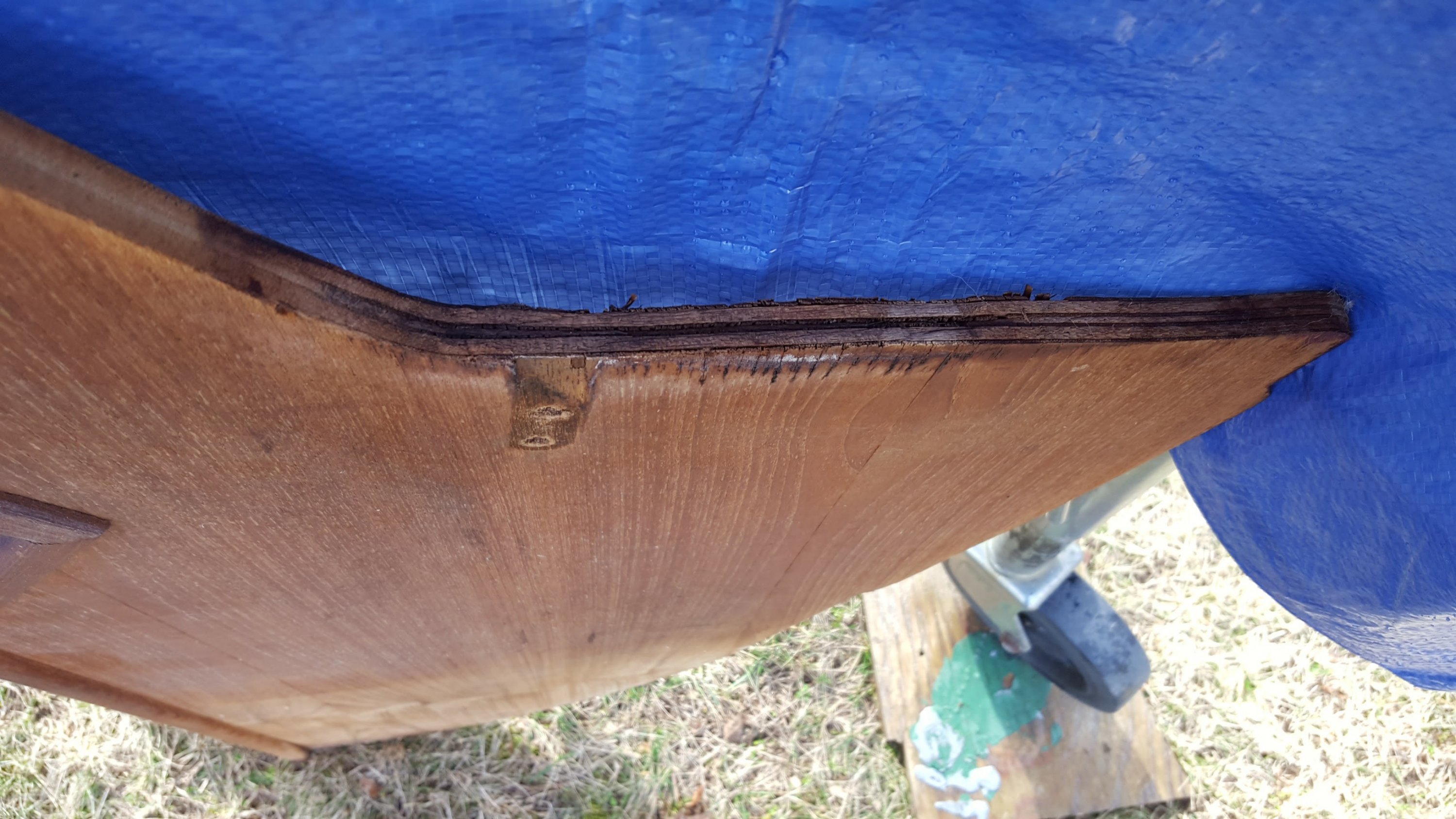

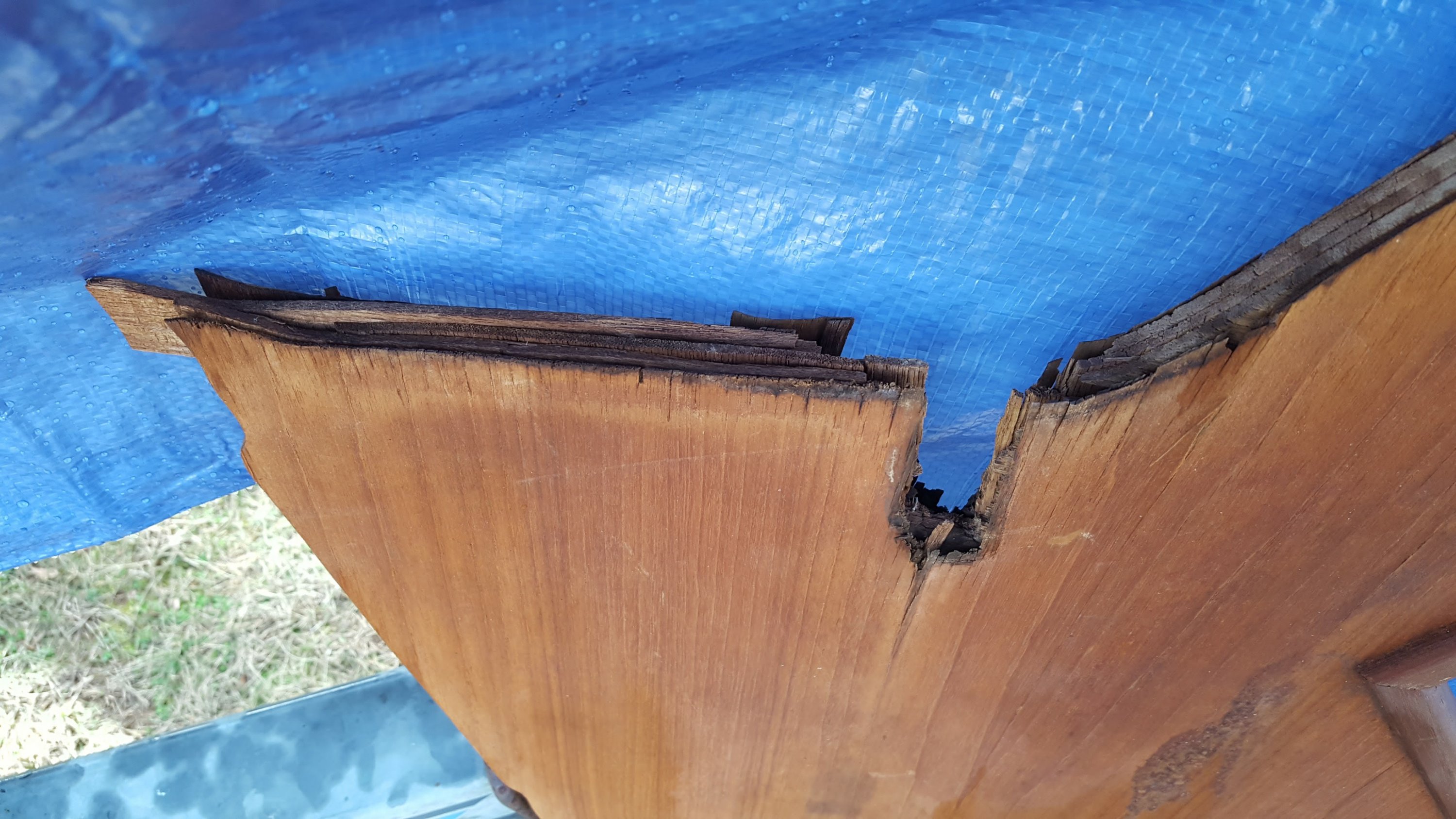

The weather cooperated with unusually warm weather here and I was able to remove the rotted bulkheads on my new to 1984 O'Day 222. I'm thinking Okoume or Meranti for the new bulkheads. Any thoughts on what is better?
Here are some photos of the rotted bulkheads.

I just did my 84 222 last month andusef marine grade A grade plywood. I was going to veneer it with teal but never got around to it. Worked out well

DJ, I'm doing the same job to my 222. Take a hard look at the chainplate penetrations because I'm pretty sure you'll find a soggy core around the penetrations. I think I've got to cut out a section of deck almost the full width for about 30". If enough water got through to rot the bulkheads, you can be pretty sure that it weeped into the deck core material as well. This is even more problematic in a cold climate where the soaked core freezes and expands. It doesn't take many cycles to create a much bigger job than planned. Good Luck
