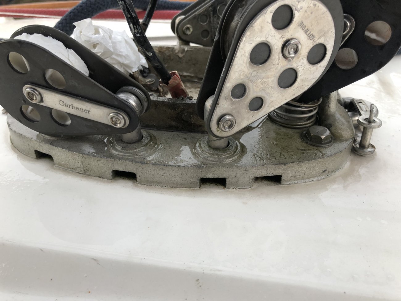

[QUOTE="Canonshooternb, post: 1511253, member: 106608... Also whats the easiest method to replace them ? Do i have to unbolt the mast step in order to replace ?[/QUOTE]
They are built like the Beneteau blocks. Without lines through the block, you should be able to unscrew it CCW from the bolt that is in that notch on the bottom. Leave the nut to replace the block, or get a fresh one. BaconSails.com has 4 or 5 of those blocks(grey) . The stud is 3/8 or larger- maybe a 1/2? I can look for the price/size this week. And the cost. I'm very sure they are used, but they spin. I was thinking of upping the size of mine with them, but those would not fit my mast step notches/bolts. I'm sure you could get them from the Beneteau parts site if you want new or to get a cost estimate. Someone on the forum just got a battery switch from B, so maybe could look at a B 36 to get an appropriate sizing?

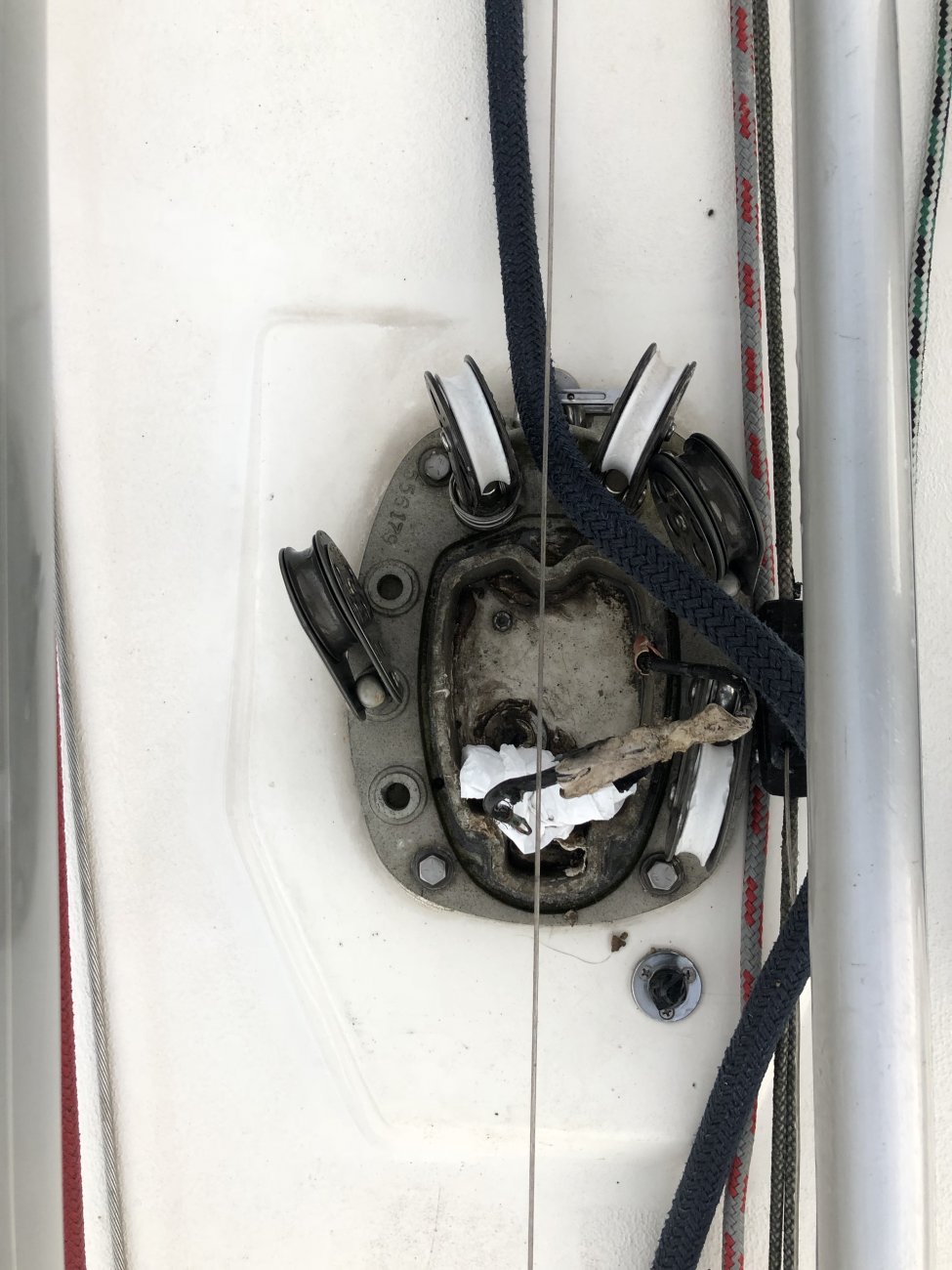

would you mind sharing a better top-down picture of the wiring through the deck?? would help with a project I'm working

Ours are Garhauer blocks, which look similar to yours. Replaced the reef blocks a few years ago with the same brand. Our sheaves were shot. No need to unbolt the step plate. Our blocks are what they call open end. That way you just remove the ring clip, slide the pin out and replace with the new block. The stud that extends through the plate does not change.
Unsure about the size, but maybe 2.5" in diameter. I sent this picture to Garhauer along with the dimensions and they sent the right block.

Thank you for posting the top-down picture! very helpful. We are removing our mast for the first time since we've owned the boat this weekend, to install a Raymarine wind vane wire, spreader deck lights and inspect the rigging.
