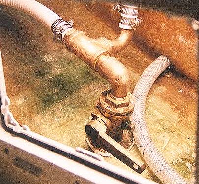

I was also planning to T the sink and head intake. I'm curious how people have actually done this? I cannot find a marine bronze hose T, there are no Marelon T's and a Google search for images turns up nothing.
I finally found one picture that showed a threaded T attached to the thru-hull valve with a coupler and then two bronze hose barbs threaded into the other two holes. Looked pretty "clunky" but regardless, the four local marine stores I checked do not have any threaded bronze T's (nor did they know where to get them). Not sure how to properly do this?
I finally found one picture that showed a threaded T attached to the thru-hull valve with a coupler and then two bronze hose barbs threaded into the other two holes. Looked pretty "clunky" but regardless, the four local marine stores I checked do not have any threaded bronze T's (nor did they know where to get them). Not sure how to properly do this? Chris View attachment 120495
Wow! That photo just confirmed that any time there's a way to over-engineer and overproduce something, someone will have done it!
All you need is a 3/4" PVC tee or wye. (and contrary to CL's and EL's opinions, PVC is just fine for this application...but if you're happier with Marelon, use that). Nor is there any reason why you HAVE to buy it at a marine store...The plumbing departments at Home Depot, Lowes and at least a dozen other online sources have the same sch 40, sch 80 and ABS fittings the marine sources have.
Break the sink drain line below the waterline, as close to the seacock as possible. Install the tee or wye in the drain and connect the toilet intake line to it, double clamping all connections...and you're done.

I was under the assumption that plastic fittings below the waterline were not a good idea. There are no Marelon T or Y fittings either (only elbows), so that's not an option.
Guess that's why I could only find that one image of a "bronze solution".
Chris
