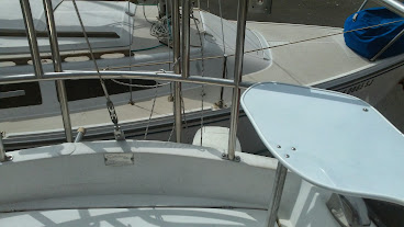

This is the best picture of the back stay I could find. It shows how the orignal split stay was rearranged to a single stay. No additional parts or cost.
jrowan
Mar 5, 2011
1,294
Sure, no additional parts or costs to "modify" the split back stay. But that photo shows how that modification looks like crap, and will hurt performance & the value of the boat. The line & tackle back stay tensioner was only designed as a tensioning device. It was never designed to carry the full load of the back stay.
I also have a split back stay with the tensioner, & while it is a nuisance when seated at the helm, without the tensioner it is impossible to adjust the bask stay. The other issue is that I would not trust the 30 + year old rope line on that tensioner to carry the load of the back stay. I know that my line has been coiled on that tensioner for many years & is likely a bit dry rotted. I would at least replace the line on that tensioner as a precaution. If you are serious about modifying the back stay, I would just replace the whole stay & start from scratch. Most rigging should be replaced every decade or so for safety & reliability, not just hacked at & then hope for the best.
