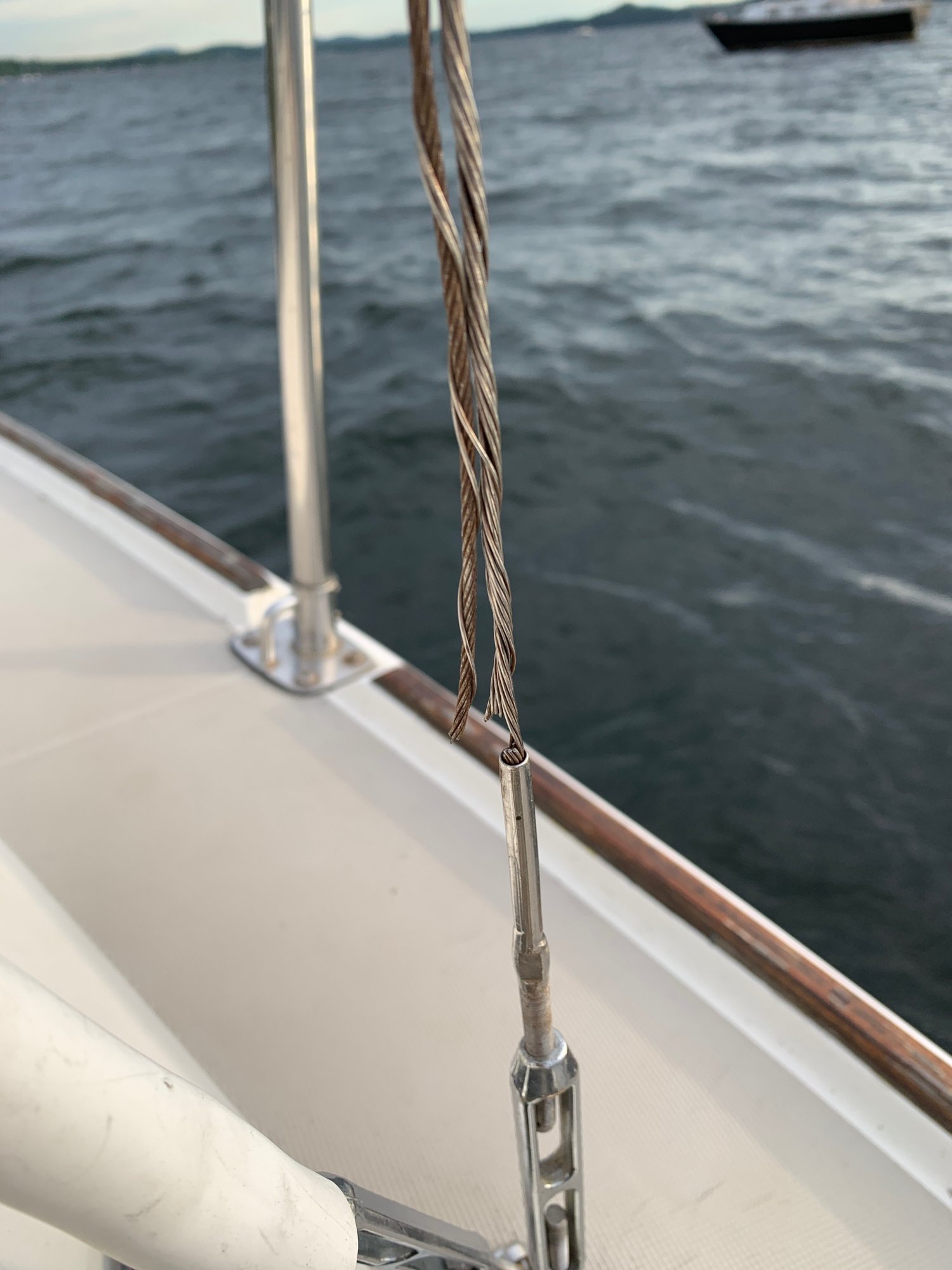

Got out to my boat last night to find one of the upper shrouds had basically split. I am trying to replace it as soon as I can so I can sail next week. I really don't want to take the boat out of the water. I've read a lot of people saying you can climb up the mast, but is the mast on my 19 foot O'day stable enough for that? Standing on the spreaders seems sketchy to me, but I am I wrong in thinking this? I'm pretty capable athletically speaking. I know I need to start by finding a shop in Vermont that I can buy a new shroud from and have them cut it to the right length. Anyone have advice?

Since the shrouds hold the mast up, I would recommend against climbing the mast. You don't want it coming down while you are up top.
On your boat, I'm guessing you could lower the mast in the slip, the shroud can then be removed, replaced and reconnected to the spreaders at your leisure without danger of damage to you, your boat or any nearby boats.
Just my recommendation, Climbing masts is less about athletic ability and more about being safe.

You are very close to losing the mast as it is..... a strong gust of wind is enough to snap what's left of the wire. So.... right now... not later, not tomorrow... but right this minute.. high tail it down to your boat and clip the main halyard to a stanchion base to back up the broken shroud..... Don't wait till after dinner.... go now!
I honestly could care less how you fix it.... dropping the mast makes the most sense.... but I can't emphasize enough, that you must get the mast secured ASAP! It could fail at any time which would violate your marina lease agreement, do damage to your boat or the one next to you, and quite possibly injure a real person. That would suck beyond all comprehension to have your crappy wire actually hurt someone because you can't decide how you want to fix it. Can you imagine living with that????? Can you imagine the lawsuit?????

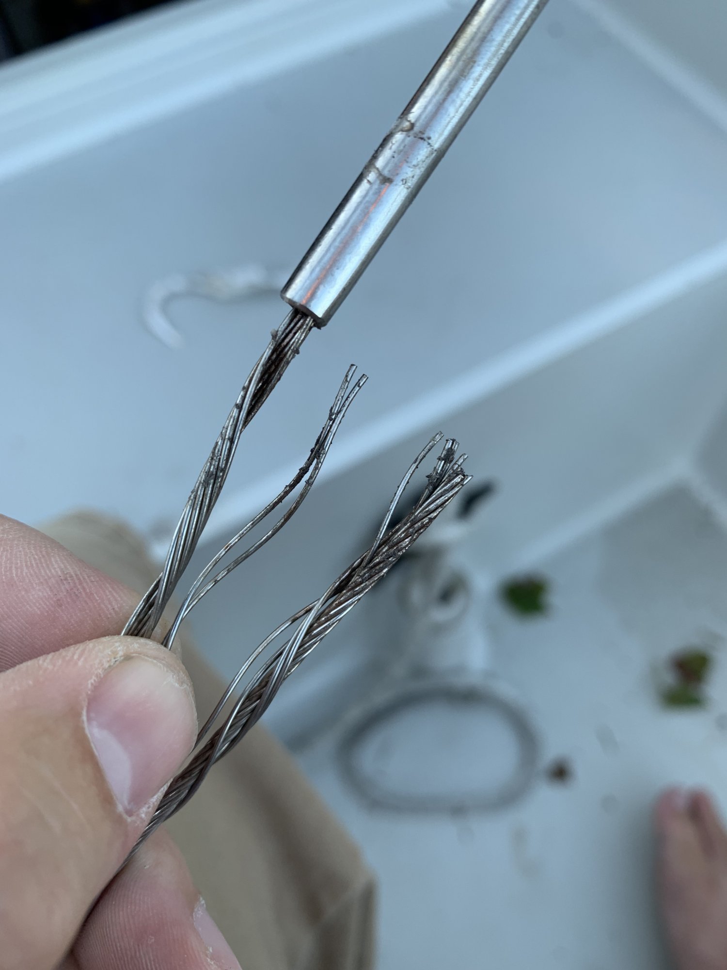

That’s amazing, with the center core completely broken off that it’s still holding.

There’s no reason to panic. Use a halyard to secure the mast while you figure out your options.

D&R Marine has the shroud you need and they ship fast. I just had a lower on my 192 do the same thing and they were able to get me a new one ASAP.
As for replacing the wire, do you have the Z Spar or Dwyer setup? Since the Z Spar uses hook terminals I was able to unhook the lower shroud with a boathook and a rope loop and put the new one in with some butyl tape on a boathook.
Dropping the mast is a pain but it’s quick. It’ll be better to drop the mast yourself than letting gravity and Mother Nature drop it for you when that shroud let’s go.

I'm a bit puzzled that folks who found one shroud in that condition would not immediately decide that all of the standing rigging should be replaced. Is it just me?
