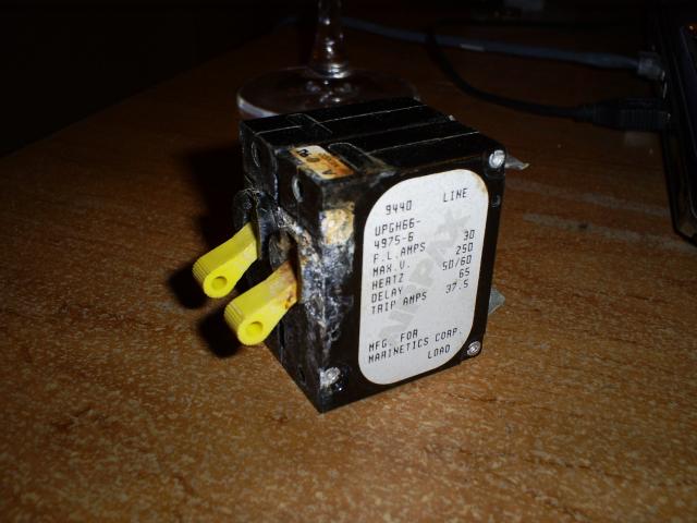

I believe it got a little water in it from a leaky port. But it worked for a while. Now one side will stay in the on position, while the other will not stay in the on position. It is original equipment Catalina circa 1979. BTW there was a pole connecting the two arms together but I had to take it off to uninstall it. I am looking at this one. http://www.defender.com/product.jsp?path=-1|328|296553|299262|825435&id=673281
I was wondering if marine circuit breakers are universal fit. Or is it like residential breakers, SquareD only fits squareD, Ge for Ge...etc..?

They're pretty universal on a boat...

In the interest of saving your hide for another day, make certain that the link between the breaker handles is kept in place. It is there to interrupt both sides of the power supply if one side trips it drags the other side along.

Ross-I will make sure to have the bar in place when I install the new one.
