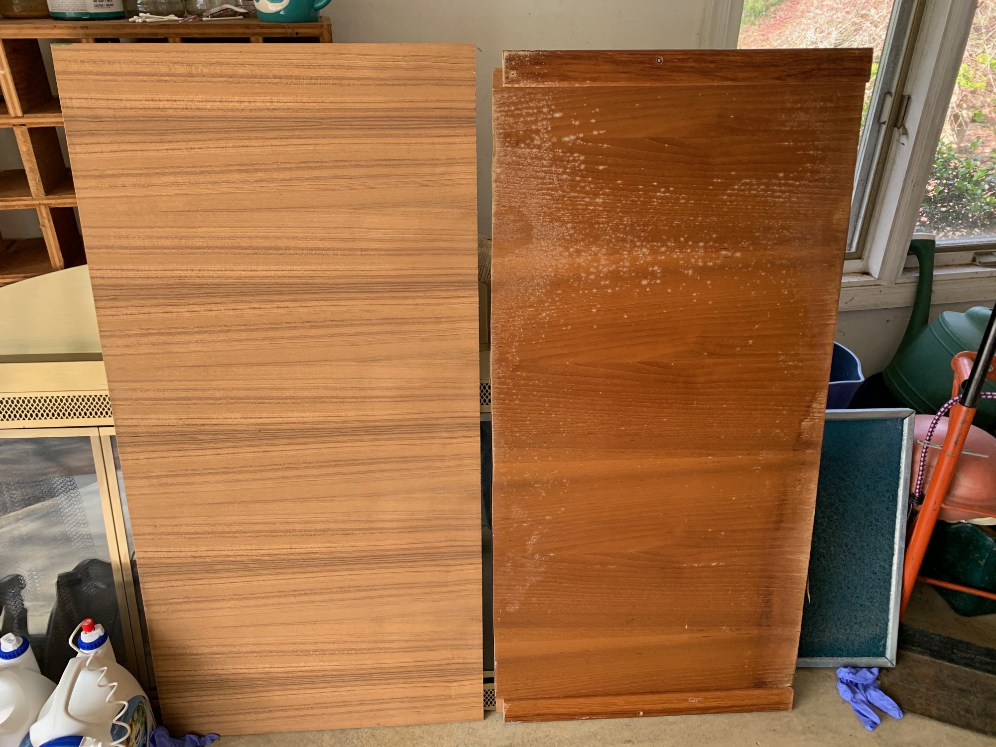

Next on my list of pandemic projects: replacing the bulkhead (removable panel, really) in the aft cabin of our Hunter 306. This is the 2' x 4' panel which is removed to access all the cr$^*%#p in the stern: holding tank, fuel tank, macerator, wiring spaghetti. It's only held on with 2 screws. But the bottom edge has totally delaminated from sitting in seepage from the rear hull/deck joint.
Anyway, I bought a 2'x4' piece of 1/2" teak faced marine plywood and a couple of strips of teak for the trim on each side which keeps it even with the permanently mounted plywood on the left and right sides. Here's the new (unfinished) and old panels:
Cutting it to match and adding the trim strips will be fairly easy, but I'm unsure of how to finish it, other than the fact that I will certainly seal all the edges and the back side with some sort of polyurethane. I was thinking of maybe just using teak oil on the finished side, but this might be a bad idea. Leaning towards Minwax Helmsman Spar Urethane. I can't see the point of staining it, as it will be darker naturally when sealed, and frankly, you can barely see the panel: it's at the stern of a very dark and cave-like aft cabin, in which we sleep from side to side. Suggestions welcome.

Take a scrap piece and try different solutions, pick the one you like best.
Finishes that seal the wood and provide a smooth surface are easier to keep clean and less friendly to mold and mildew.

I would opt for penetrating epoxy on both sides (2 coats on the edges and backside)
Vs. urethane. It costs about the same, you'll still see a wood finish on the inside,
and you won't have to worry about the finish chipping when it's
removed/knocked around/reinstalled.
Oh Yeah, and what Seadaddler said!
What brand/type of penetrating epoxy are you talking about, please?

I replaced the main cabin bulkheads with the same material. I used Watco oil in cherry flavor, blends right in with the old teak.

Regular two part epoxy works as well.
There is nothing terribly exotic about penetrating epoxy. Regular epoxy will work. There are 2 tricks to making it work well.
1. Warm the wood. This will expel a lot of air locked in the wood and as the wood cools it will suck the epoxy into its structure. By warm, I mean around 100°F. Check the West System website, I'm pretty sure they have more information on this.
2. Warm the Expoxy. Not hot, just enough to make it thinner. Set the epoxy in a hot water bath and use the slow hardener. You will have to work faster because the cure time will be shorter.
