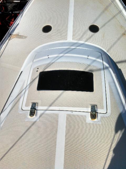

Anybody know how to replace crazed lens in this original 1981 O'Day 28 hatch?

Yes. The hatch on the '81 28' oday has the lens fixed from below without a frame. It's original and very crazed but I'm thinking that it was never possible to stand on it because of the design. O'day bought hatches in later years but mine is molded by oday. Will try to remove hatch lens and install new lens with 795 but not sure how to get old one out cleanly? Also, should I use acrylic or polycarbonate? I found some polycarbonate that has special UV treatment.
First off
I would find someone dumb enough to stand on it as see if it holds up. I think you will find if holds up fine .
Then I would remove the hinges so you can take it home and work on it. Maybe buy new hinges.
Then cut the seal with a knife push pull until it starts coming up.
I think you need butyl tape or the foam tape plus the Dow 795.
I think you may find that the area of the lens that is caulked has been painted black. It gives it a nice finished look (again just copy what was done before)
Clamping. Now that it is off the boat, this will be easy. Just a few pounds should be enough to hold it in place.
