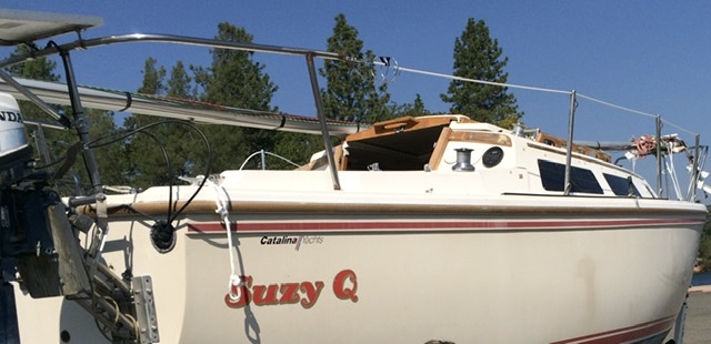

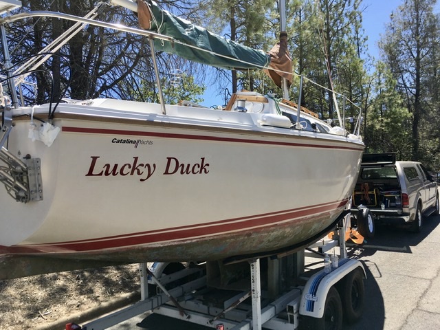

We used a heat gun to get the bulk of the old name that had been on for 30 years. It got much of it, then the 3M eraser got the rest. We used Meguire’s finishing compound and 3M Wax and Restorer after that. Pretty much got rid of the ghosting.

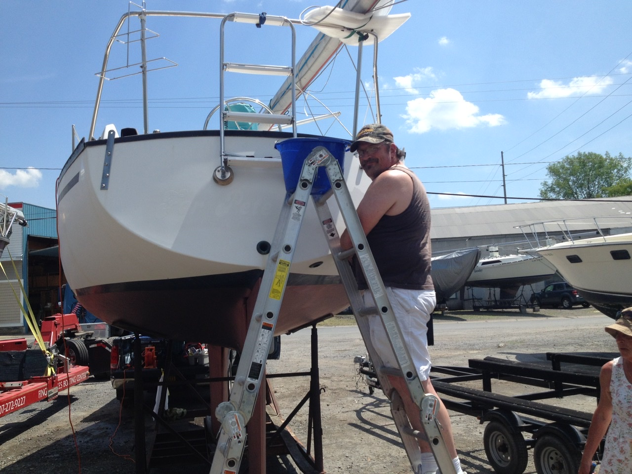

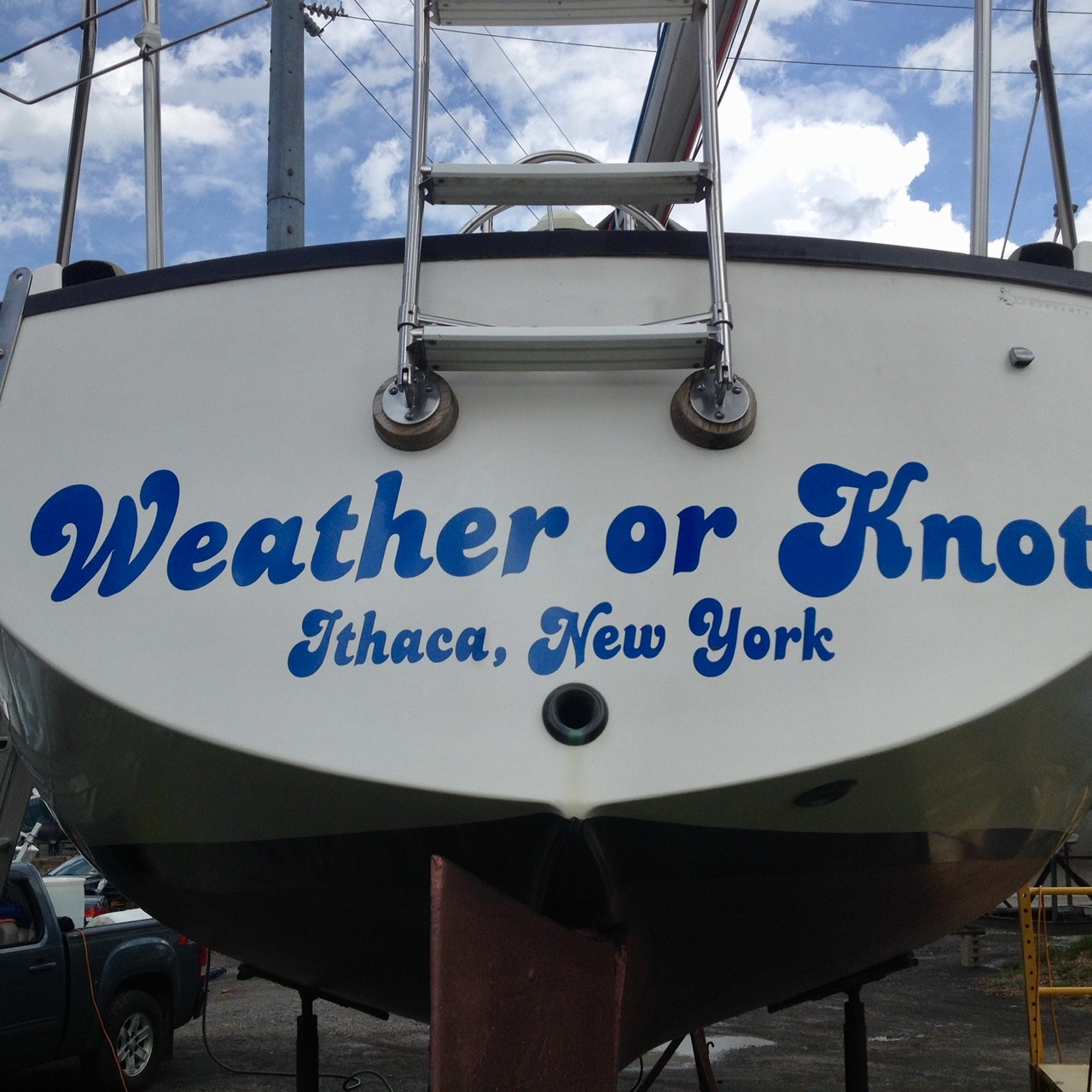

LAZY? Yep, that’s me too! I decided to hire my unemployed, body working, Brother-in Law! His choice was careful razor blading and compounding with a marine grade Meguiars cutting agent and finish with a Mr. Clean Scrubbing Sponge. The shadow left, but the lettering appeared embossed. After a few weeks in the suns the embossing went way. The boat was named “For Pete’s Sake”, now not so much. If you zoom on the picture you can see the embossing.

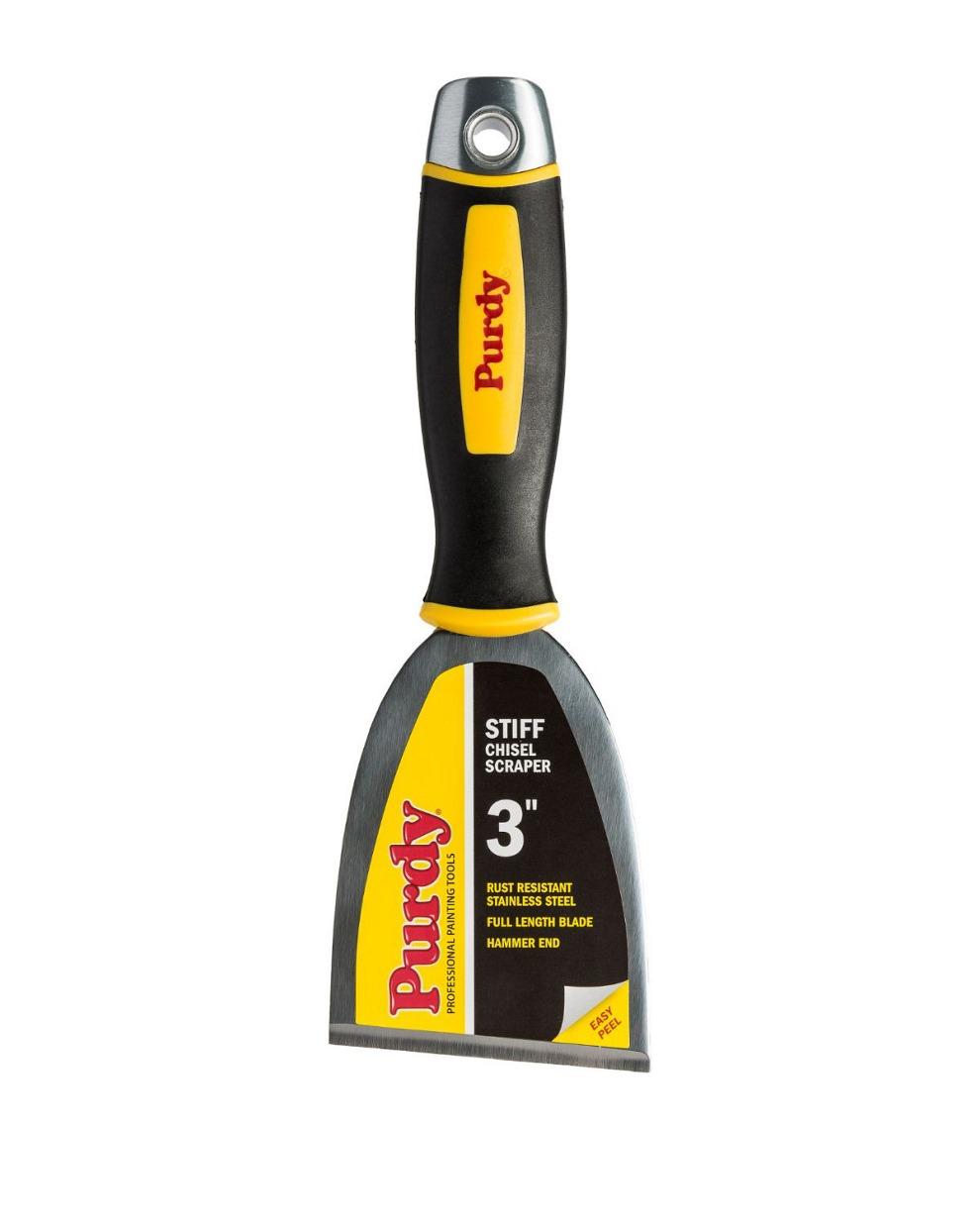

:plus: To use a Heat Gun and a paint scraper
