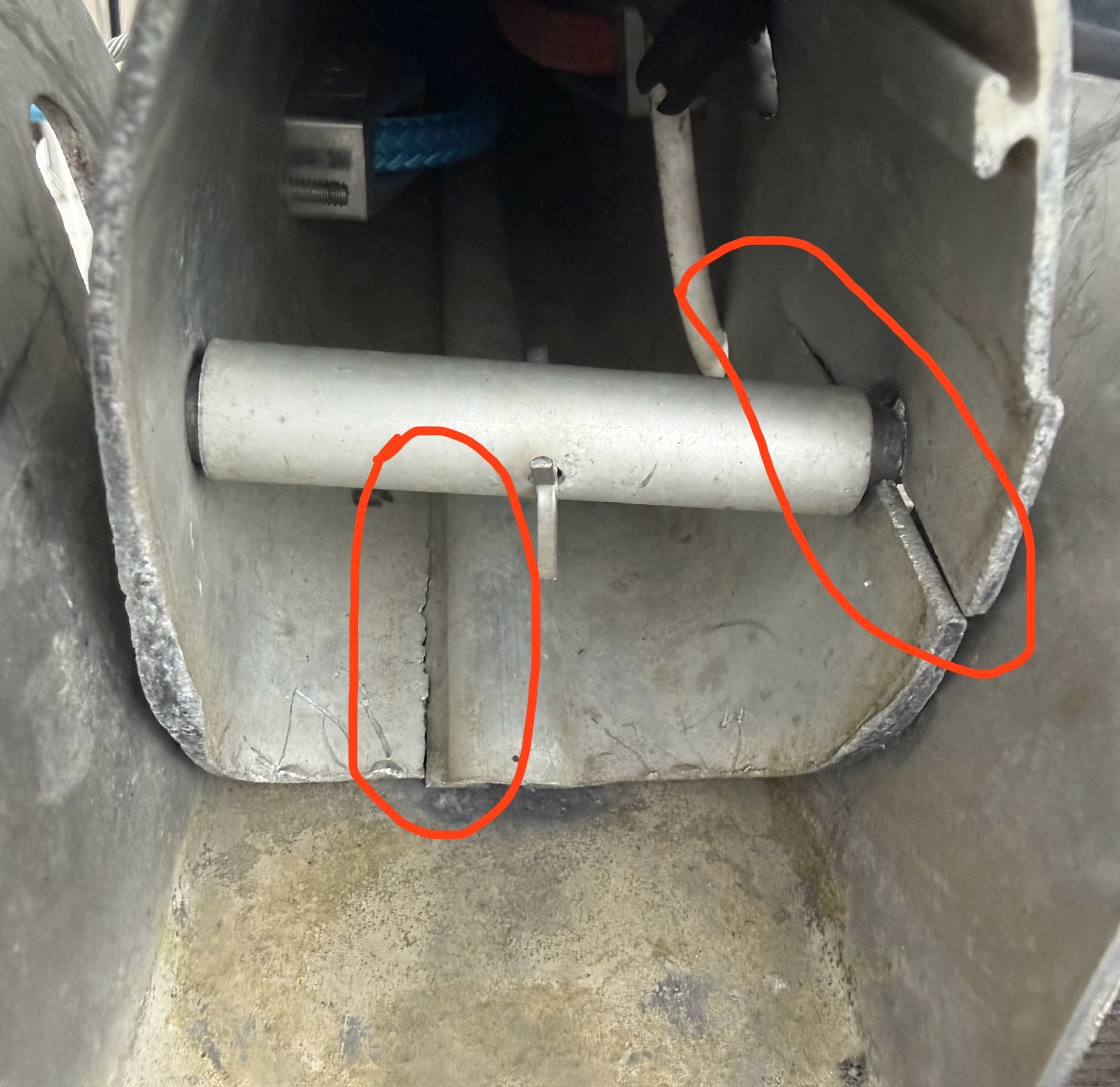

I have a Catalina 25 standard rig bought 5 years ago. The first time we raised the mast we dropped it when it was about half way up. Whoops! The mast itself got two cracks in the bottom few inches. I never got it fixed or even looked at, and have casually sailed since then. But on the really windy days I catch myself wondering how that crack is doing. I don’t think the cracks have changed much since it fell.

I’ve included some pictures of my broken mast.

Welding and reinforcing the mast at the base might be an option.

Weld the cracks, then consider welding a reinforcement band around the base. Good to go. If you don't like the layout of this boat, perhaps finding a different boat makes more sense. Once you alter this boat beyond recognition, you lose its resale value.

I'd be nervous that it'd split more raising the mast. Moving all the rigging over will be a large project. I'd find a good fabricator to fix it.

Those cracks are mostly a concern during mast raising. When set, the forces are primarily downward on those cracks. Weld and reinforce, like @Joe suggests. If you change your mast, you'll need all new standing rigging and probably new running rigging, as well as new sails. Your boat's ballast was designed for that boat. The cable sizes were selected for that sail plan.
It appears the Catalina Tall Rig had the same 1900lbs ballast as the regular rig. By the accounts I've read, the tall rig is more tender, heeled much easier (makes sense). I wouldn't keep pushing on that.
Your mast foot is repairable. I've never been to Alaska, but I would guess, like my own isolated area of northern New Hampshire, there's no shortage of custom fabrication shops of all kinds. People are use to fixing and making due in places like these.

I agree with the "Weld the Cracks" suggestions. A new mast is not needed for those cracks. Further use in the current condition will cause further cracking, and the base of the mast is likely to fail. A good aluminum welder can inspect the metal and tell you if the surrounding metal is sound. You can also approach the problem by welding a sleeve over the cracked section.
