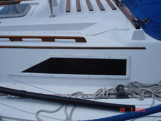

I have a 1985 Hunter 31 and need to replace the outside trim on the larger rectangular window on my starboard side. Does anyone know where I might find this replacement part?

Do you mean the frame of the window or the ribber "weatherstripping"? I posted an article in the modifications section on removing and refurbing the fixed ports on my H34 which has similar windows altho mine were aluminum frames

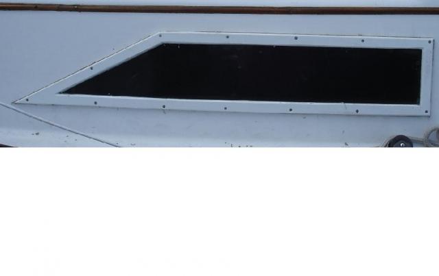

Make your own out of some Starboard which is what I ended up doing. I used the old broken ones to make a plywood template, cut the outside and inside form on the table saw then routed out the step for the thickness of the window. I can post pics if you wish

TR-6 I would like to see pictures of your frames and how you made them .. The ones on my boat actually hold the window plexi against the butyl tape that seals the system.. Mine are getting really brittle .. I talked to the Bomon guys and they can make newframed windows that will fit into the later holes but they are very expensive..

Definitely the "ribber", or weatherstripping, which appears to be plastic. When I visit my boat this weekend, I'll take some pictures.

A quick photo of the trims I made. Materials is 1/2" thick starboard. If you need anything else let me know
10,194
TR-6 Those are fine looking !! What does the back side look like?? The relief for the window, a simple step?
