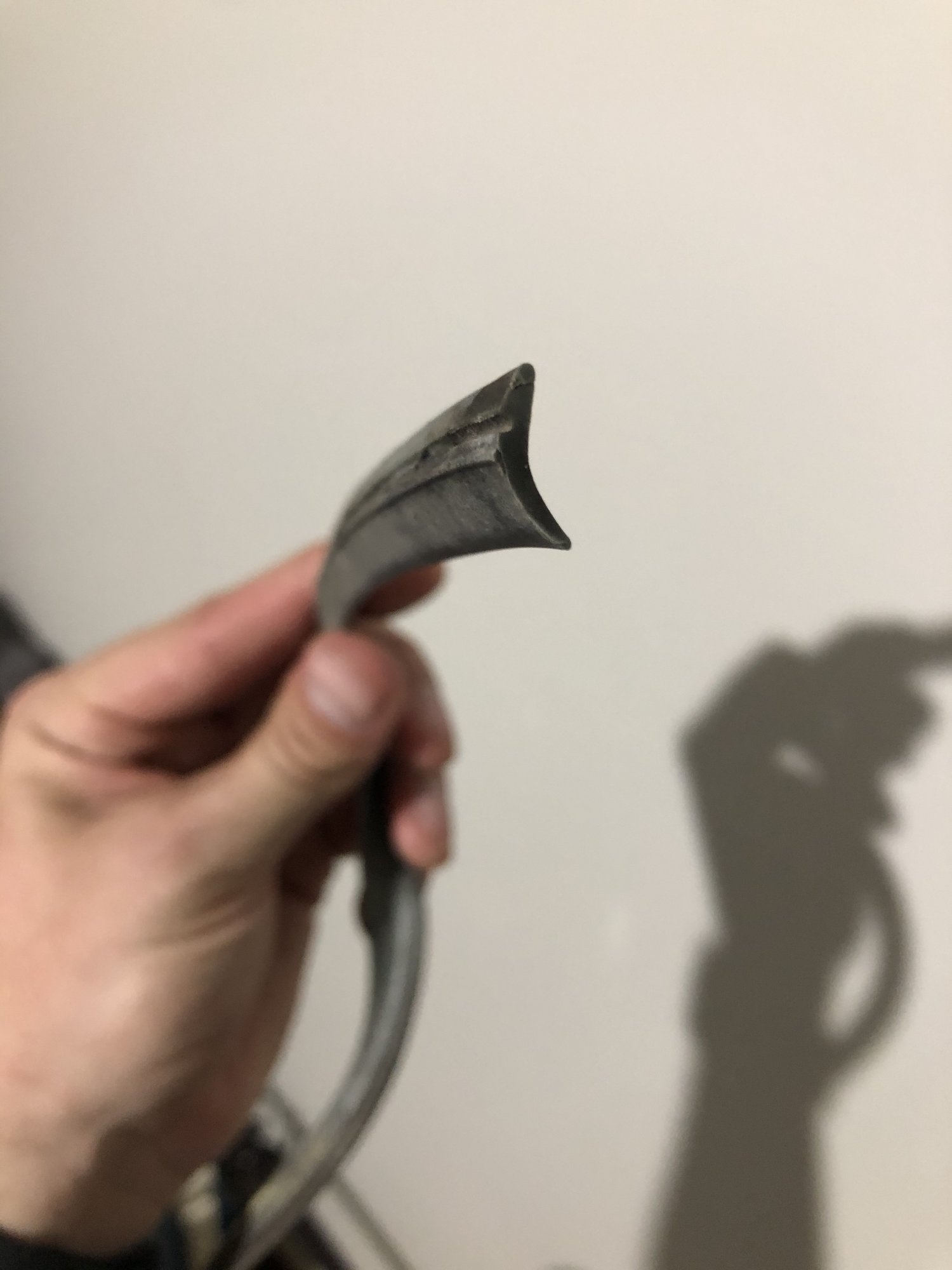

New here so let me know if this has already been answered. I’m replacing the windows on my c and c 24 and I’m having trouble finding the outside replacement seals for the aluminum frame (Glazing?) Does anyone know where I might be able to find them?

Taco Marine has a variety of vinyl seal material. I would check out their website.
Go to a local Ships Chandler or boat yard near you and ask to see samples. They often have a box or ring of sample material that you can try and match to your aged piece.
I lucked out and found a Canadian company that makes a product which turned out to be unique to my boat portals, by observing a similar window at a boat show. Look for similar ports on new boats that use a similar seal then call the manufacture.

I found some for my C&C 27 at a hardware store that they used when reglazing storm door windows. Worked perfectly. I also found that drilling a couple of small drain holes on the outside of the aluminum window frame stopped all leaking.
