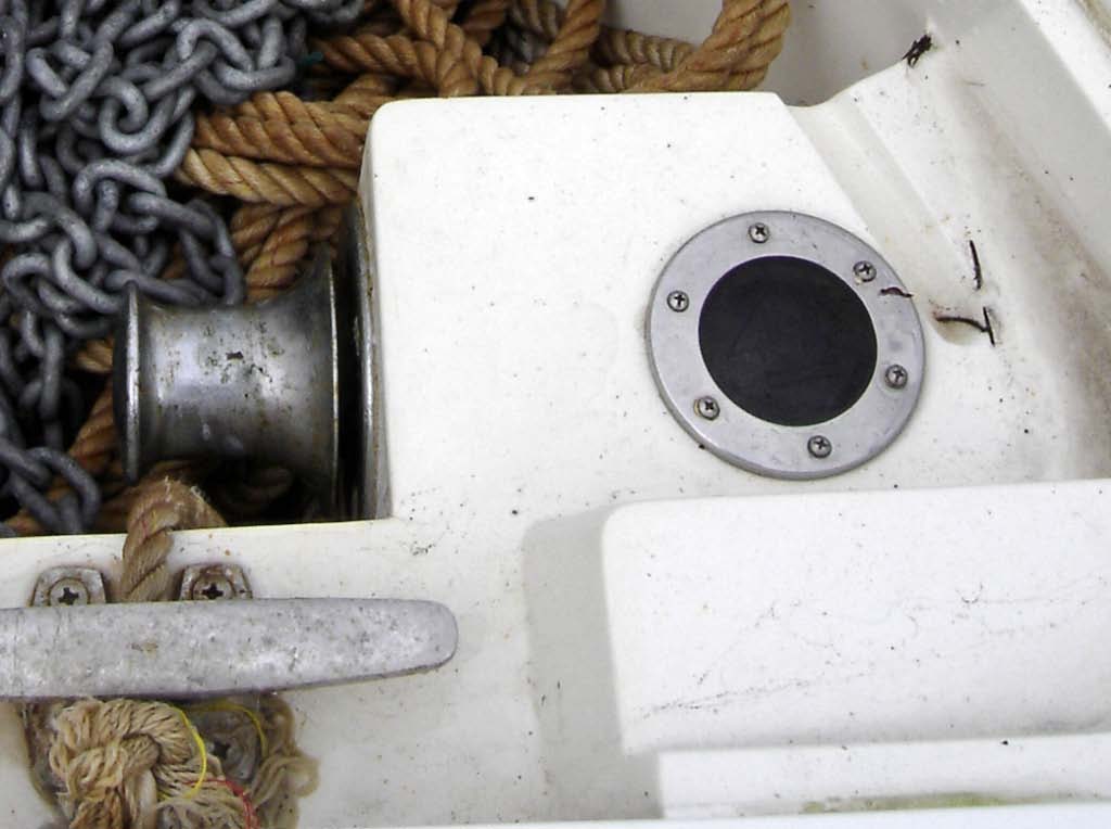

Here is what Catalina mounted in the C30 MkII. I think they also used it in the 34 & maybe the 36 as well. I believe it is a vertical windlass mounted horizontally

I am going to sound really dumb. But do you just wrap the chain around the drum to get it to pull up the anchor chain?
What does the inside of the boat look like and how do you access the motor?

I currently have a 35# CQR with about 30' of 5/16" chain and 250' of 1/2" rode. I usually use the windlass up to the chain/rode splice and then hand haul it the last 30' but you can use the capstan to haul the chain as well. with 3 turns it does not slip much if you keep some tension on it. For mounting there is an access port at the foot of the V-birth to get to the motor.
