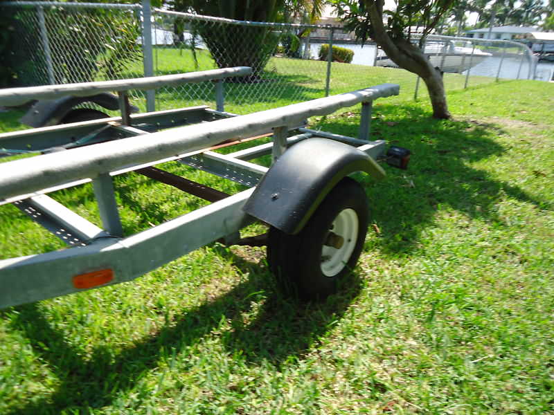

The NEW (used) trailer frame is narrower and will be 48' wide. With the beam at 84" I am concerned about proper load and balance. The OLD FRAME is 60" wide, the NEW FRAME is 48" wide.
If I move the BUNK MOUNTS to the outside of the frame (over the wheel guards) what is the recommended MINIMUM width for a BOAT and TRAILER where the BOAT is 84" wide and the NEW trailer with wheels is only 69" wide?
*The boat is going to be 15" wider than the trailer...is this safe?

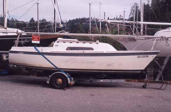

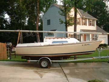

I've attached a few pictures of O'Day 20 trailers for comparison.
