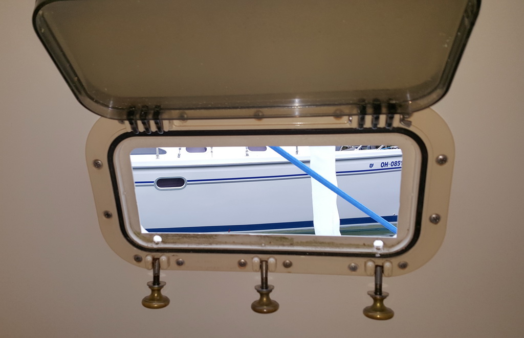

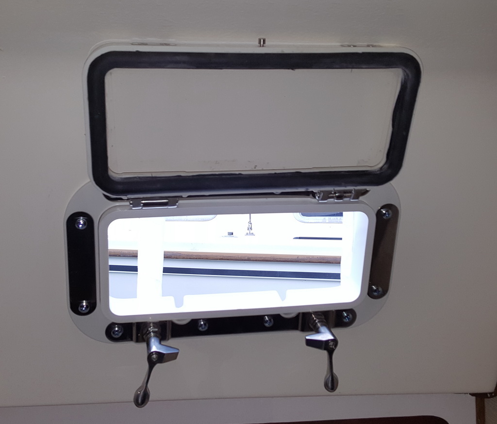

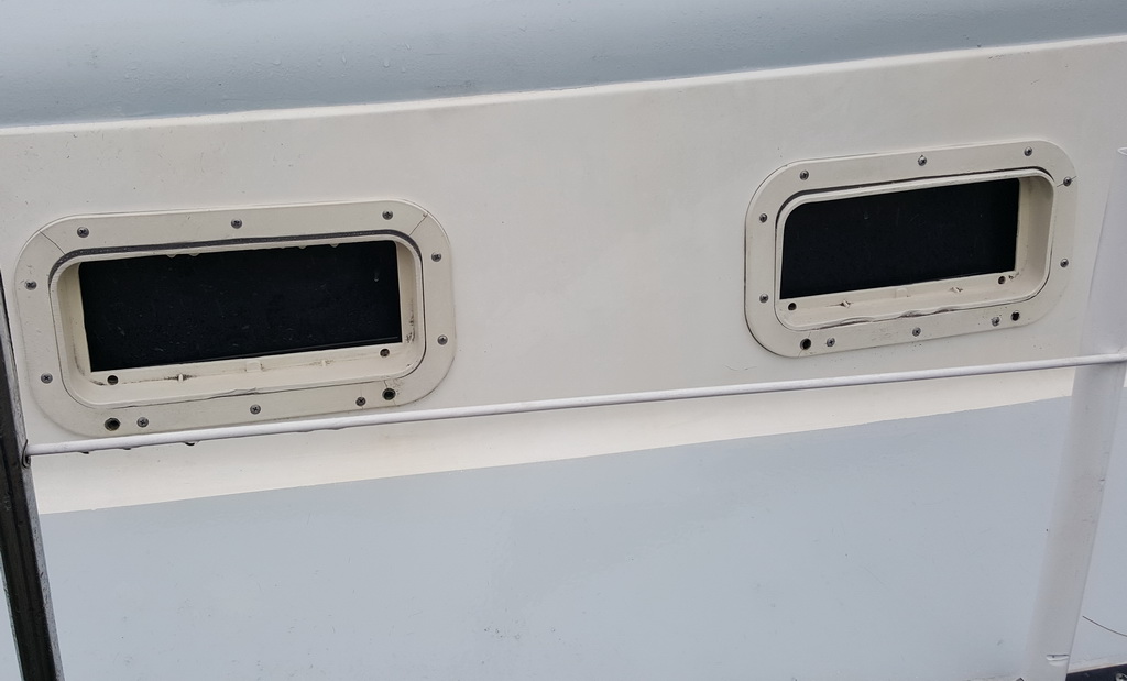

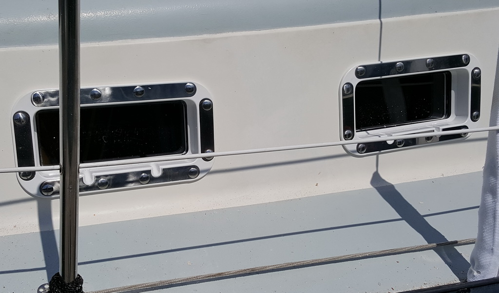

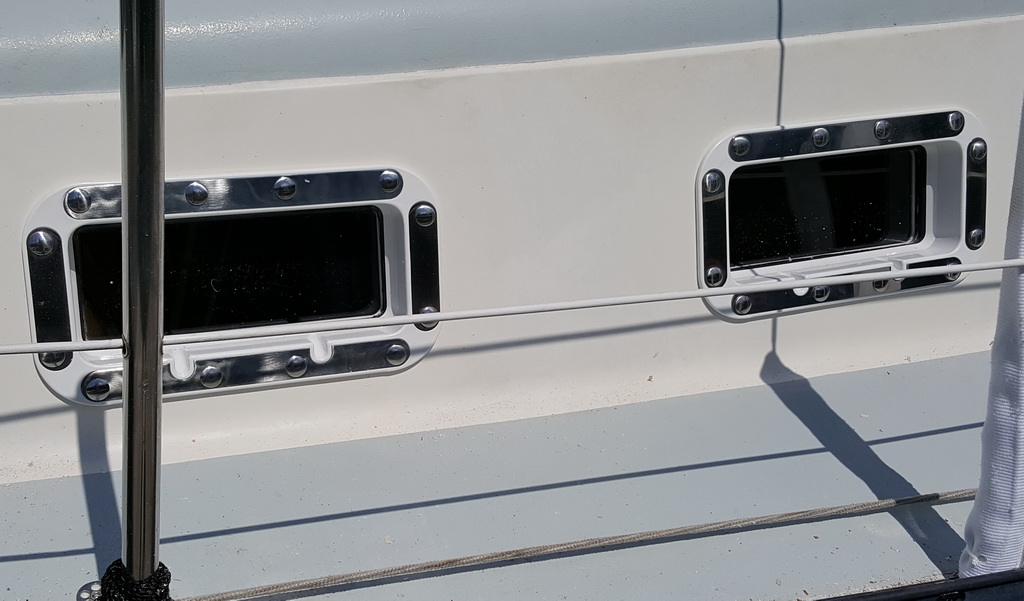

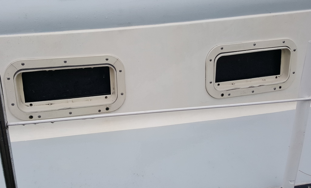

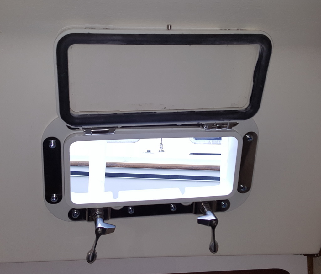

Absolutely recommended! Installed four of the NFM Tri-Matrix last summer on my 1979 Hunter 27 and absolutely love them. Like Johnb, recommend; rent the template, it assures a quality installation. You'll need a few clamps to secure the template. My cabin thickness was also variable, NFM sent plenty of screws in different lengths, I sent back the unused screws which they credited to my card. A bit of router experience is helpful. Here's a few before and after photos. So easy to open and close in a moment. No sealant, leaks are in the past.

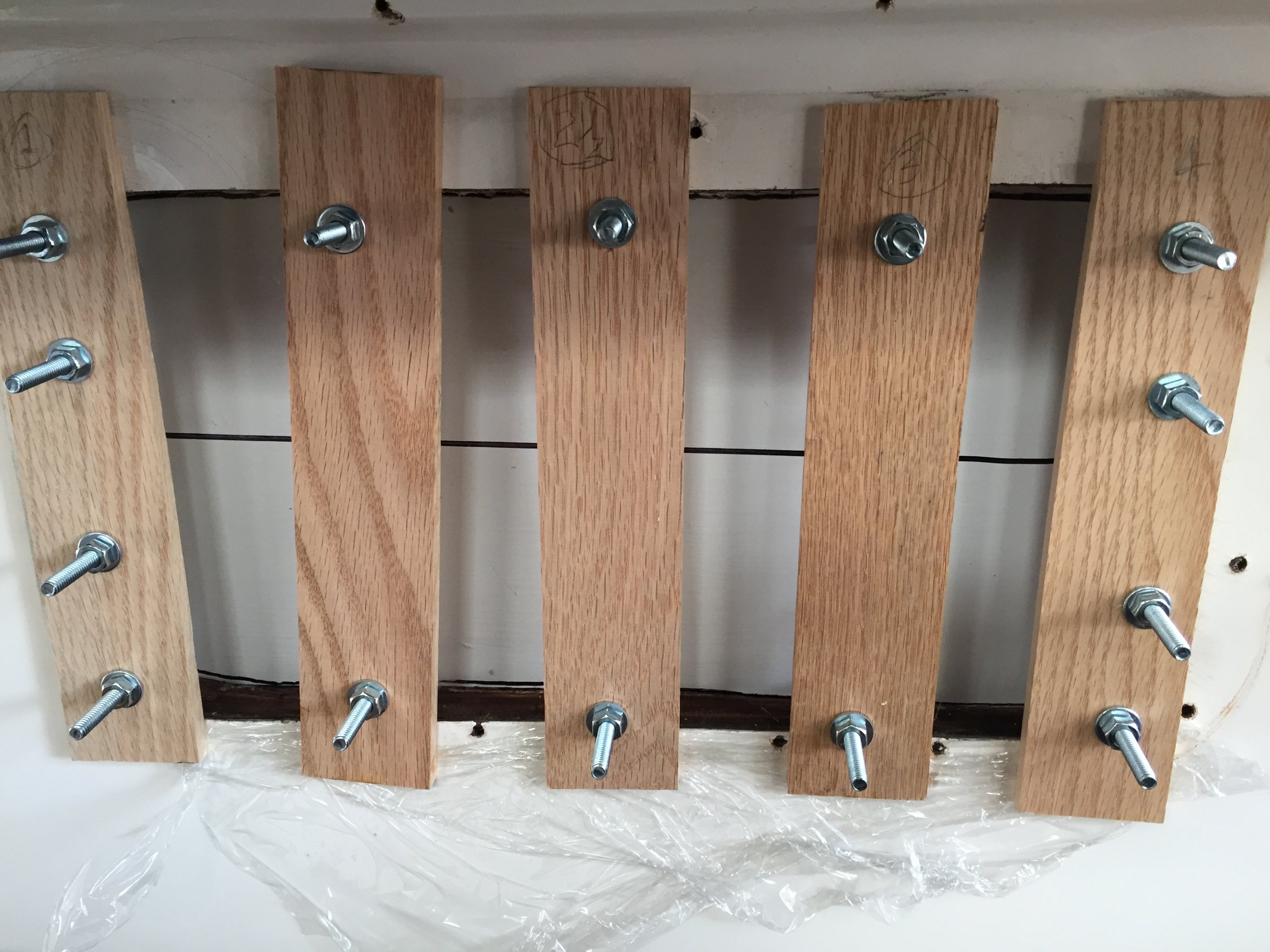

Since you are almost certain to not finish some (or all) in one day I suggest that you make up some blanks to go on the outside and be clamped in place as in the picture. This gives you time to dig out rotted core, dry out, fill in etc.
